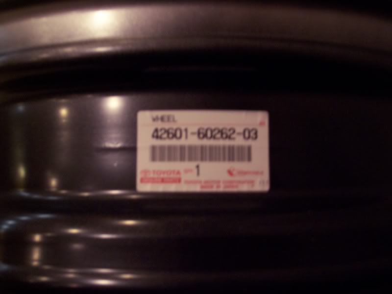

Thanks @Output Shaft - When I put in 1989 Land Cruiser on ToyotaPartsDeal it says it doesn't fit. Maybe that site is wrong?
42601-60262-03 - Genuine Toyota WHEEL, DISC
I bought a set of five for my '89 FJ62 axles - the axles and wheels are going on my '86 FJ60 project, along with BFG LT235/85R16 ATs and an OME heavy suspension from Cruiser Outfitters. Can't wait to get done and share some photos :).
OK, a photo:
Note - the 3FE, H55f, FJ62 transfer case, and OME suspension have not yet been installed, but it gives you general impression of how they'll look.
