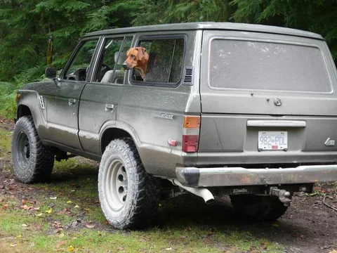

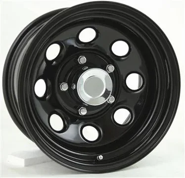

Here is one...my truck is at my frineds shop right now so unable to take any other pics at the present.
Unique 42-7760 16x7" rims, 3.75" backspace. I put them on my 60 and they clear the tie-rod ends by about almost 1/4" and the calipers by a bit less than 1/8" (eyeballed).
Elbert, what size tires are you running and what lift (if any)? That is pretty much exactly the look I am going for but wondering what it would look like at stock height? I am looking for an FJ60, in the Desert Beige and then adding an Isuzu 4BD1/2T in there and keeping everything as close to stock height as possible.
