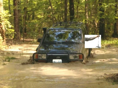

This idiot should know better than to stand between a tree and a moving vehicle.
I don't know about the idiot or what he knows, but I see brake lights so I'm gonna go with the belief that the truck was not moving - mostly because I really appreciated all the spotting from this idiot and X Factor and WFD175 - Thanks guys!

This is a different type of hoosier. I believe he was simply checking the turbidity of the water. (Note the secchi disk) Note there are no confederate flags on p/u's with chrome rollbars in the background.
