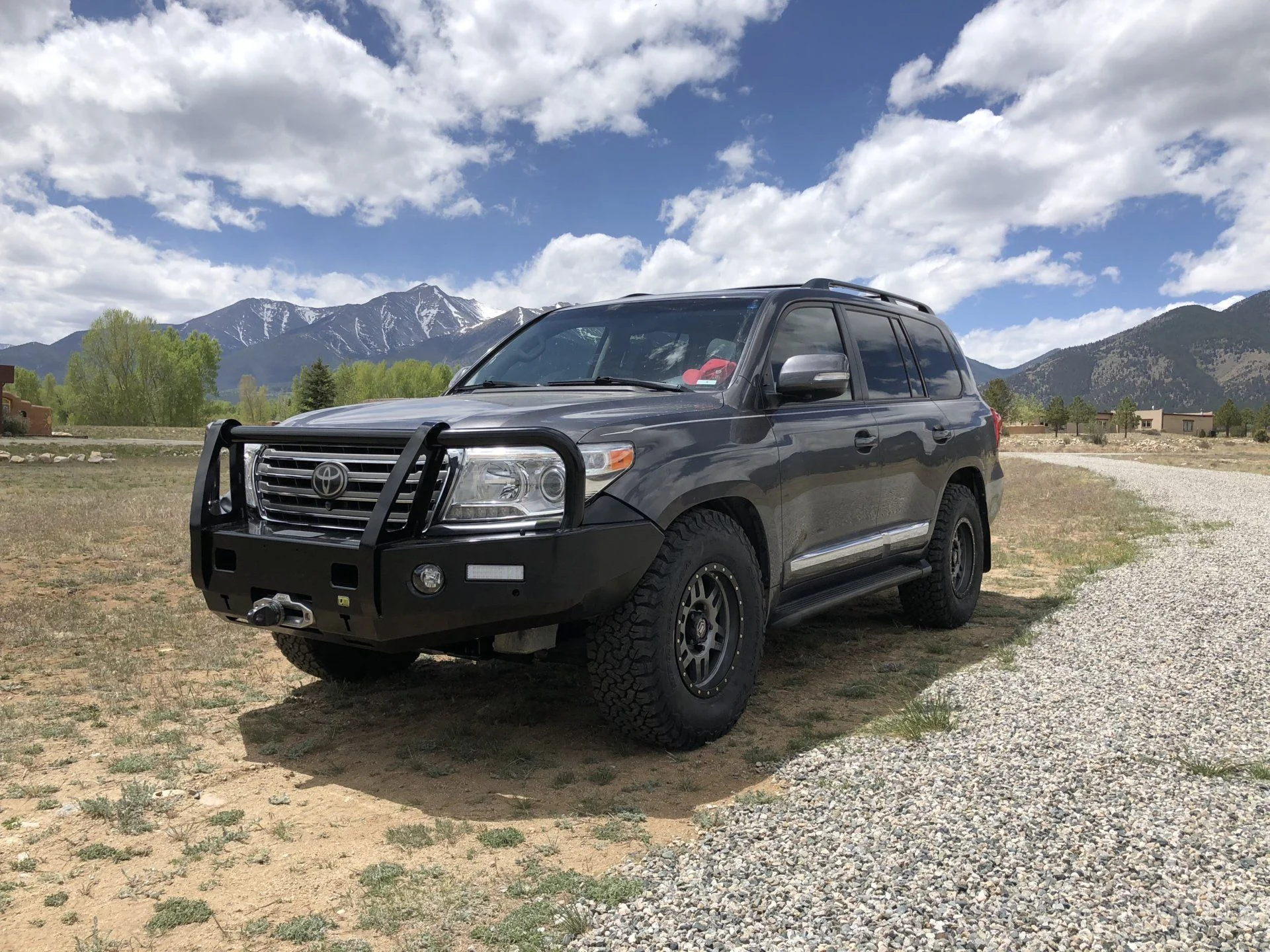

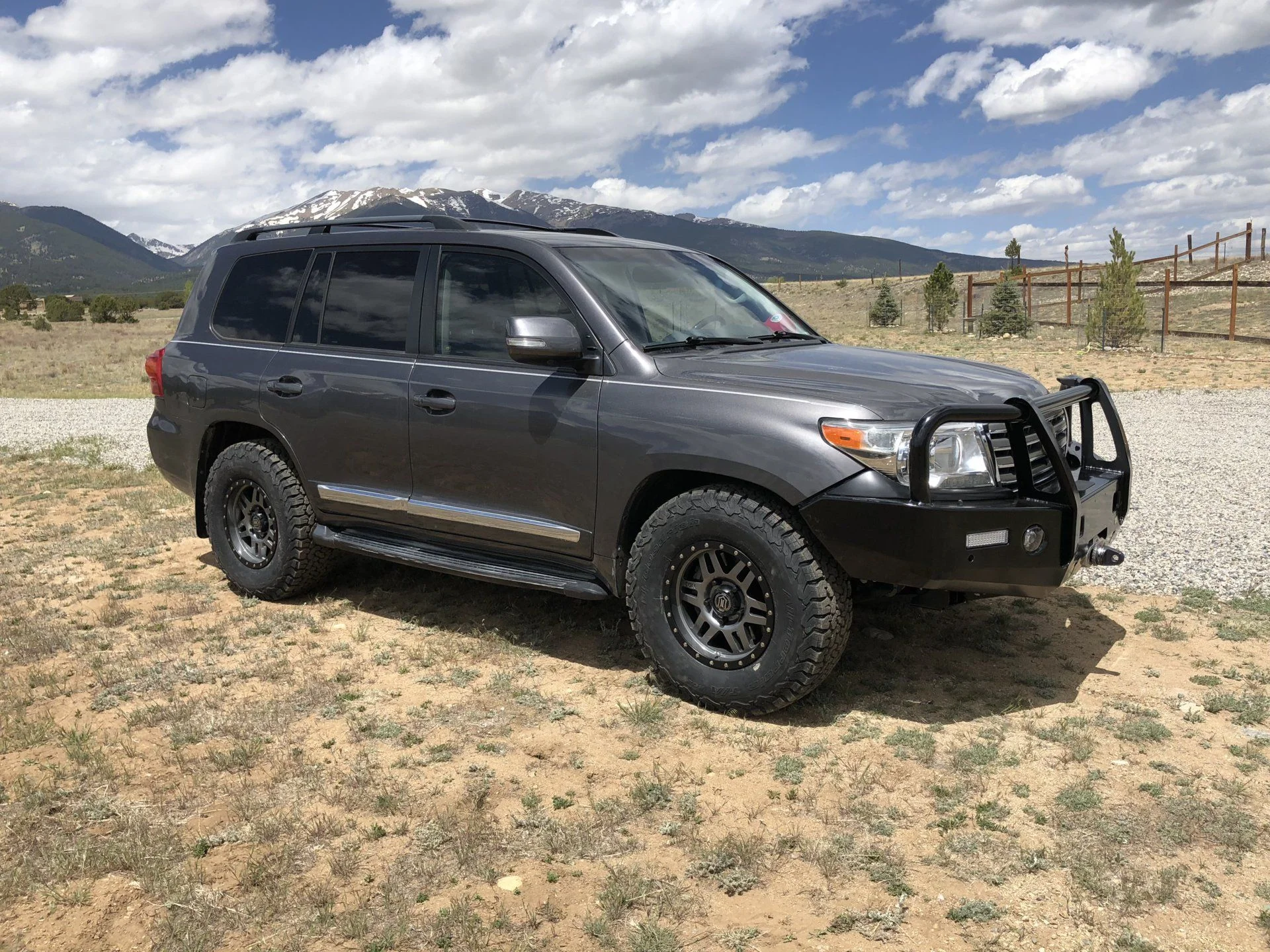

I just installed the Icon Six Speed Wheels on my '13 with 285/75r17 BFG KO2s. I do NOT have my lift installed yet, but did just install my TJM T13 front bumper. The TJM eliminated any rubbing in the front of the front tires and I only have minor rubbing in the rear of the front tires after removing the mud flap. So the smaller tires should have no issues!
Here are some pics.
@BVCOTaco any rubbing on the passenger-side sway bar? That's the one spot mine rub, enough so that I have to back off the wheel slightly on a full lock left turn. I can see where it's rubbing because that spot is shiny now
You can get rid of the one spot you're rubbing by hitting the metal bracket that's behind the plastic liner with a mallet a few times, or pull the plastic back and trim it with some shears. Even with the lift you'll likely have to deal with that spot as the lower offset causes minor rubbing there, unless you push your caster extremely positive past the Toyota spec.
@linuxgod I will have to crawl under and check. I am being careful not to turn at full lock right now until I get the lift. Then I will run it through its paces and figure out if any trimming is necessary. The BFG KO2's in 285/75R17 are supposed to be a little smaller than the Nitto RG's, so I am hopeful that there is minimal trimming.
FYI IIRC my measured height at 38psi front-to-back was 33.2". It's not the height that rubs the sway bar, it's the width I think. At full lock left, even creeping along, I can hear and feel the lugs on the tire rubbing. At full lock right, creeping along or doing a hard U-turn, I don't feel it but there's apparently a very slight rub on the KDSS arm based on the shininess.
