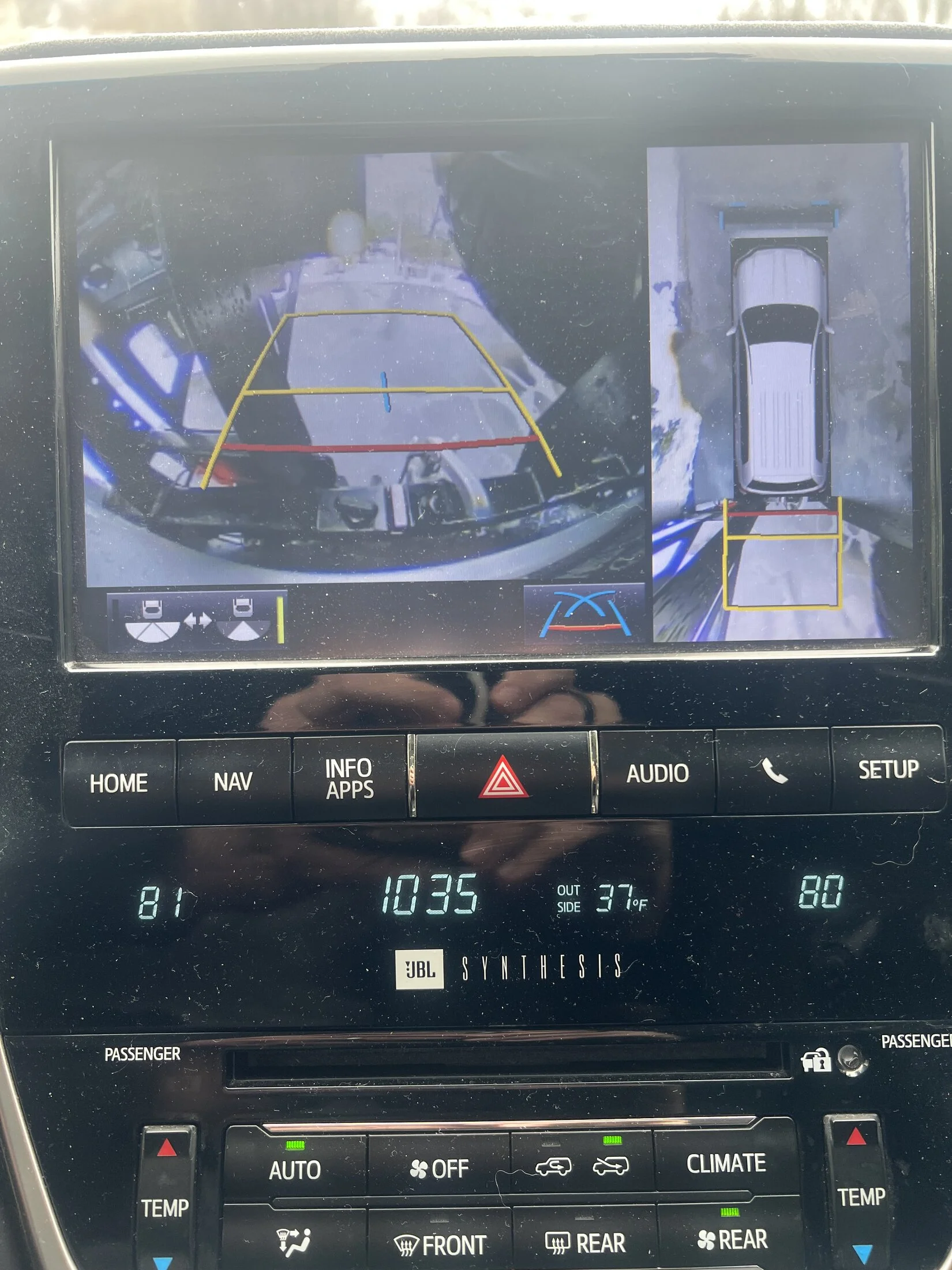

If you have one, could you post what the camera view looks like when in reverse?

Yep, probably be better without the Slee jerrycan holder attached. The parking sensors work good. Knock on wood, I have not backed up into any obstacles since installing 3-4 years ago and there have been plenty.
