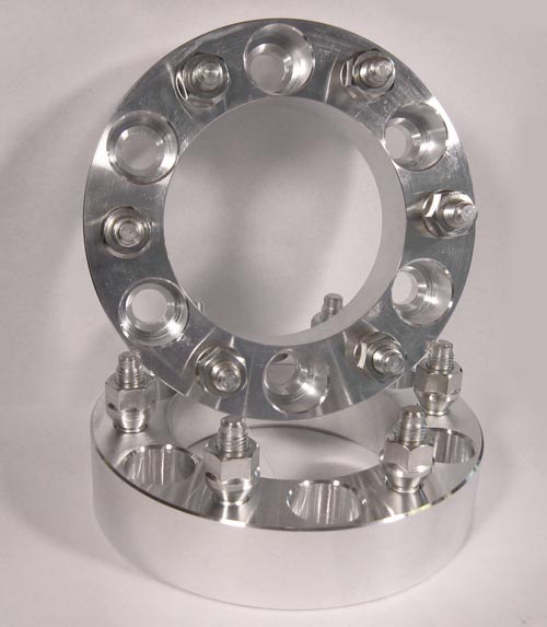

The wheels are only held on by the little aluminum ring, and the ring is only held on by the factory studs and lugs..............................
The weak link is where, if 4x4 is very important?
IOW, over-levrage the front and your over-leveraging the little aluminum ring.

Those one's

But, the way I amagine it is looking direcly down on it, sandwiched between the rim and hub, counter roatate the two...........
see what I mean, it's only aluminum and 1.5" at that.
NOTHING conects the "rim" to the "mounting surface" when that spacer is used it's not like using longer studs with a spacer, studs that pass through a spacer to the rim and then the lugnutz are used.
The only way they are going to "counter rotate" is if the lugs are loose.
So what you're saying is you have 3 times as much chance (with aluminum rims and a spacer) for a failure as you do with just aluminum rims? I say three because you have the stock lug nuts holding the spacer on, then you have both ends of the studs from the spacer to the alum rim......
And FYI I went out and looked at my rims, there is a lot of meat around the lug nuts, but a very small amount (less than 1/2 inch) actually under them between the nut and the hub. There is however a steel (I'm assuming) sleeve to spread the force out.....
The bottom line is there is little to no chance for failure if you keep everything tight.
