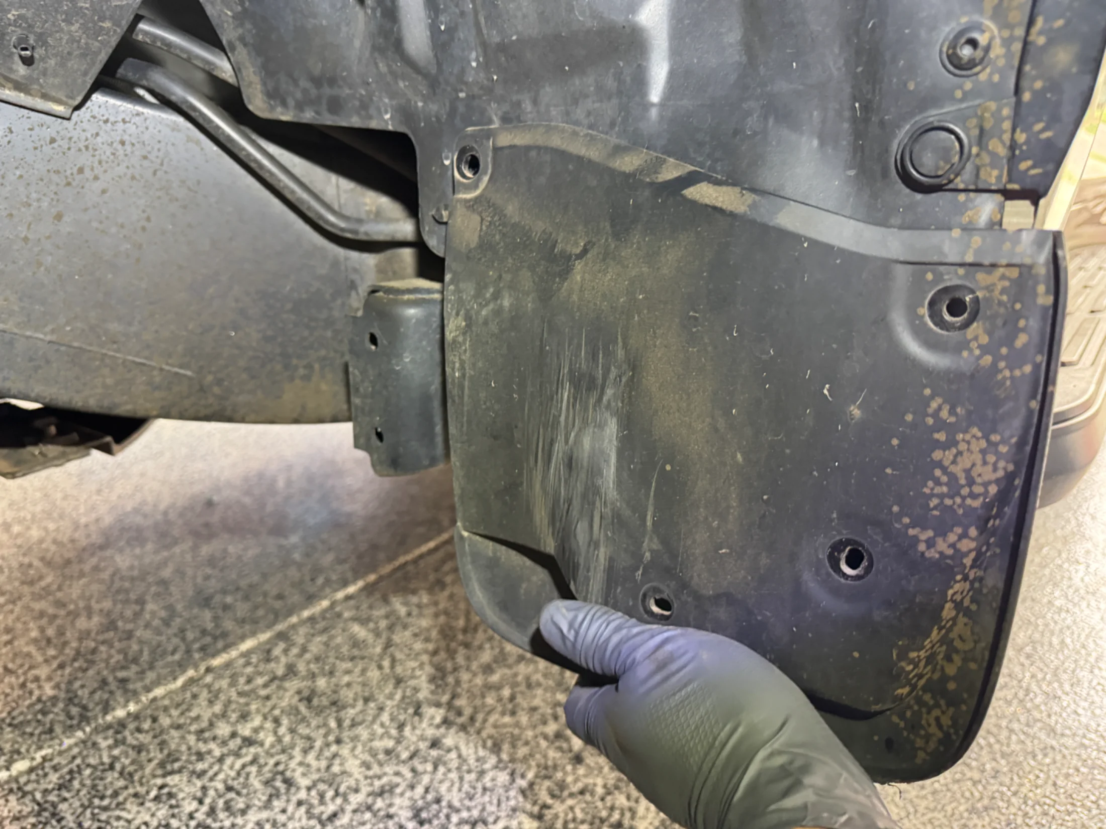

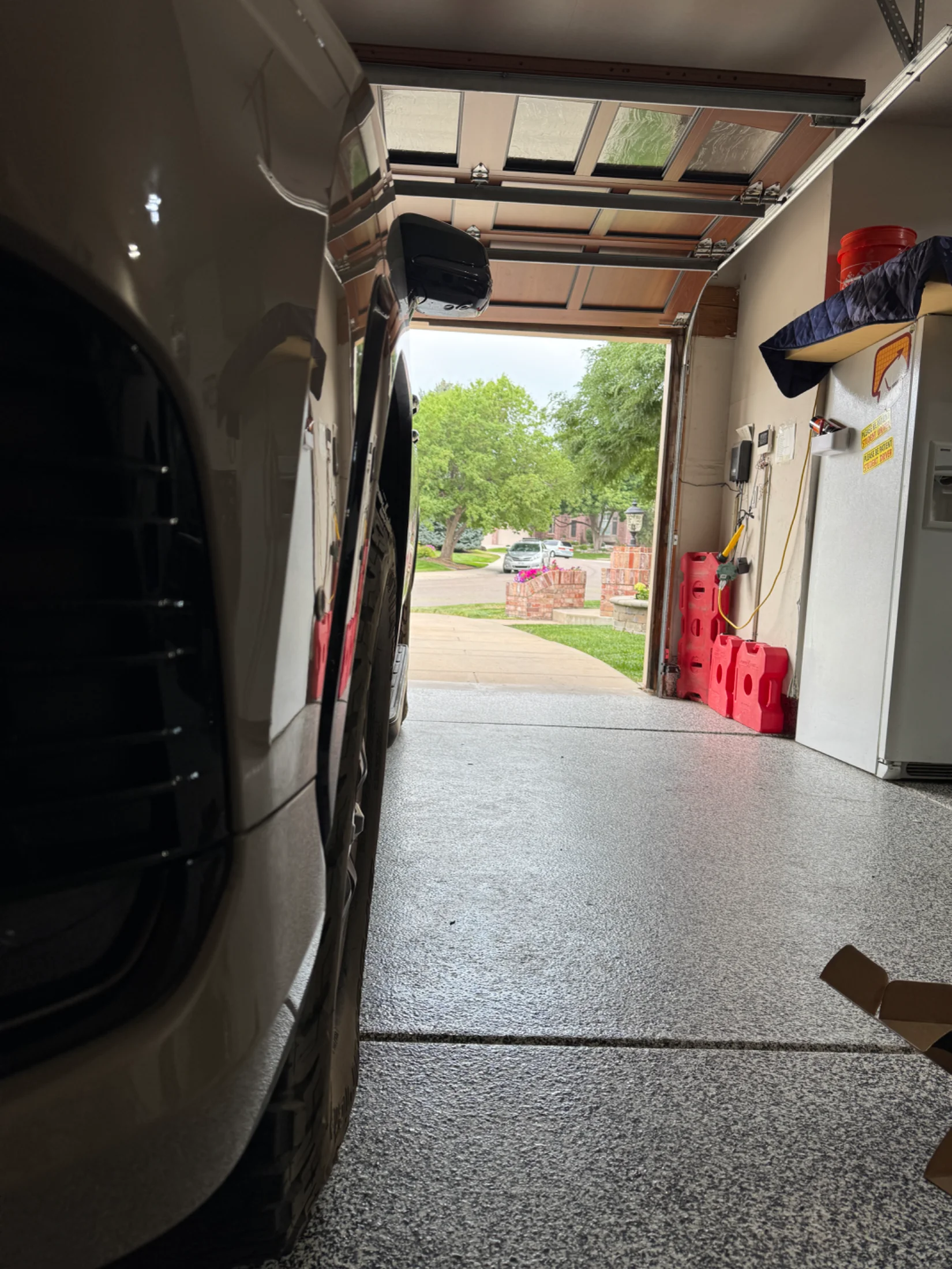

After running my 35 inch tires for a while, I decided to put on wheel spacers.

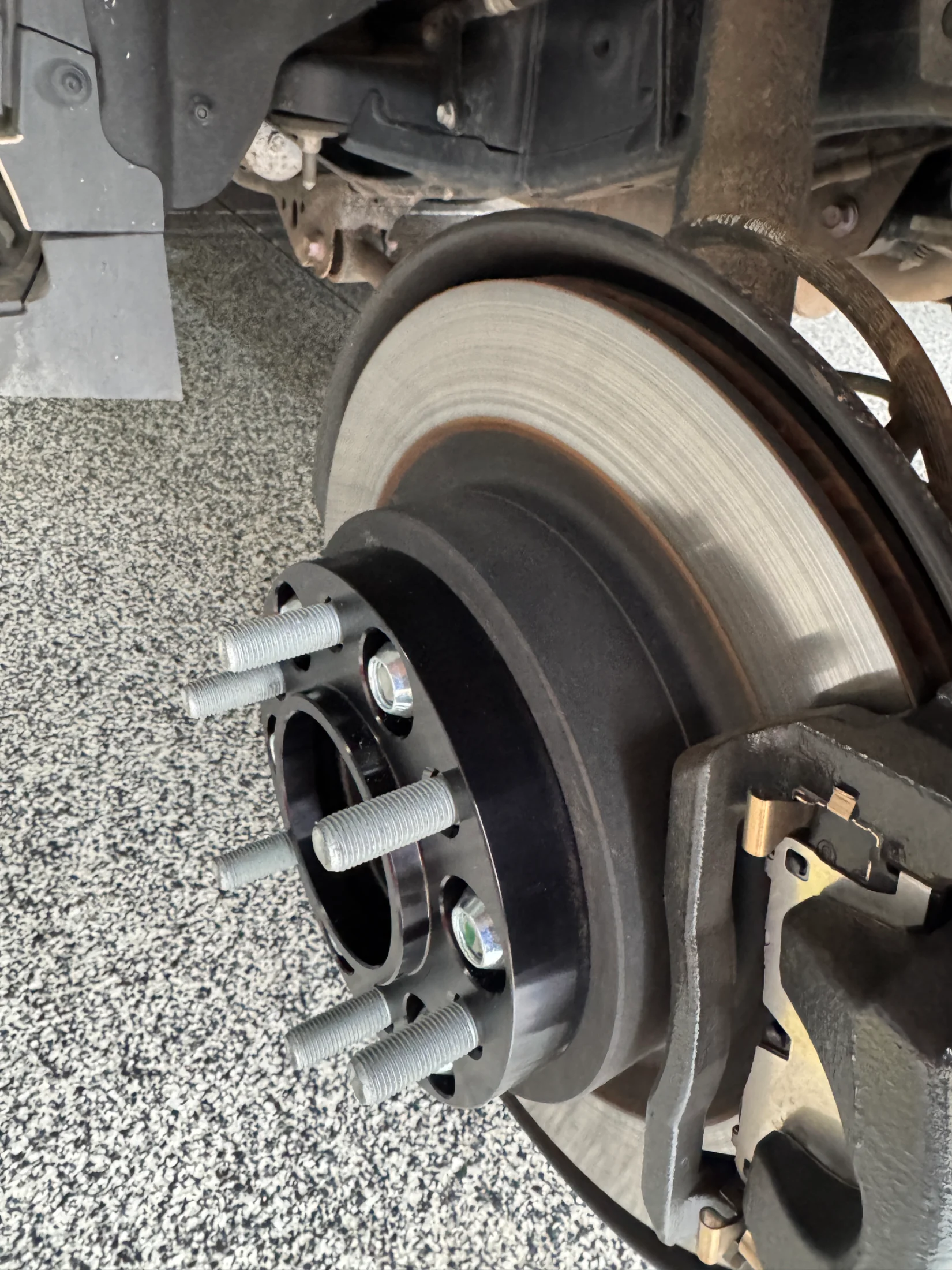

I previously ran spiderTrax wheel spacers on my 200 series, and for three years and a ton of trails I never had an issue.
**edited** The 1" wheel spacers ultimately led to more rubbing, requiring more trimming... the vicious cycle of 35s.

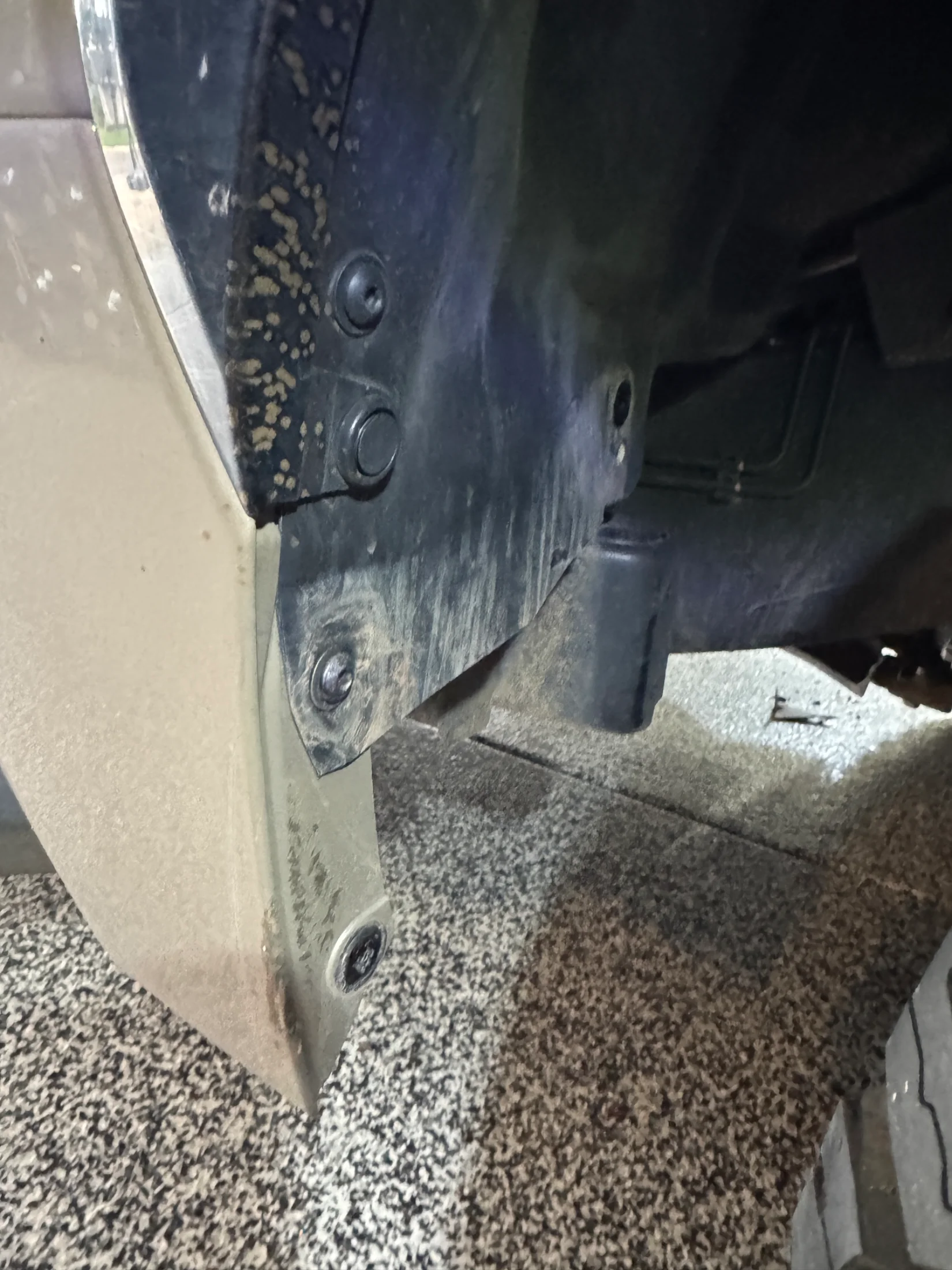

I took them off, put the OEM tires and mudflaps back on and washed my hands of the whole misadventure.

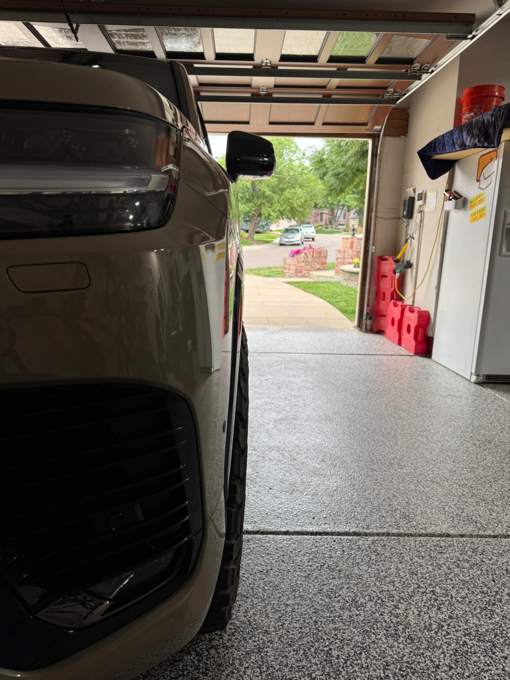

Before and after. It’s difficult to capture the perspective of the stance, it’s slight, but the tires are now pushed to the edge of the body.
Hopefully, this helps anyone considering running 35s. It takes a lot more work to do it right (no rubbing) than I was ultimately willing to undertake.

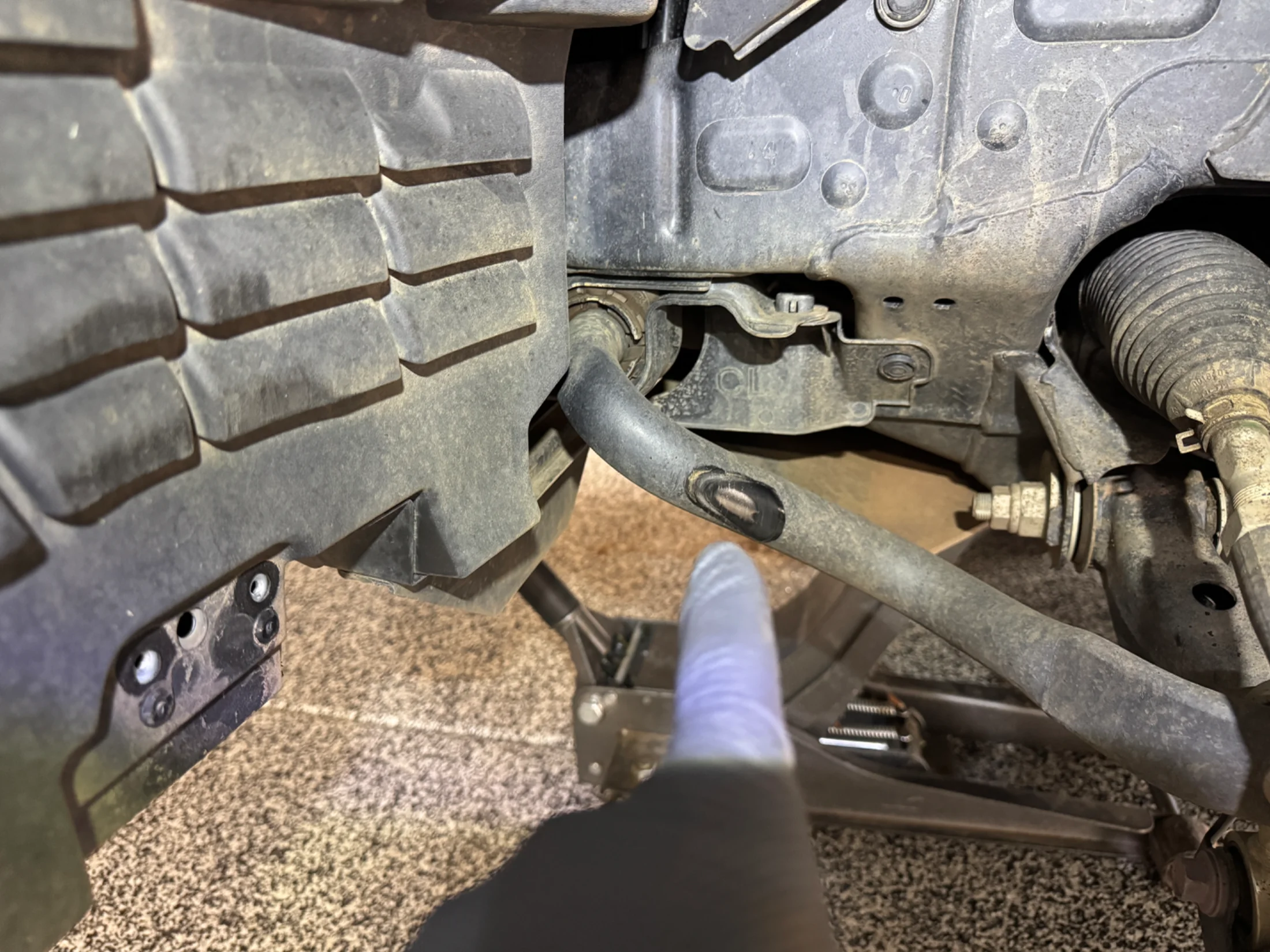

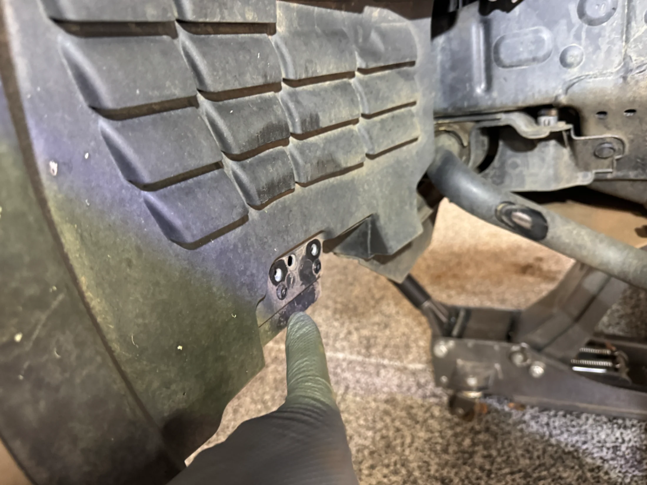

I did repaint the sway bars where it was rubbed down to bare metal. Everything is back to stock now.

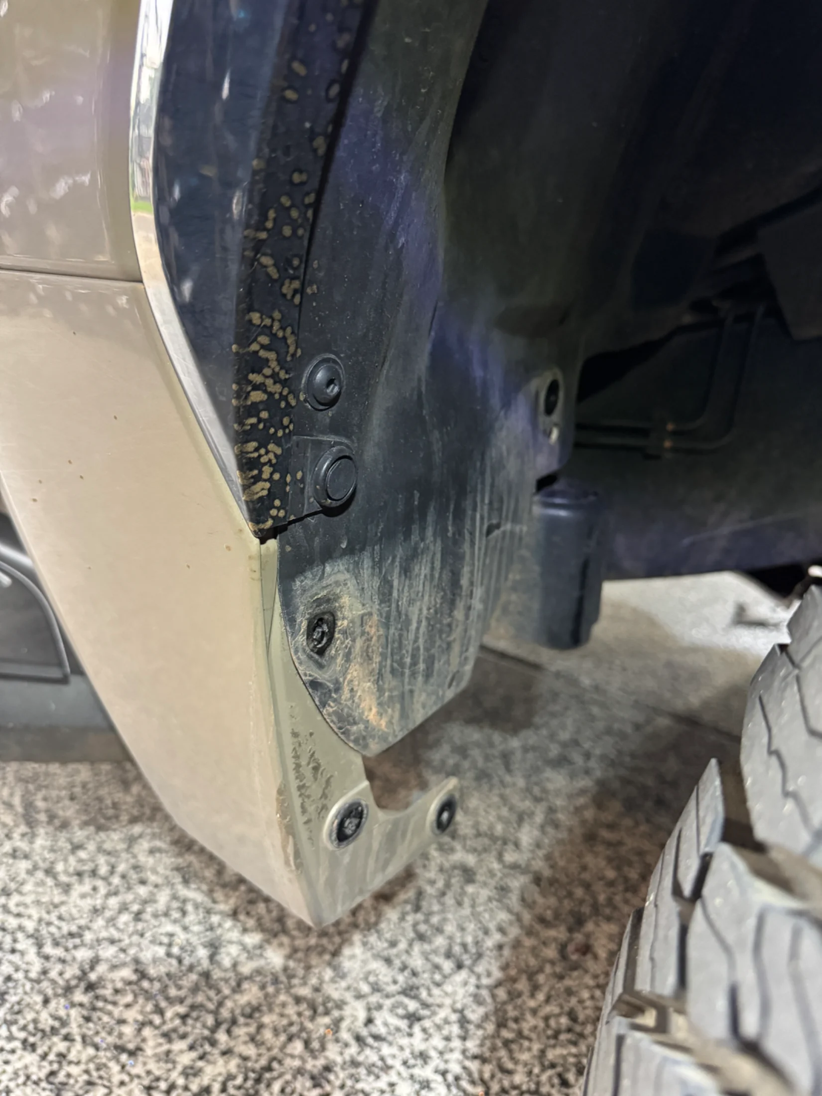

Would you say that by adding spacers it increased the liner rubbing a tad?
Yes, unfortunately, it made a "slight rubbing" situation much worse. The OEM scrub radius/OEM wheel offset is the easiest way to clear 35s with a bit of trimming and removing mudflaps.

I was afraid of that. I was considering a 3/4" spacer to get off of the sway bar but my wife would prefer I not start trimming massaging plastic just yet (although I've already removed the mudflaps). Thoughts on something like a 3mm "floating" spacer?
That could be the sweet spot for sure. My wife isn't exactly thrilled with the time and Dr. Nick surgery I've been performing either lol

Are you rubbing the sway bar too?
I think, a bit, still trying to figure it out. I definitely sandblasted it while (allegedly) doing donuts at the beach last weekend.
