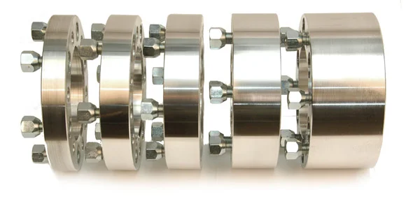

cant seem to find 2" spacers, 6 lug with 14mm lugs, the problem is the 14mm lug, can only find these with 12mm lugs
Because of tire size i put 14mm lugs from the 100 series in my 60
Any ideas?????
Sorry man but there is your issue.
The 100 Series are five lug and use 14mm studs. The earlier Land Cruisers six lug but used 12mm studs. You have created a hybrid that no one else has.
I think you will need to build your own wheel spacers. Buy some six lug spacers, and install the 14mm wheel studs. Yes, you will have to bore-out the spacers to accept the larger diameter, 14mm wheel studs.
