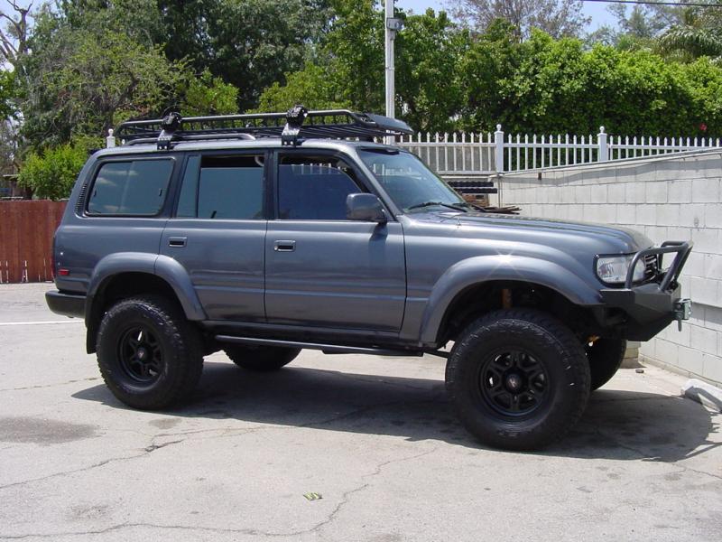

I run 3.75 BS wheels and have no issues with rubbing. Have run 3.5BS in the past without issues either.
I have 33x12.5x15 tires on 15x8 wheels with 3.75 BS and a 3.5" lift on stock control arms and no bump stop drops.
No rubbing when stuffed but it's close on the inside of the rear fenders. No rubbing up front when turning either.
17x9 with -12ET offset which is 5" Back Spacing. No rubbing... well a 5" lift helps.

I am running the 17x9 which in my opinion is an appropriate width for a larger 35" tire. the backspacing is 4.25.
