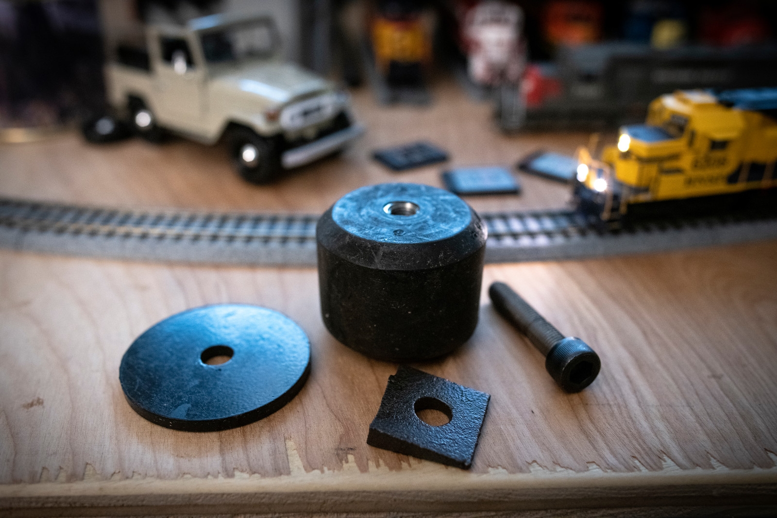

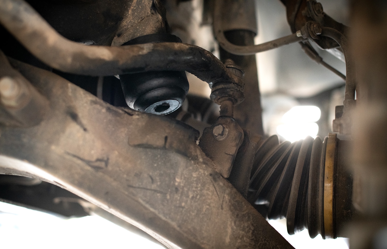

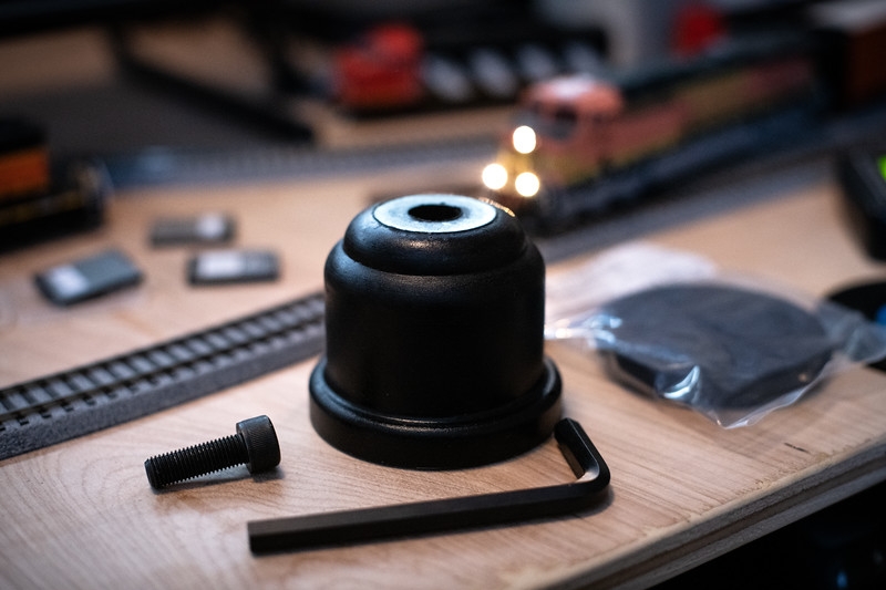

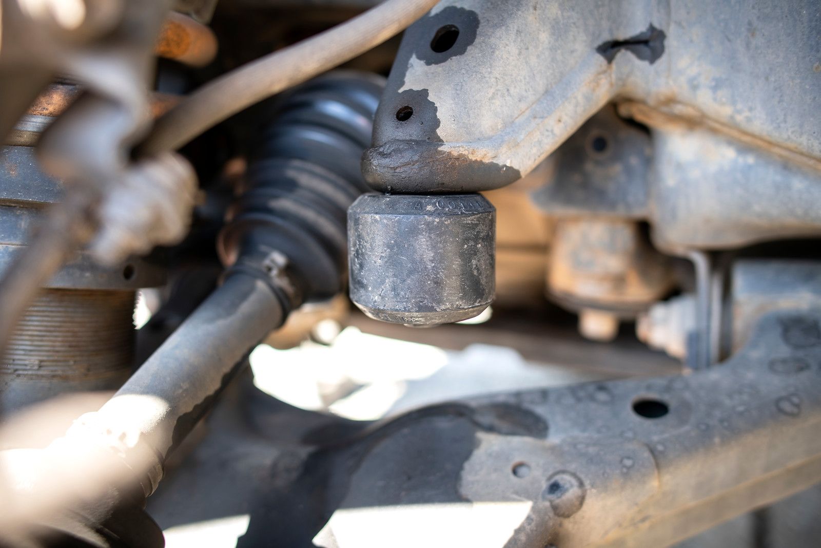

Super happy with them so far, ran a bunch of trails in Moab after I installed them, speed and low speed rock crawling and think they gave me exactly what I wanted. That being said they are def expensive for what ya get, on my 100 I have the Wheeler front bumpstops, about half the cost and so far they are working out great also. The Wheeler only come with one per side where as the Timbrens replace both of them on each side. Install is super easy and fast, go on just like the stock ones come off except for the bolt is separate from the bumpstop. If ya do decide to go with the rears down the road get your sawsal ready as ya have to cut a small chunk of the base off as it's in the way. The Timbrens are really nice but I've also had good luck with the Wheelers on my 100, The wheelers are massive but appear to have more give. Not sure I answered your question on if they are worth the cash or not, I guess I think both options are worth looking at and are ten minute installs. top 2 pics are the Wheelers for my 100, bottom 2 are the Big Money Timbrens!
