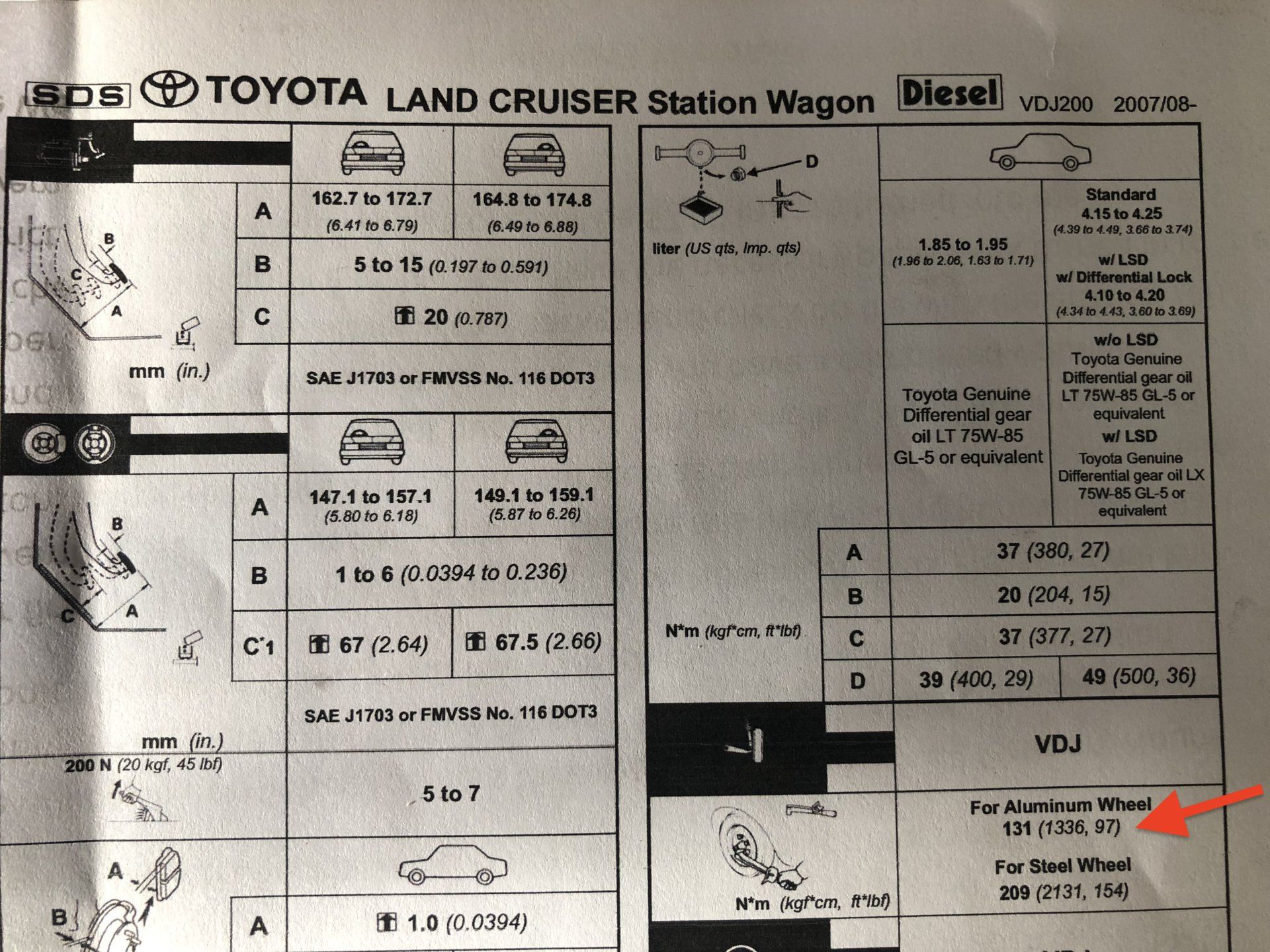

The chart @DPA200 posted above shows 97ft-lbs for aluminum wheels and 154ft-lbs for steel wheels.

Great point, and that certainly explains the stud being so damn big for only 97lb/ft.
One major factor to consider when comparing our aluminum wheels to Toyota’s version of steel is the different lug to wheel interface. I’m sure you’ve seen our lugs with a thick washer that presses on the whee and actually does the clamping. Steel wheels use an acorn lug with a non-rotating tapered face that has to slide against the tapered seat in the wheel. It’s possible the higher torque number is needed to overcome this friction and get the bolt elongation needed.
It’s also worth pointing out that rock warriors originally came with cone seats, but they have an aluminum seat in the wheel and a tapered face on the lug that can spin independently of the lug, meaning the friction is actually between this steel part and the steel lug body. So it can’t be compared to true steel wheels.. and per toyota only needs 97lb-ft

I think @hankinid and @bloc have the correct explanation for my brain.
The usual dry (meaning a very light amount of oil) vice lubricated (like anti-seize) is up to a 30% difference in torque.
So if the washer acts in the same manner as lubrication, the lower torque for wheels with washers would be required to achieve the same stretch. 154 to 97 = ~30% reduction.
