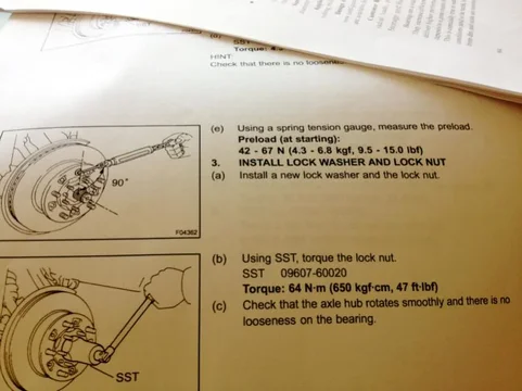

Sounds like most of you are over-torquing your bearings by at least 4X!
The FSM specification of 9.5-15.0 lbf... as in pounds per foot. The specified preload value should be measured at 12" to attain the specified values. Since the bolt circle on our rigs is 150mm with a radius of 75mm/2.95" (call it 3"), the specified FSM values must be divided by 4.
Therefore, at the fish-scale attached to the lug, the target value is 2.375-3.75 lbs.
Toyota needs to make this more clear in the FSM.

i'm not following.
The 9.5-15 lbs is NOT lbf - it's not torque, it's lbs on the spring scale when pulling on a lug in te top center position. It's not the torque to be applied to the adjusting nut.
or are you equating the bearing torque with the torque applied to the adjusting nut? I don't think they are the same or comparable.
could you elaborate?

Oh, boy! See my point? Confusing as heck. I know it's the specified value for the spring scale, but I don't think your math is right. Moment = force x distance. So, if it's true that the 6-15 lbs on the spring scale is supposed to be measured on a 12" arm, then to get the same moment with a ~3" arm you would need to multiply by 4! So you'd need 24-60 pounds on the spring scale! From my experience that would give about 125-300 lbs of tq on the nut. "Yikes!"
I think until I can get a definitive answer I'm going to adjust them by feel, screw all the rest. I know that's how many mechanics do it, and we really don't have that many catastrophic failures (at all).
Spring scale is not measuring torque, it's measuring rolling resistance.
When I use the scale, tigntening axle nut to get FSM spec with the fish scale gives me what I would expect to be standard torque for a wheel bearing...which equates to the same axle nut tightness I get using the FSM torque requirements.
I'm used to tightening front end bearings until I feel a bit of rolling resistance with a freshly lubed bearing, and then backing off the nut to the nearest flat or cotter pin hole, depending on the vehicle...
The bearing assembly is the same as any other car/truck...don't see the importance of the scale, but I do use it...I doubt there'd be an issue by simply using the FSM torque numbers without the scale...
Yes, and no. It's not torque on the axle nut, but it is measuring the "torque" required to turn the hub on the bearings, so it is one of two bearing "torque" measurements.
So, are you saying that the ~6lbs on the axle nut gives you 6-15 (or 9-15 I forget) lbs on the scale? I was nowhere near that, nor were many others. See threads linked on pg1. My understanding of the fsm is to start with ~6 lbs and adjust (increase) until 6-15 lbs is needed on the scale to measure "rolling resistance."
This sounds great, until you actually realize you need 35+ lbs to get into the lower spec range. This makes me think something is amiss.

Sorry about the miscalculation... It was a long day. =]
The FSM procedure seems right up until the preload measurement is taken at the wheel stud. The 3-4 lbs of drag by the fish scale that everyone is able to achieve by following the FSM procedure sounds reasonable for a preloaded wheel bearing... not the 9-15 lbs that everyone is trying to attain. I'm convinced that the "9.5-15.0 lbf" specification is a typo.
The preload measurement at the stud has no lever factored into it so the FSM shouldn't show "lbF". Once the "F" is in the equation, that becomes a measurement at 12" radius, not 3" as the FSM shows.

Just wanted to add my experience. Did wheel bearing and didn't have a fish scale, and didnt properly lube the axle shaft needle bearing. The truck would reverberate from 50-70mph.
Tore down the front end this morning, re lubed the needle bearings, picked up a fish scale and set both to 15lbf. reverberation is gone and she is silky smooth. I was really worried I was going to have to rebuild the front diff. Start to finish the job took 2 hours.
