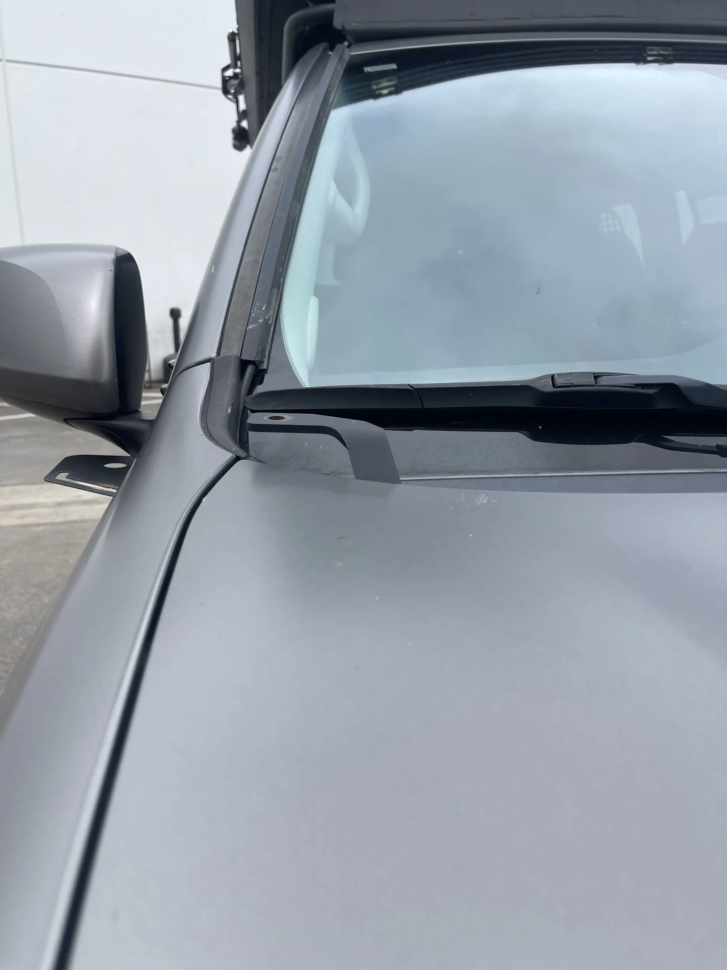

Clarify removable? There are magnetic mounts that you just stick on the hood but in my opinion those aren't great for a GX. They position the lights too far forward so they are in your field of view and not a great spot if you want an actual ditch light. I'm pretty sure every LED pod you could use as a ditch light only has 1 bolt to hold it to whatever mount you choose. So if you go with a bolt on mount, you can easily remove the actual light pods and no one will notice the mounts.
I have Baja S2 wide cornering lights on Cali Raised mounts. The Cali Raised mounts are very low profile and super solid. The S2s are a great shape for an actual ditch light.
Yeah, I was thinking magnetic, but I think you convinced me otherwise. Those Cali Raised mounts and lights look like the ticket. I wonder if I can also mount my Ghost GMRS antenna to one of those brackets.
What were you planing on doing about the wiring? Just use water proof male/female connectors and keep them tucked under the hood when not in use?
I use M6 nut inserts in my Baja lights with CaliRaised low profile brackets. I have an extra pair of AC Delco connectors filled with silicone to cap off the wiring under the hood.
