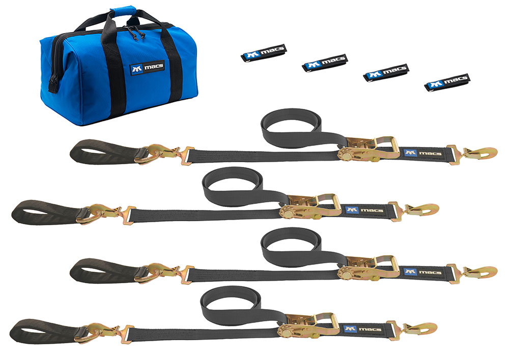

We always buy our straps from Macs custom tie downs. I use this kit

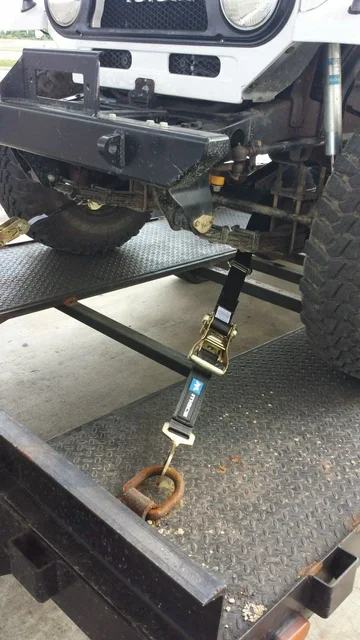

For the front I go through the bottom A-arm and straight forward. I use these straps since the axle straps have another thick anti chaffing cover that prevents straps from cutting. On the front A arms make sure you avoid the sharp edges.

Like Mr. Slee said, Axle straps around the rear axle tubes and thru the lower a-arms in the front.
The kit from Mac's is nice, but you can piece them together from places like tractor supply, albeit, you'd have to buy the fancy carry bag.

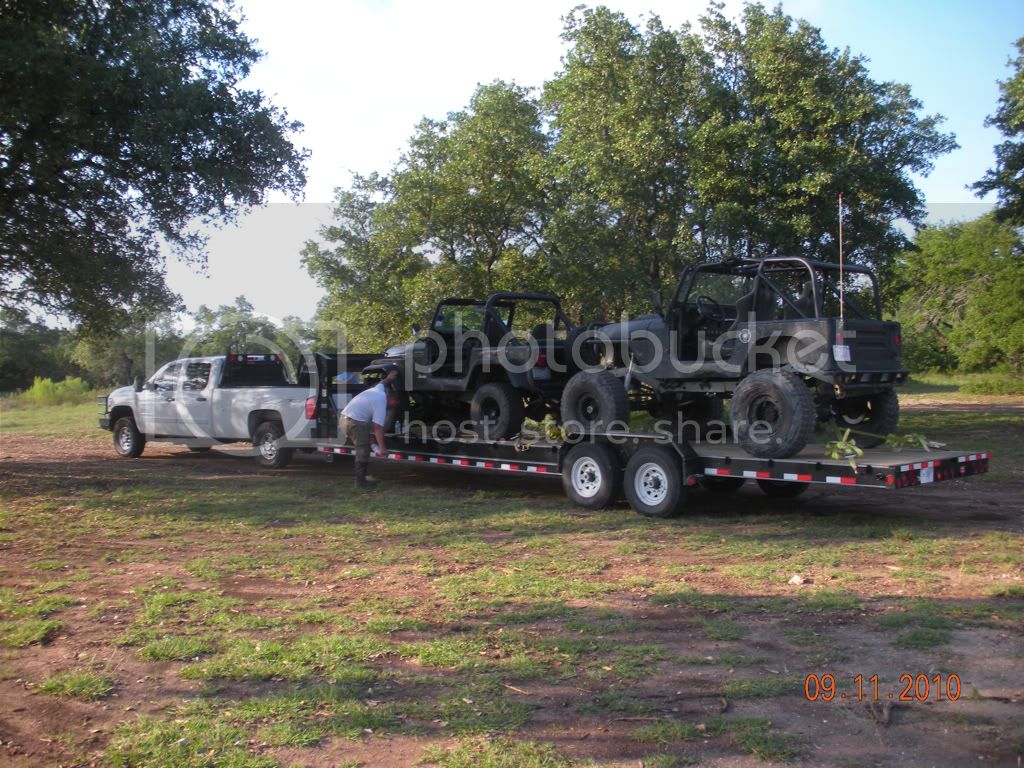

Hauled lots of things this way...
