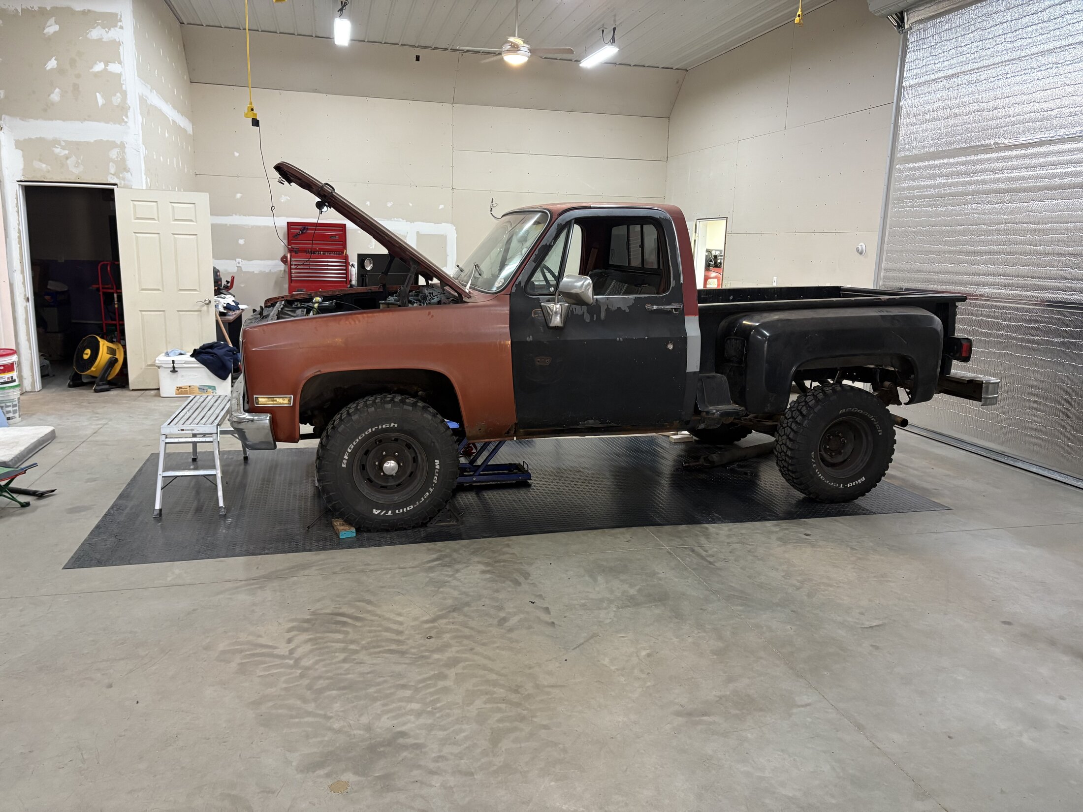

The pump was shot when I bought the truck, didn't work at all. I replaced the failed Holley Blue pump with a similar Holley Sniper EFI pump. The transfer takes to about an hour from what I've seen. I'm not sure if my pump's bad, or if there's some other restriction in the system.
Is there a sock or in-tank filter by chance? Is there a fuel level sending unit still in the tank?
Thanks
-Rob
I honestly cant remember if there is a sock. I made block offs for the other holes. That blue pump moves a lot of fuel (when it works). I am thinking the efi pumps are for higher pressure, but not necessarily higher flow. Non- educated guess there
Thanks!
The pump I picked (80000102) is rated to 140 gph free flow, which I assume is the right number to look at.

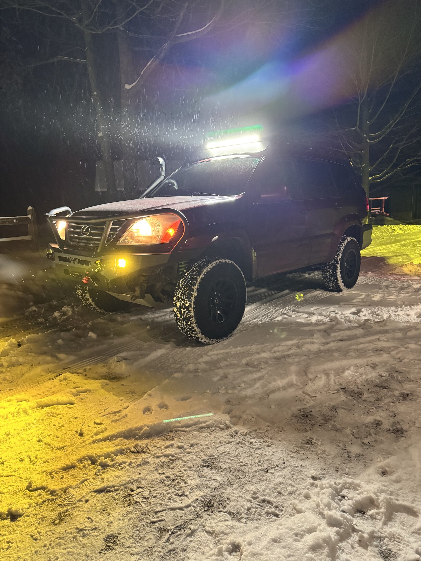

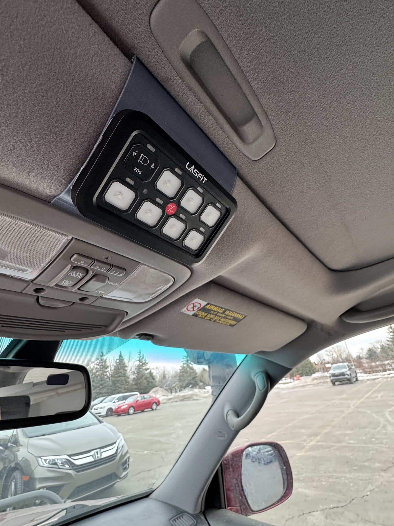

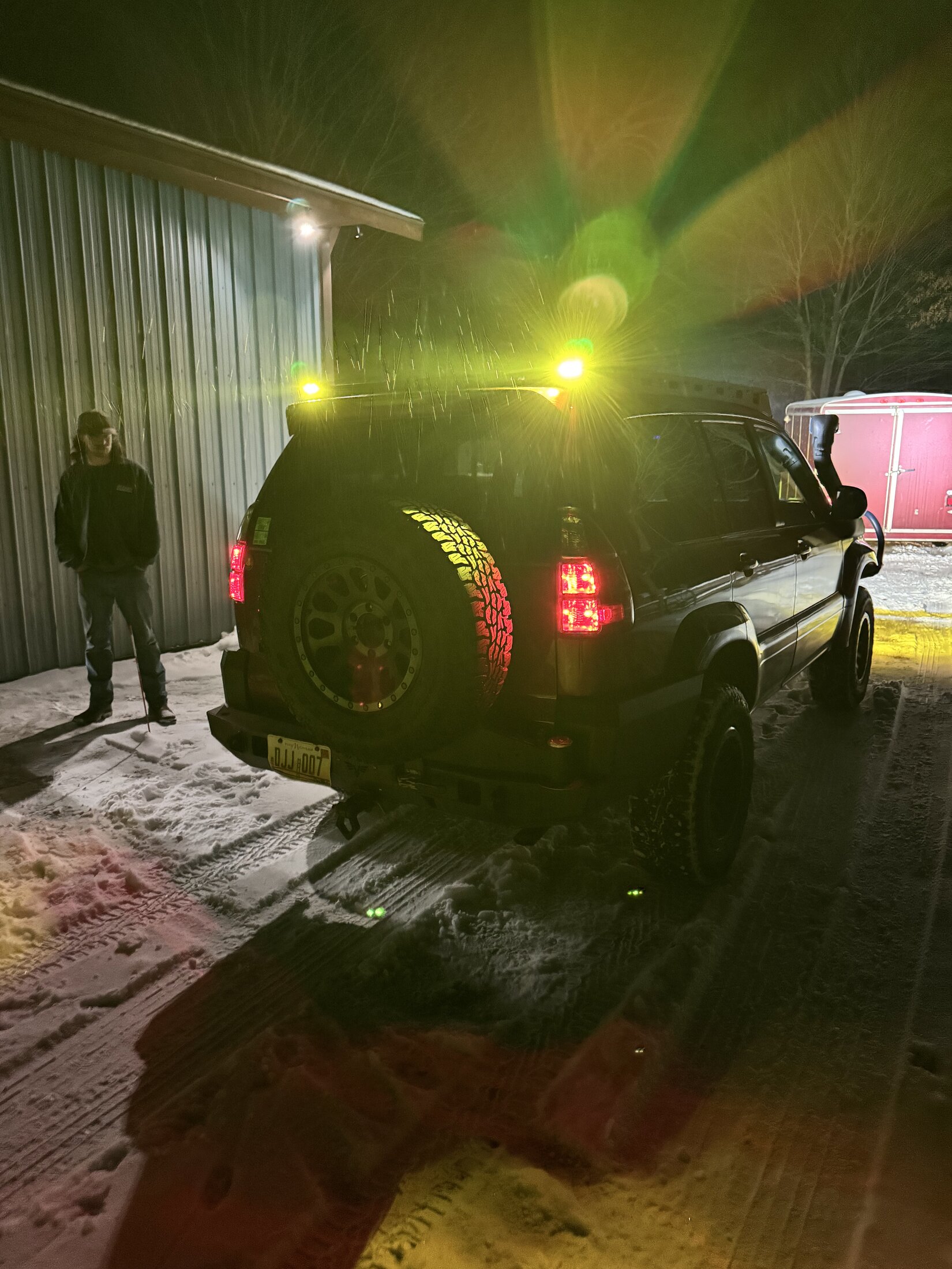

Buddy got a heated barn down in burnips so we have weekly beer summits. Gotten the lighting on the GX, winch on, light controller in, and drank a good amount of beer.

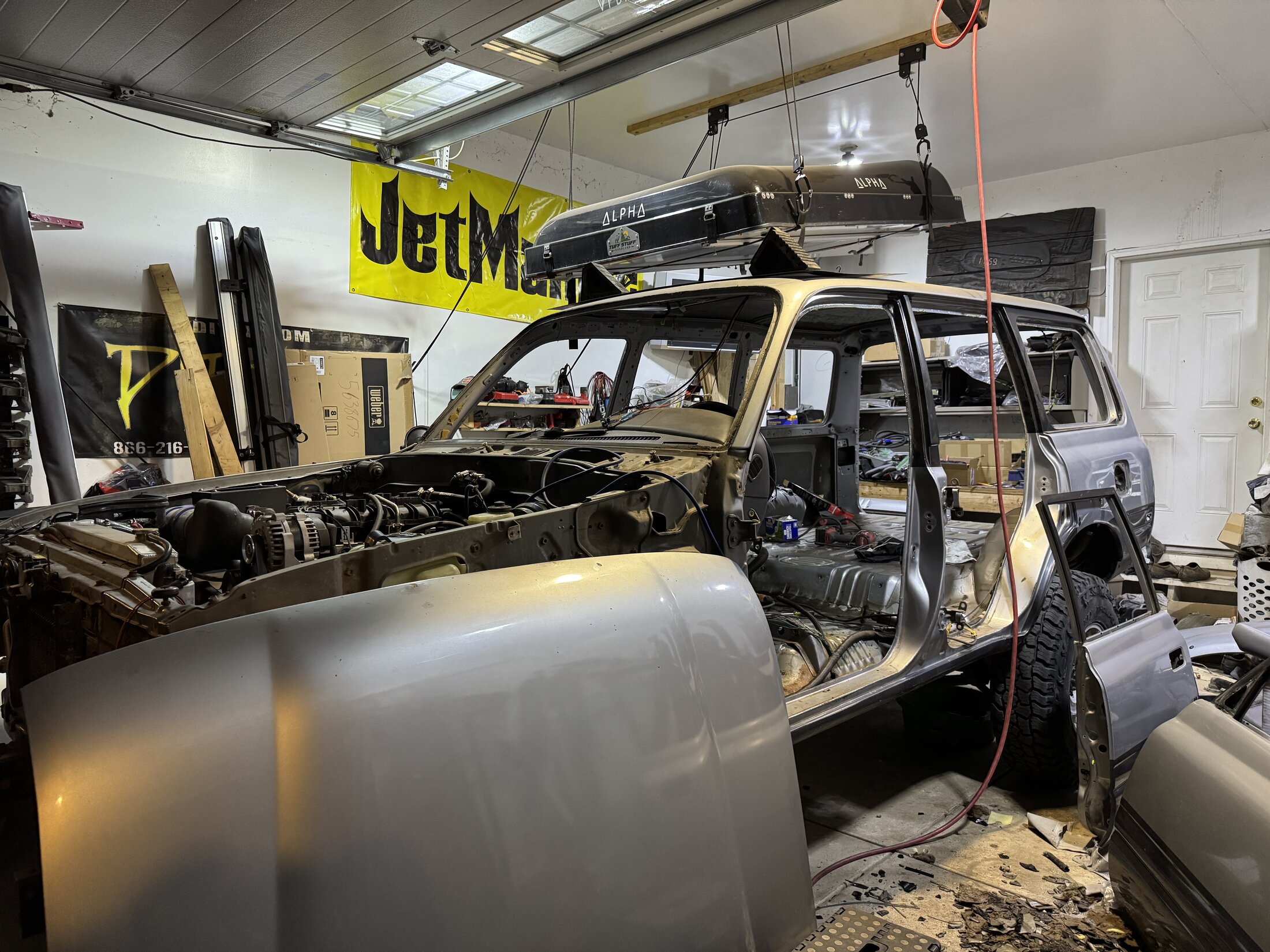

I tore apart a perfectly good 80.
Also deleted the sunroof.
Tearing everything apart for a full glass-out color change paint job.
Patching flare holes
Delete sunroof
Some rust repair
Reseal gutters
It’s also getting fresh carpet, headliner, all door seals and rubber, new windshield, grill and quads, fresh powder coat on the bumpers and sliders, Radius snorkel, sound deadening, etc..,

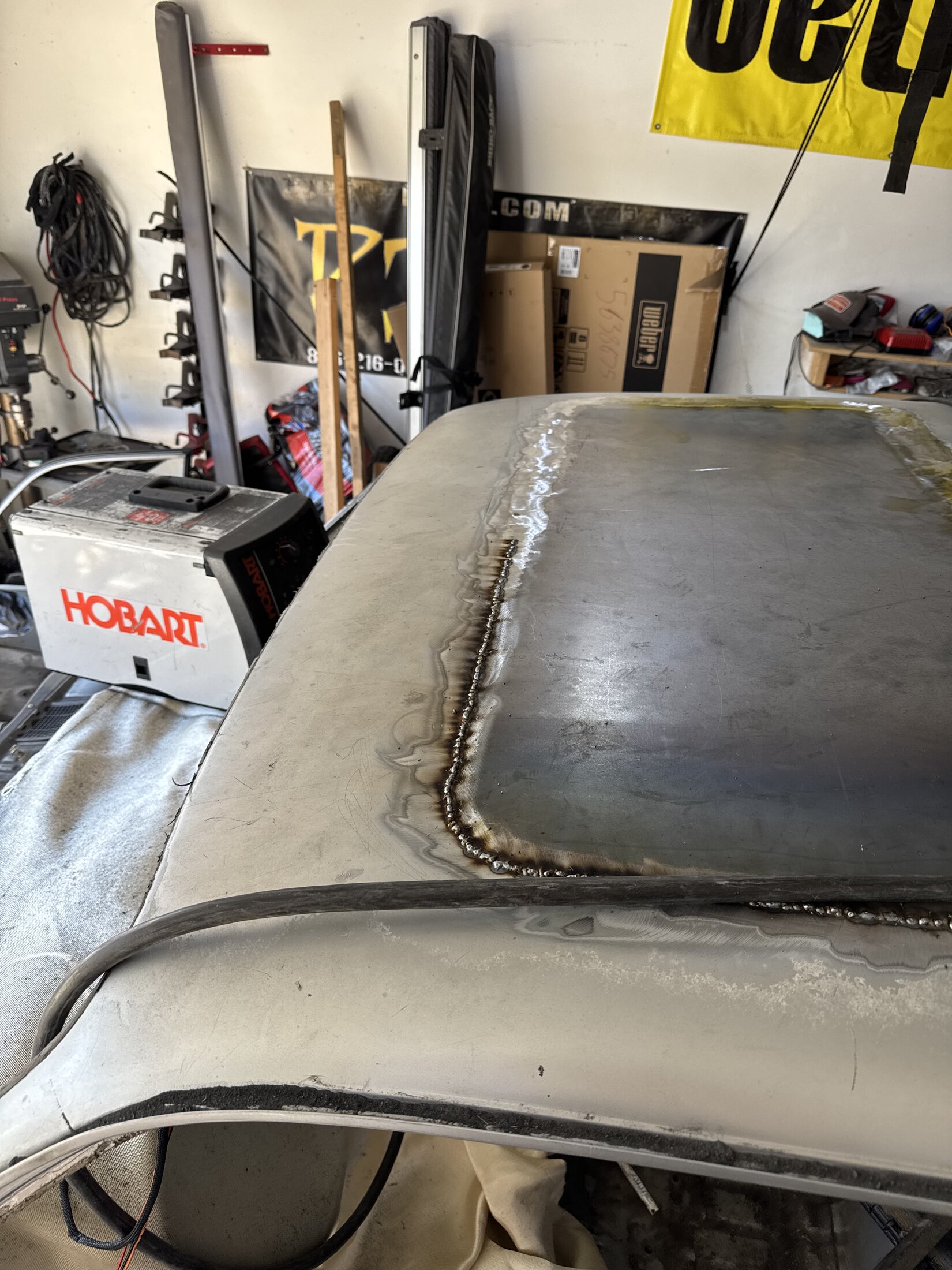

So @RivMan , what color are you going to on your 80? I have a green CA native 80 that is all apart. I don't love the green and my favorite 80 color is white (the only reason I sold the 80 I had!). That looks like a big job getting all those tight spaces!
Also, how is the sunroof fill in going? I would consider doing that too on mine if it ever happened.
The plan is to go white with the 80. I've looked at a ton of options, and keep coming back to white. It really is the best color for a flare-less 80. This build will be my ultimate 80. A white Poverty Pack-esq build with a big LS and fresh seals.
The sunroof fill is well so far. I cut a sheet of flat 16ga steel to the exact shape of the cutout. It fit with less than 1mm on all sides. I got the whole plate tacked down with ~2" spacing. The flat plate curved really well to match the contours of the roof. Then I started filling in the tacks every 4", doing one half of the roof at a time. After a couple hours of that I took the grinder to it, and ran another tack over any pinhole I found. I may run another bead from the inside, and cap it off with some seam sealer. The roof will need a little body work, but it's hiding under a Bowfin rack, so it probably doesn't have to be perfect.
I left the sunroof sheet metal structure in-place to support / reinforce the roof for now, and to be a heat spreader for welding. I have the two OEM front non-sunroof support crossmembers on order. Once they arrive, I plan to cut out the sunroof bezel and panel bond the stock supports as factory would have. I also have a set of factory non-sunroof headliner bows, and a new headliner on order.
I can't find anyone that's done it the "right" way. I'm hoping everything fits as I'd like it to.
