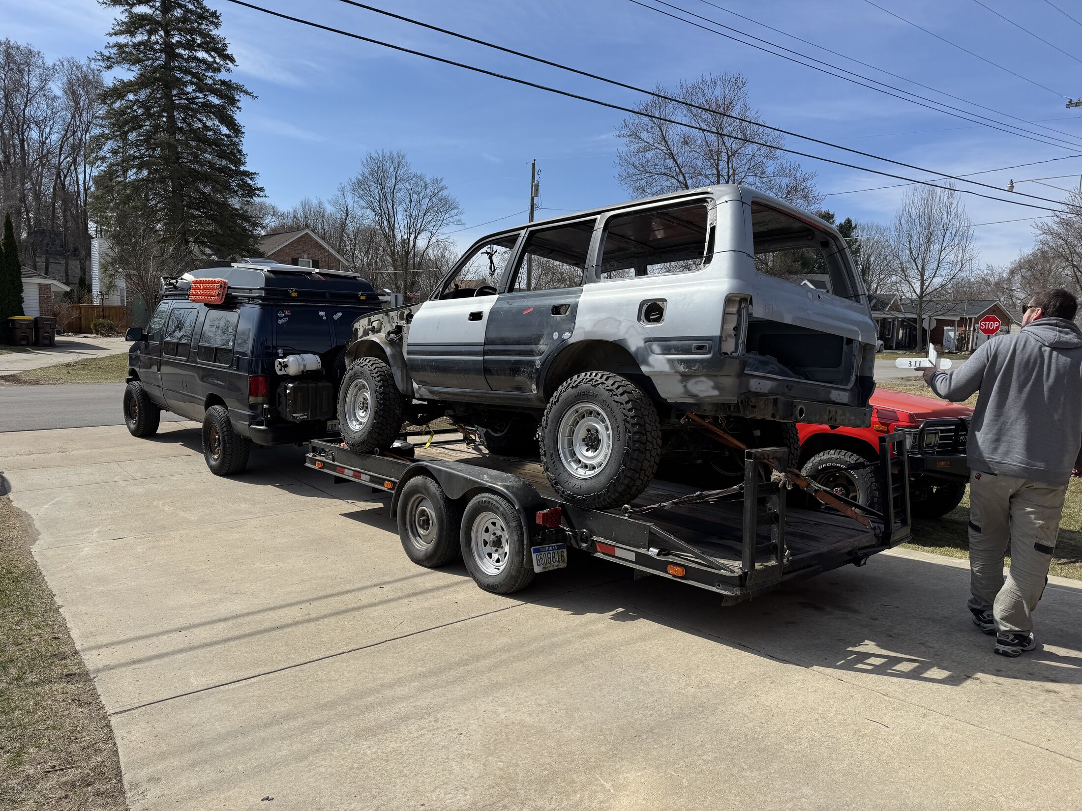

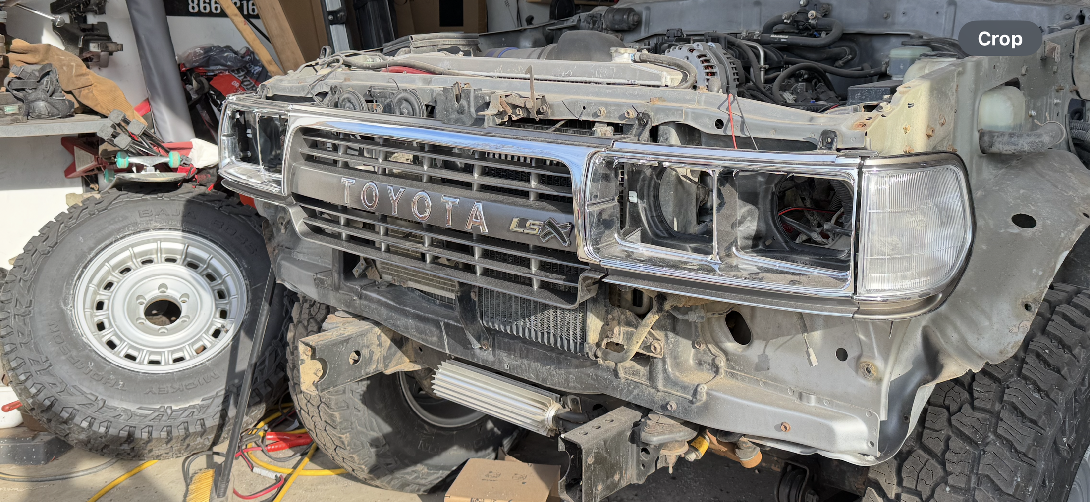

The plan is to go white with the 80. I've looked at a ton of options, and keep coming back to white. It really is the best color for a flare-less 80. This build will be my ultimate 80. A white Poverty Pack-esq build with a big LS and fresh seals.
The sunroof fill is well so far. I cut a sheet of flat 16ga steel to the exact shape of the cutout. It fit with less than 1mm on all sides. I got the whole plate tacked down with ~2" spacing. The flat plate curved really well to match the contours of the roof. Then I started filling in the tacks every 4", doing one half of the roof at a time. After a couple hours of that I took the grinder to it, and ran another tack over any pinhole I found. I may run another bead from the inside, and cap it off with some seam sealer. The roof will need a little body work, but it's hiding under a Bowfin rack, so it probably doesn't have to be perfect.
I left the sunroof sheet metal structure in-place to support / reinforce the roof for now, and to be a heat spreader for welding. I have the two OEM front non-sunroof support crossmembers on order. Once they arrive, I plan to cut out the sunroof bezel and panel bond the stock supports as factory would have. I also have a set of factory non-sunroof headliner bows, and a new headliner on order.
I can't find anyone that's done it the "right" way. I'm hoping everything fits as I'd like it to.
-Rob

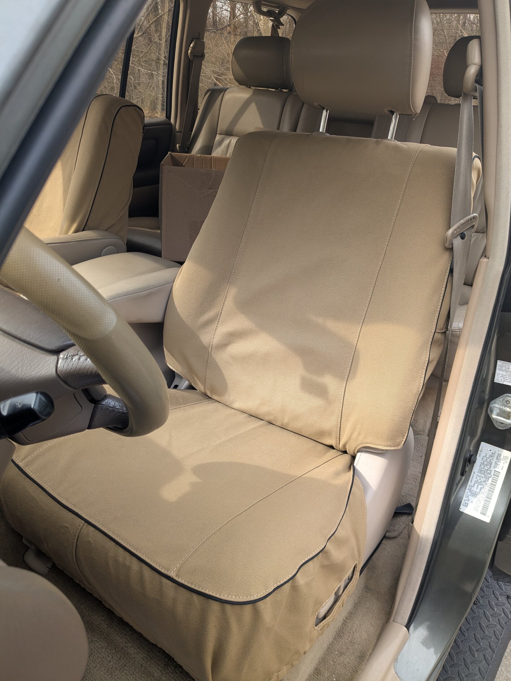

Small project but done and pleased. Escape Gear 100 seat covers installed. They fit well and I'll tighten them later after the material relaxes. Two banana job.

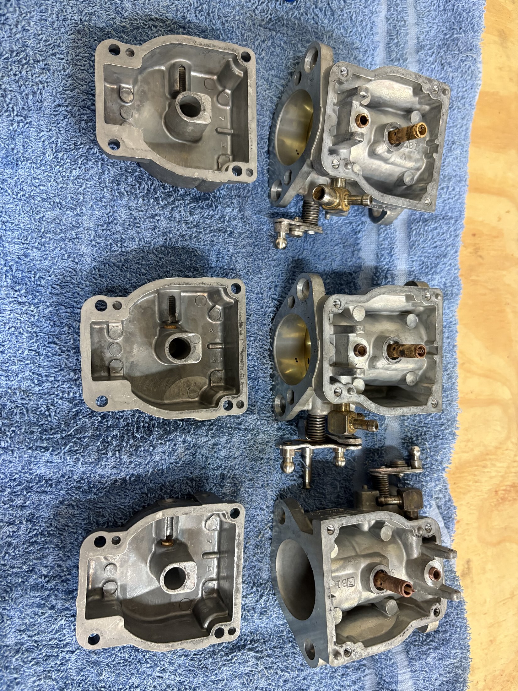

Been busy working on friend’s stuff. Got the square body transmission installed but it didn’t run that great. Ended up rebuilding the carb and a tune up while it was here. Also been rebuilding some Mercruy carbs for a outboard.

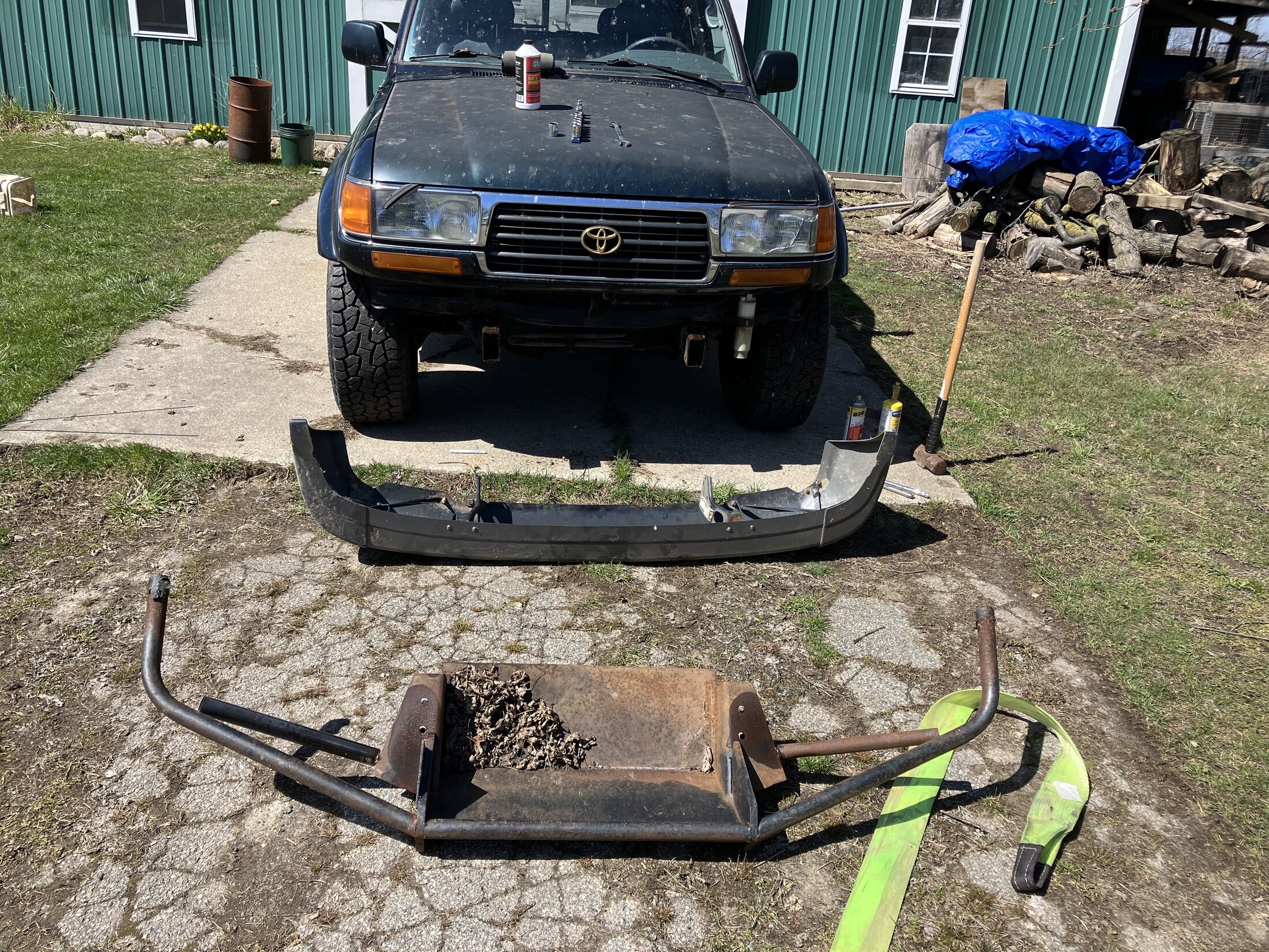

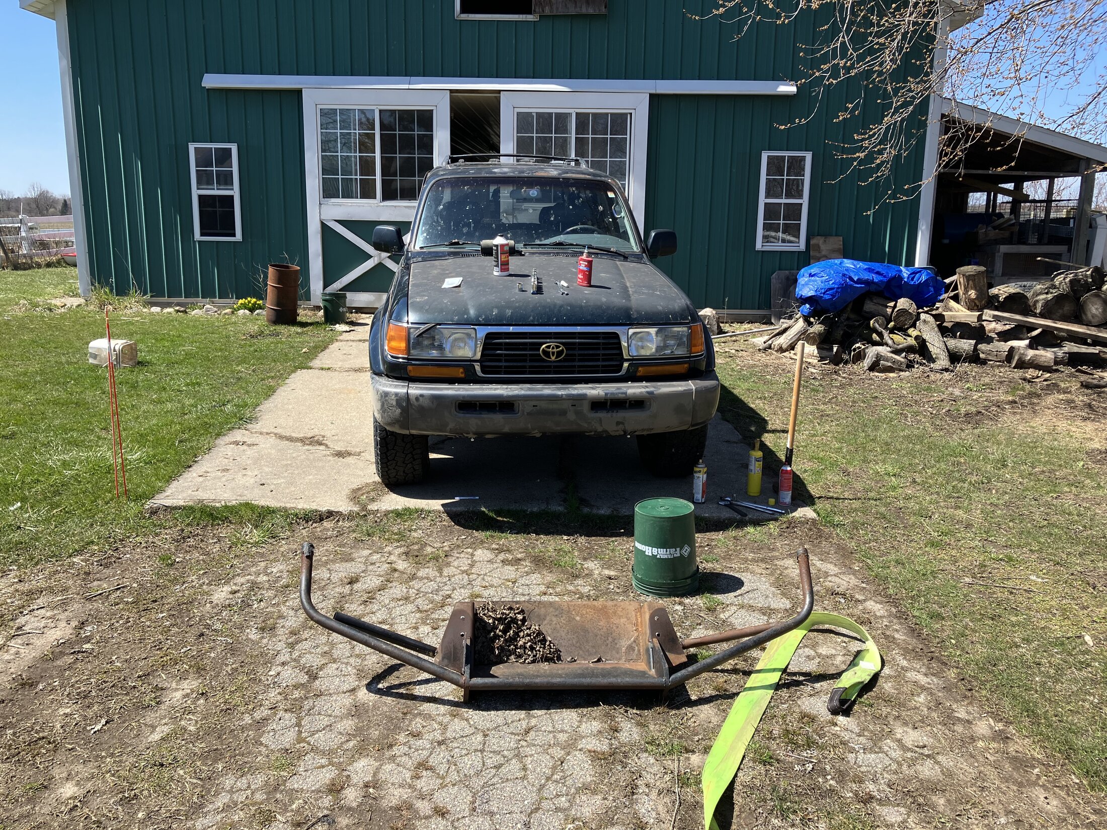

A true Michigander, a bottle of blaster and a torch. I had mine out today for a power steering job on my 100… not a fun one.
Yeah I heated up the weld nuts in the frame before hitting them with PB Blaster. I didn’t break any of the fragile bolts.
Not how my tale goes. Broke two skid plate bolts and had to concede that without a way more in-depth operation and potentially a new steering rack, I was not getting out one of the hard lines. So I played it safe and replaced the soft half of it and the high pressure line. Now to bleed it all and put it back on the ground.
