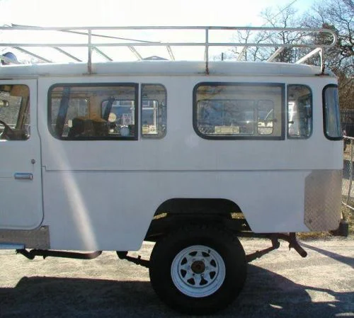

the original ones were wire frame racks.... these were sourced local in most areas... later racks were more stout racks.
alot of racks were add-ons by previous owners that were screwed down into the fiberglass.... places like jcwhitney sold the universal kits.... more appropriate add-ons were the con-ferr porthole racks

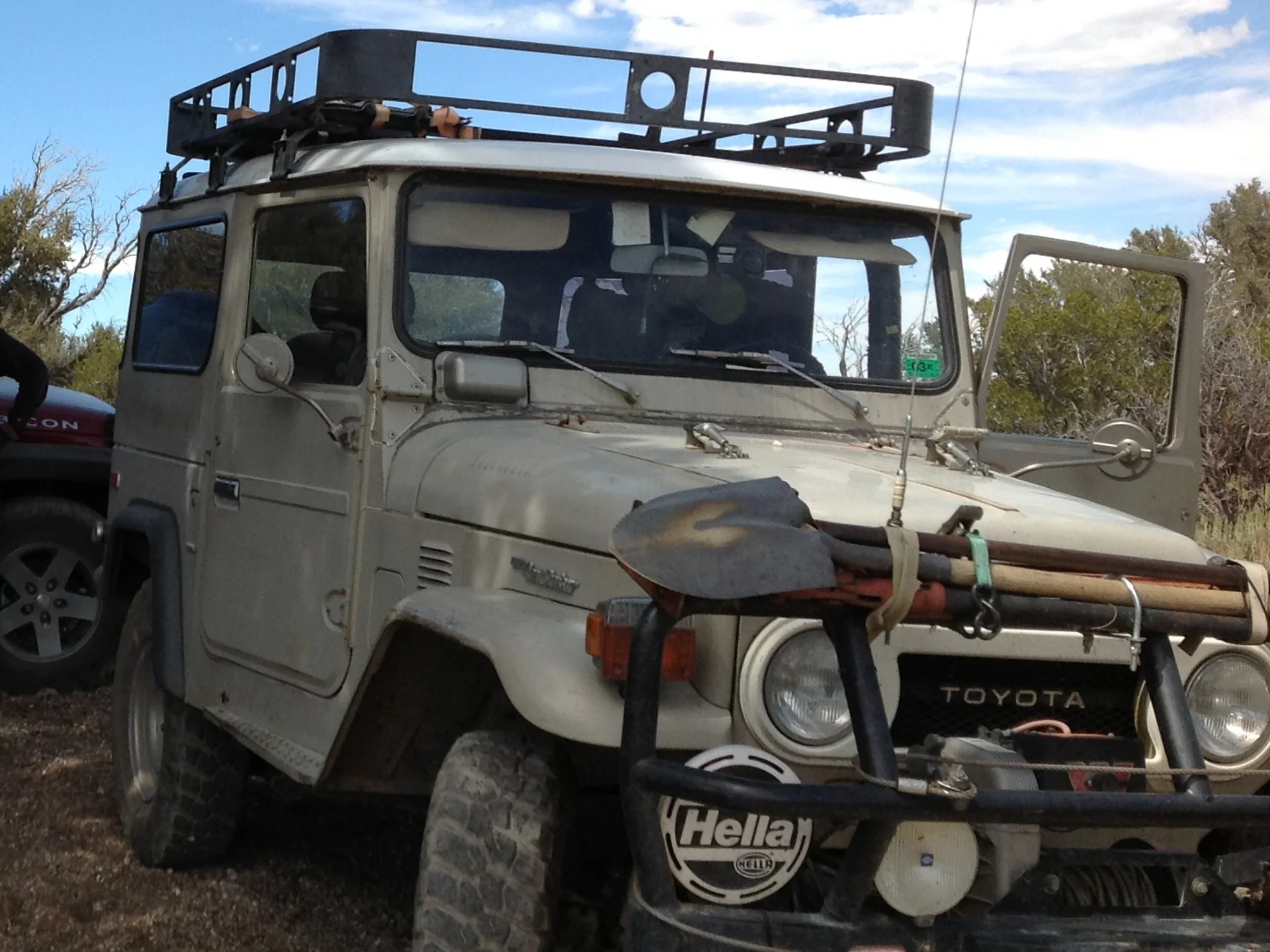

Con-Ferr rack on my truck circa 90? or so
