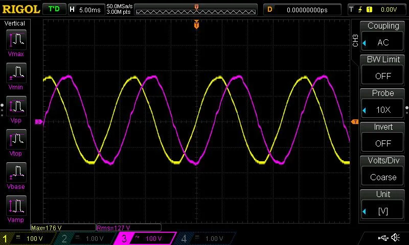

i will put the inverter on my scope to check the sine waveform (just to satisfy my curiosity), but it would actually be easier to use my DC power supply and to record voltage/amps during start-up, but it is a non-issue. the in-rush current will never exceed the surge rating of the Samlex which is 500W. The ARB fridge uses a Danfoss control and compressor unit which (i believe) is 3-phase and soft start. there is tons of info on this refrigeration system on the interwebs if you want to do the research. but, a 300W inverter (with 500W surge) can easily power the compressor.
i checked out the inverter today and it seems to be pretty solid.
easily powers the fridge and sine wave looks really nice. i don't really know if a chunky sine wave would hurt the fridge, but at least i don't have to worry about it.
here is the wave on the scope. yellow is utility grid power and magenta is the Samlex.
