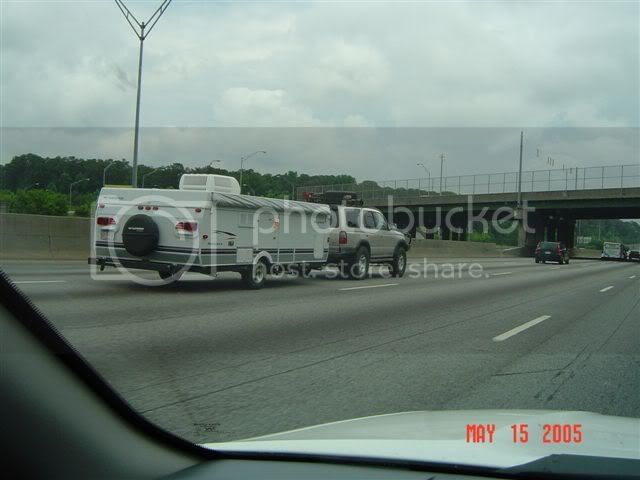

Stock '91 3FE, 4.88's with 33's (no swaybars either) pulling Fleetwood Evo II (3,500 dry; probably close to 4,000 loaded) using Kaymar rear bumper & brake controller.
I think you need to actually weigh that thing - advertised GVWR, and the one posted on the trailer's data plate, is 3500 pounds (it has a 3500 pound axle) and empty weight is about 2500.... I just can't see ANY 11 foot popup being close to 2 tons empty, even if you added generator/ ac and a bunch of water tanks. I had a 27 foot travel trailer with "the works" and it was 4800 pounds unladen.
http://www.fleetwoodrv.com/brandtomodel/floorplan.aspx?brand=evolution&m=E2
Have you considered using an equalizing hitch? What's the tongue weight as you have it loaded in the picture? Unladen it is almost 400 pounds, and that's a heck of a vertical load on the rear end of an 80. I used to tow with a 1984 3/4 ton 2wd Suburban (with the 1 Ton 14 bolt rear end) and even with that I wouldn't consider towing that much tongue weight without an equalizing hitch of some sort.
How do you like the trailer and how does it tow off-pavement? I am sort-of considering the smaller Evo 1 for camping with my KTM dirt bike. The tongue weight is a real negative feature for me - you can't tow on bad surfaces with an equalizing hitch because it doesn't articulate well and it hangs WAY down, and that is just the situation where you need it most. Bummer. Some more pics would be greatly appreciated.

Well, you could be right, and I haven't weighed it. I have 864's in the rear, and normally travel with a generator, 15g of water, 10-15g of gas and spare parts/tools amongst other camping crap.
Loading junk on the front does change the tongue weight, but I don't know how much, but the bumper is rated at something like 750# tongue weight, and I think I'm under that.
When it's hooked up it sits level.
As far as the trailer goes, it's alot more than I'd ever have for myself, but the wife drove the decision. I have always camped pretty spartan, but I must admit that it is real nice having your own bathroom, being able to take a nice shower anytime and napping in the afternoon with the AC... the facilites were what dictated the E2 over the E1.
It tows well on the trail, although I don't do long distance expedition type stuff. My biggest complaint is visibility- you can't see a thing behind you due to both height & width.
Looks like I oughta weigh it next trip... I'll try to hit a weigh station on the way to Hot Springs in two weeks and post back up (although I won't have the generator, fuel or water on board).
I don't have another picture of it hooked up to the truck...
