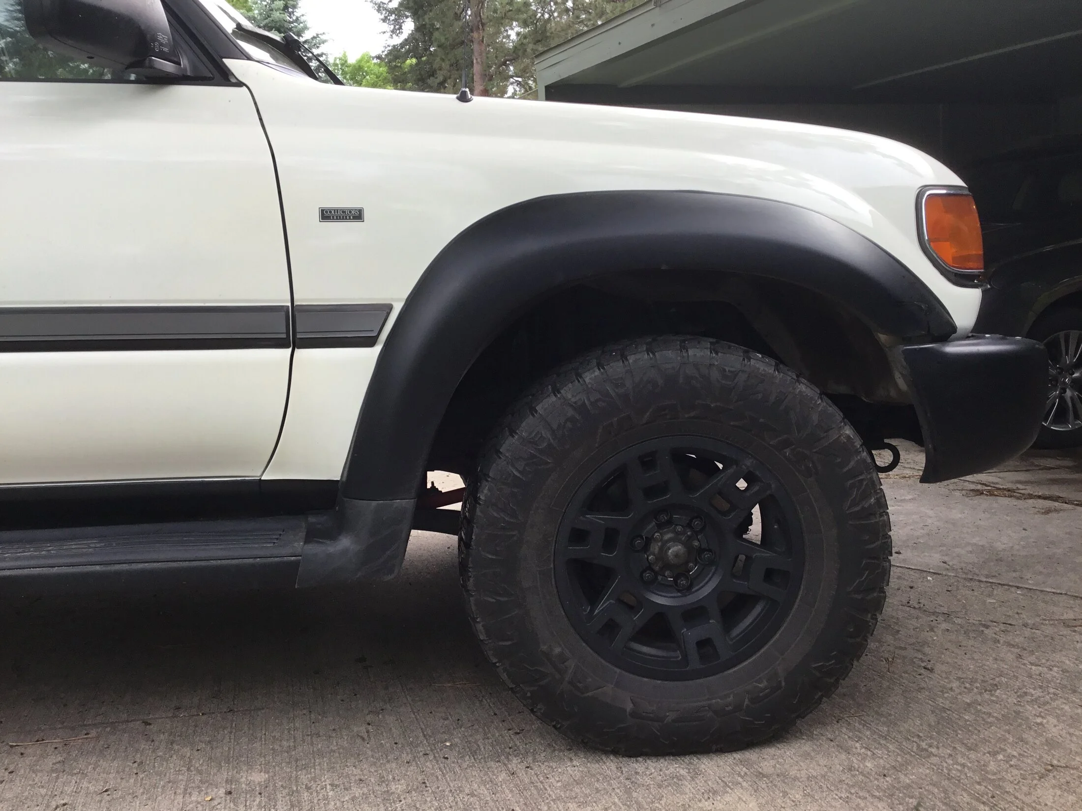

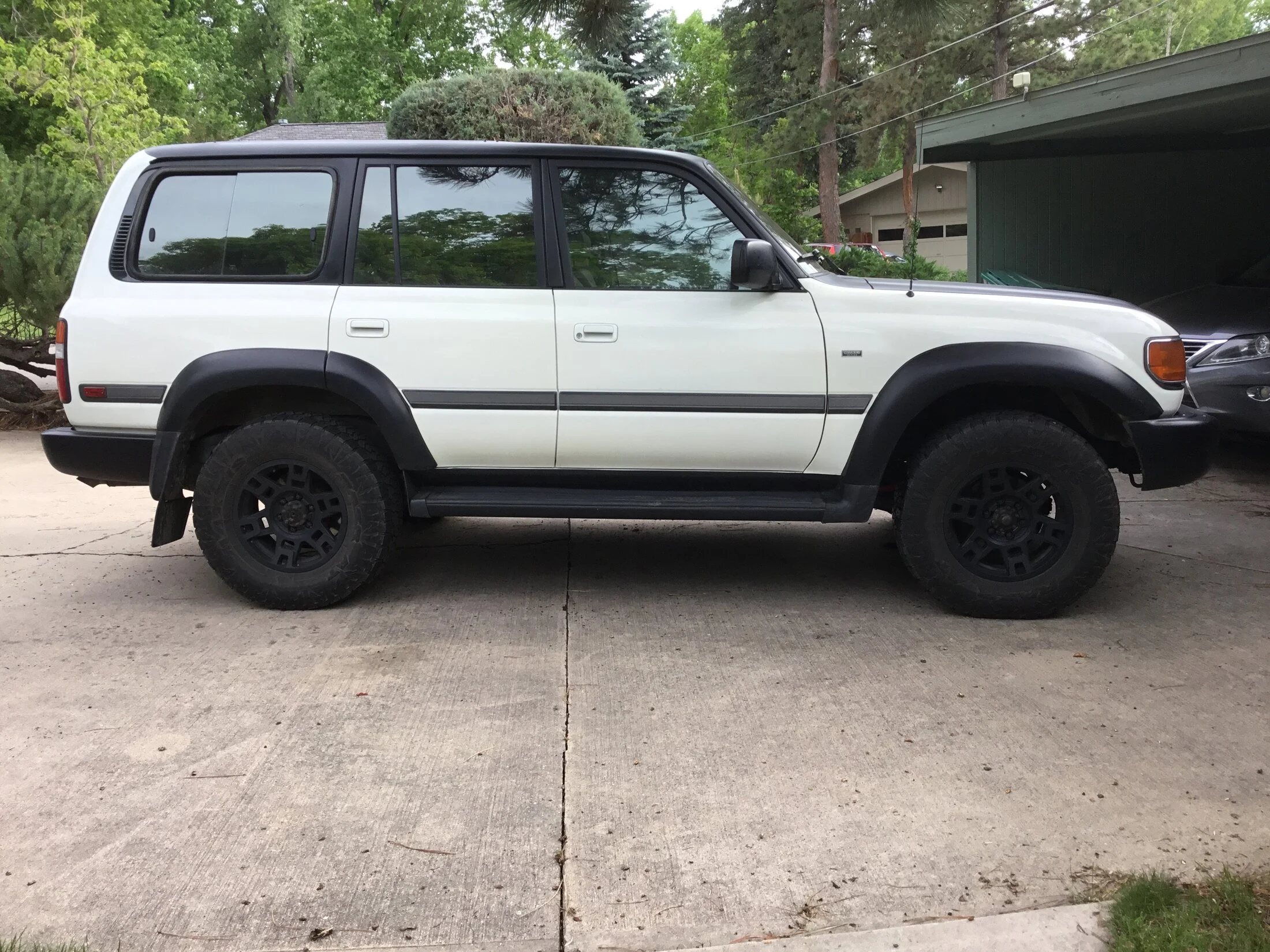

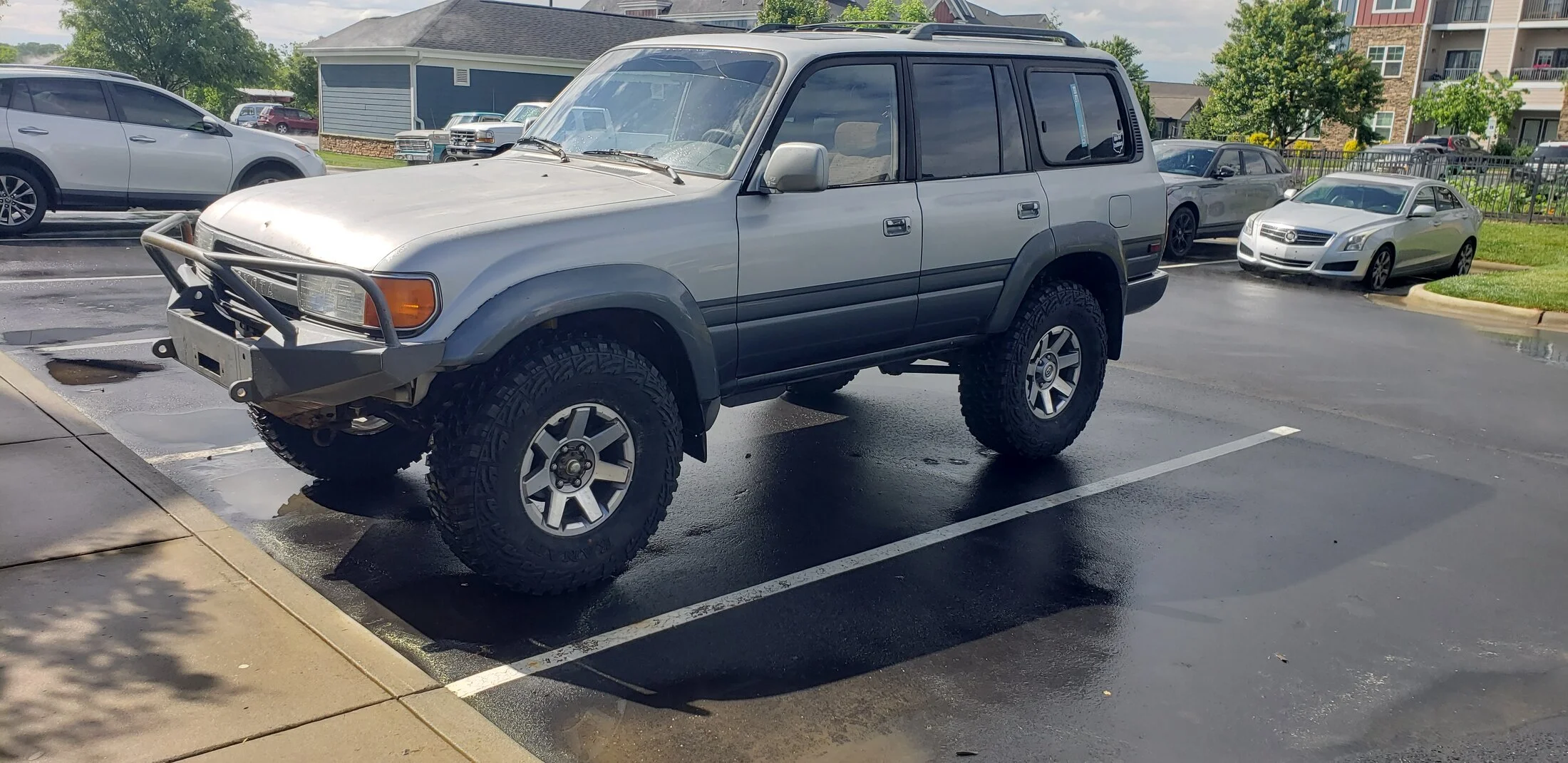

TRD Pro wheels are plug and play. They are very close to 0 offset which works fine on my 80’s. They are 7” wide though which limits the size of the tire . I’m running 285/70/17’s.

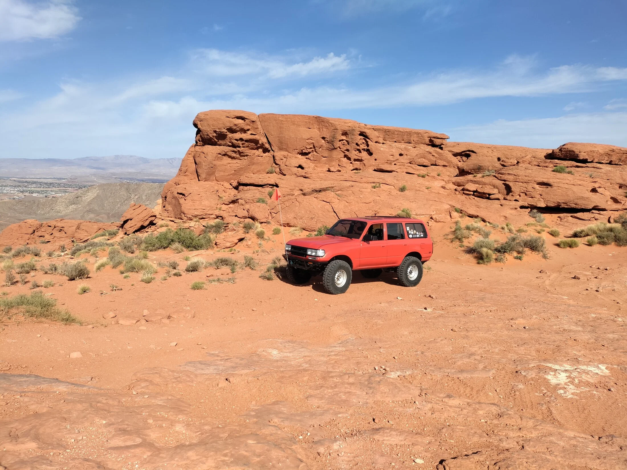

Those look good, did you have to use spacers?
Not yet, have some 1.5's available but I'm enjoying the firewall clearance and rear flare tuck with 37s. I get slight rub on the control arms at full lock but with smaller tires it wouldn't be an issue.
If you want to run center caps, spacers would be needed or figure out a tall cap that would fit. I can run rears with the SF axle but keep that in mind.
For non beadlocks they do have an added feature which the valves being hidden in the spoke material so ripping off a valve should be really difficult. Also can find them for ~$90-100 on ebay as takeoffs from 4runners.

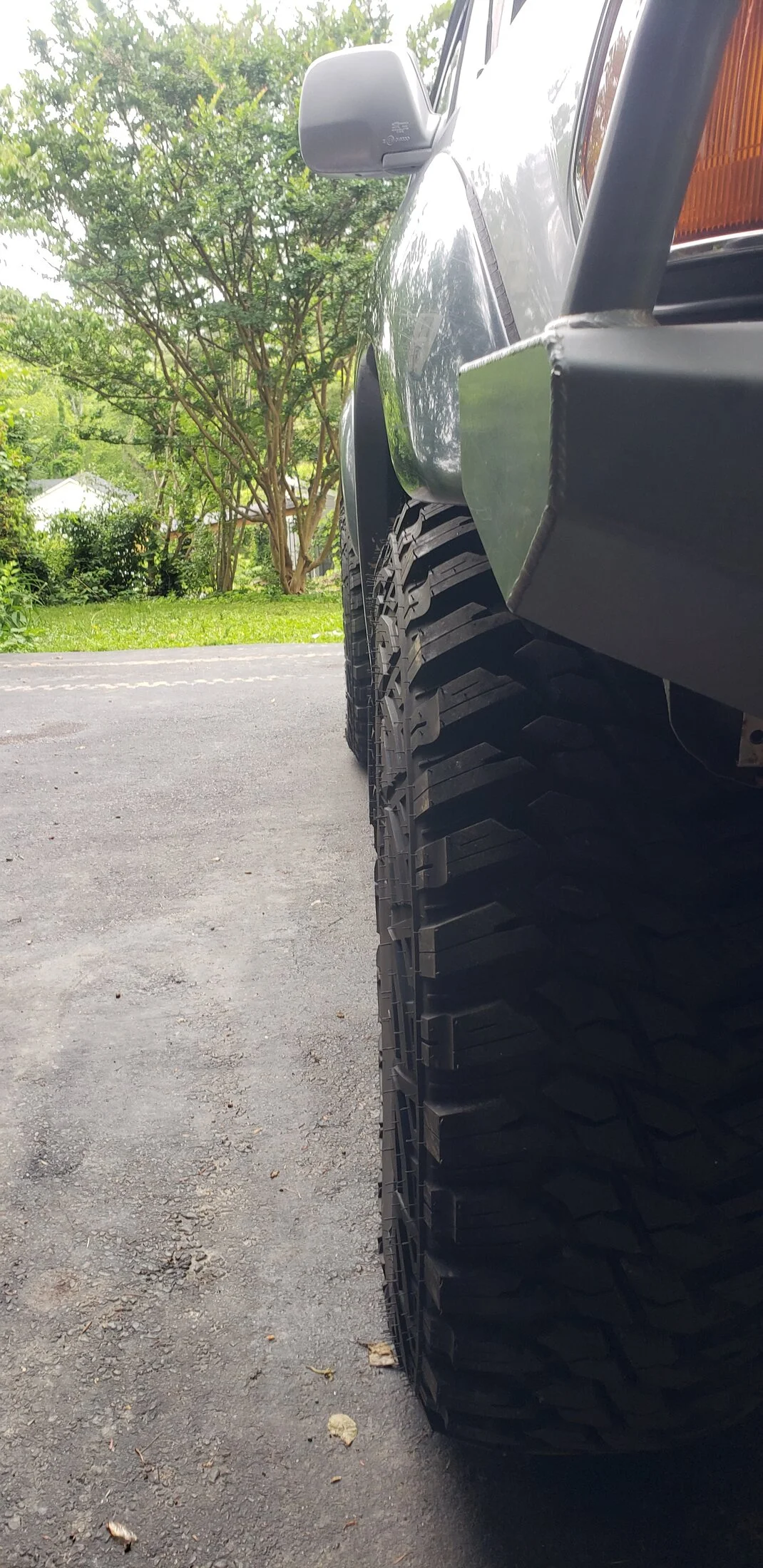

Nice, I removed my flares and don't want the tires sticking out. Probably going with pizza cutters, how wide are your tires?

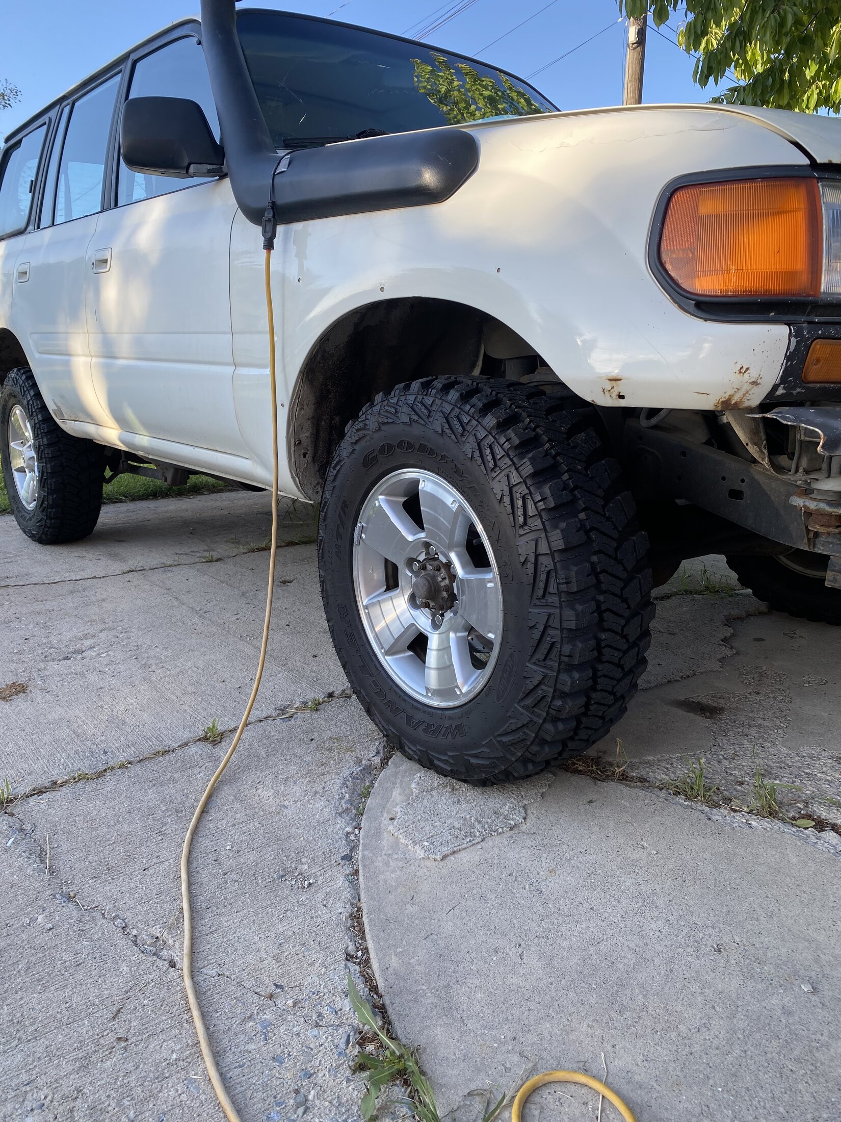

I just got 5 rims from a 2010 Tacoma (gotta have the matching spare!). No spacers. Can't run center caps in front or rear (if it's a full-float axle), but I like the way they look, and the fact that you can pick them up all day long for cheap. The tires are 265/70r17. 1" body lift. Stock, saggy suspension. No rubbing anywhere.

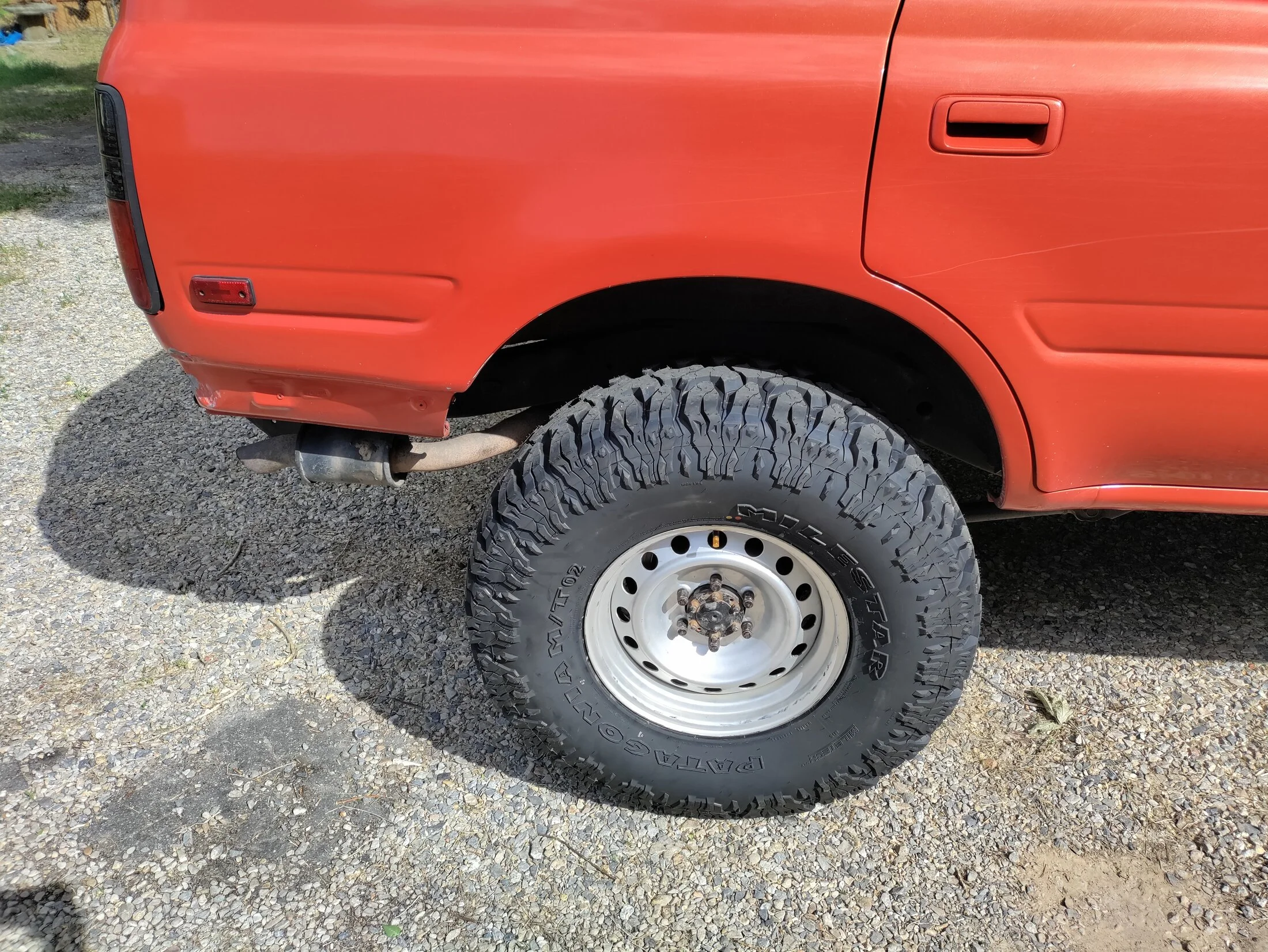

Running 17" steel rims which I believe are from a FJ Cruiser. PO put them on and I like them. 37s tires. They were on 2" spacers when I got it, which looked pretty cool but caused articulation / clearance problems. Now with 1" spacers all good. I think you could run them without spacers but track will be narrower than stock, as previously mentioned.
