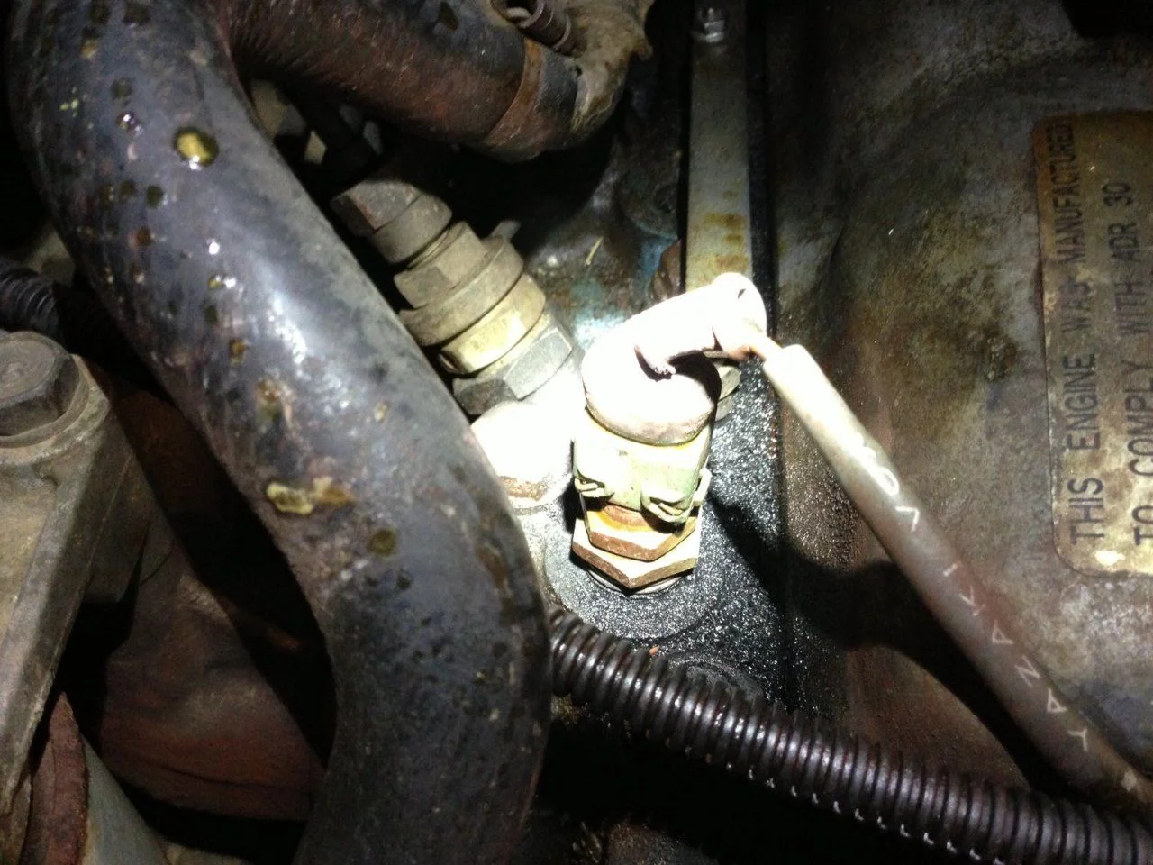

Appears to be a coolant temp sensor or similar; I probably need to order a new one. Anyone know the name and part number?
Rig is a late 1983 troopy. Thanks!

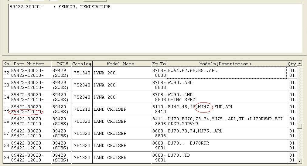

Thanks. Mine is leaking and I am looking for the part number. I looked online and am thinking it is part 89422-30020. If anyone can confirm, that would be great.
I think that's right ...
And that part number appears to have been substituted by 89422-12010
:beer:
And it is live in the US market.
it is active. I cannot speak to the 2H part.
Isn't there an o-ring used to seal that sensor? Is that where your leaking from, if so you need only replace the o-ring.
I need to look at it closer, but I think it is leaking somewhere towards the top where it is plastic. Great point though. I'll double check.
:beer:
There you have it.
Just as a follow up...I pulled the old one today and the leak occurred where the plastic meets the brass. The part number stamped on this one is indeed 89422-12010.
Really appreciate everyone's input!
