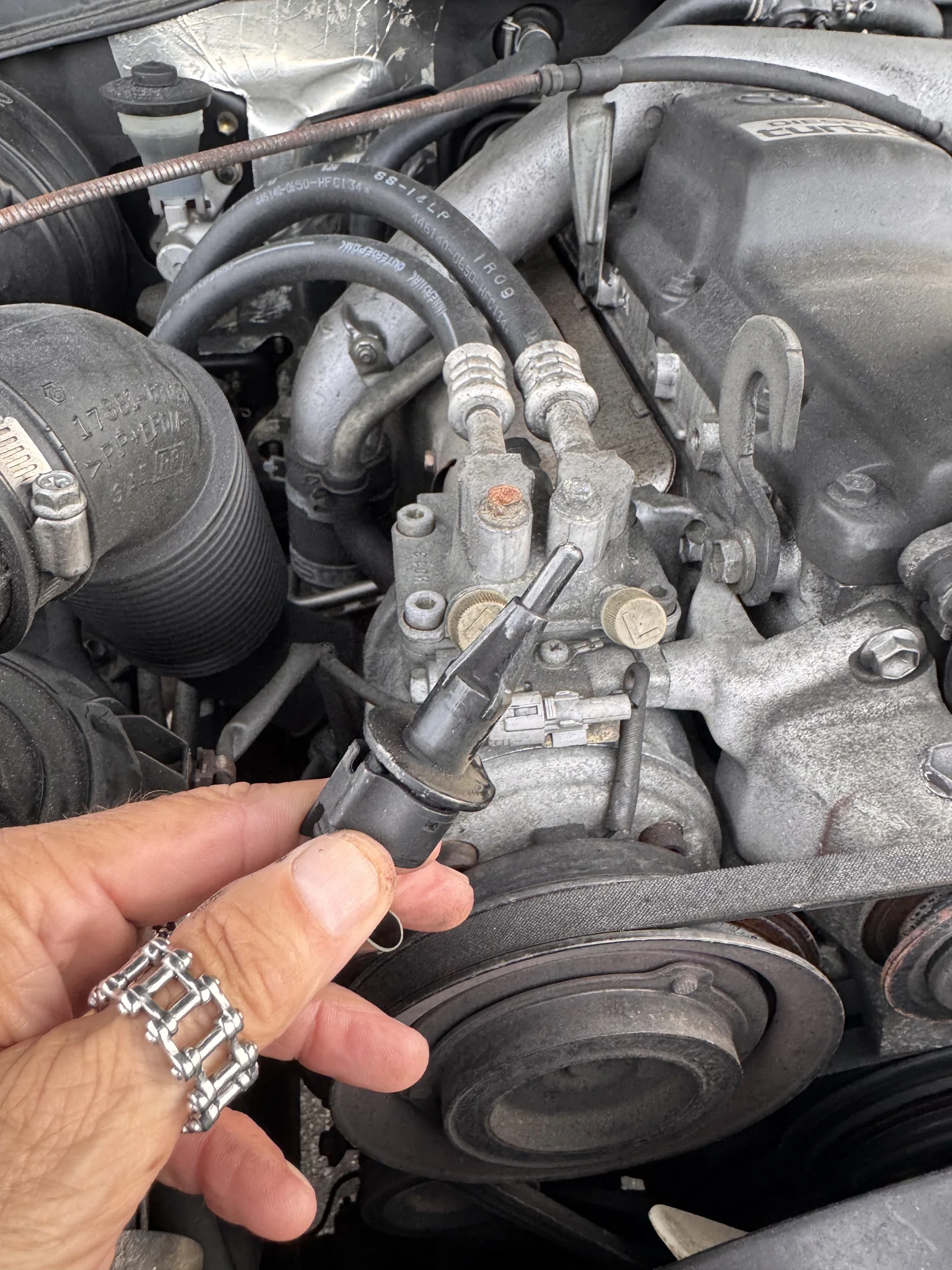

I found this what looks like a sensor hanging out by the AC compressor anyone know where it goes and what's it for . KZJ761 1kzj-te diesel

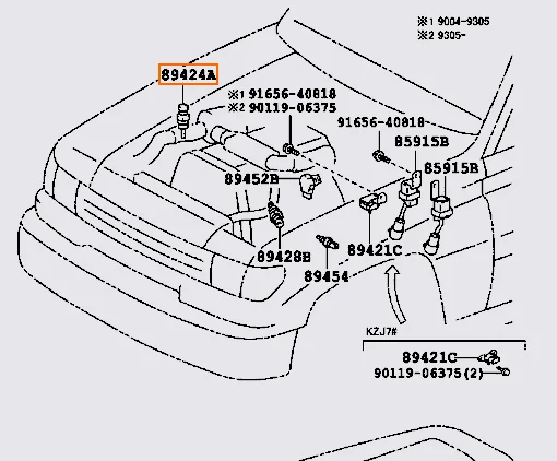

@AVL KZJ78 nailed it. That is the 'INLET AIR TEMPERATURE SENSOR', part# 89424-12010
