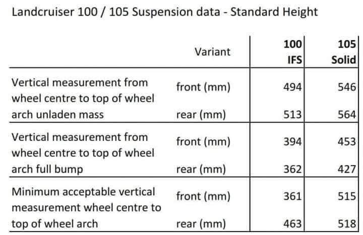

As the title says I'm curious as to what the standard 100 series (non-AHC) stock ride height is? Looking for center hub to fender measurements for bone stock cruisers. Mine is currently is on Ironman suspension with cracked TBs and I'm trying to gauge how much lift I actually have above stock.
And yes I've already used the search function and didn't find much.

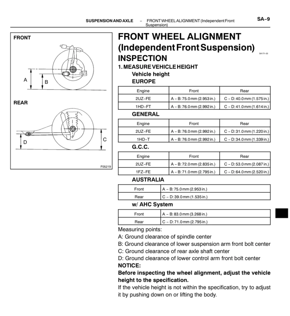

Be sure to try and keep the vehicle rake ~1" or less . I think the numbers mentioned above are a bit too steep. I believe stock height was more like 18.5-19" up front and just over 20" in the rear.
Might be (am) stating the obvious here, but trucks sag over time and use. A 25-yr-old 5,700 lb truck with 200,000 miles is not going to be at the original ride height. I think this is part of the reason we've all see those reactions: "I installed 2.5 inch springs and they lifted my truck more than 3 inches!"
