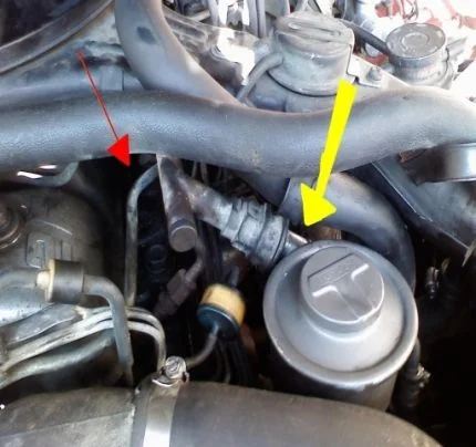

Hey guys... I rebuilt my ps pump. One problem though. I pulled a cracked hose (not related to the ps pump) from what looks like a horizontal rod running just above the intake. At the end near the ps pump, It has a hose going down to a vacume/valve type deal next to the ps pump. Well, I need this hose. Does anyone know what its called? Part #?
its connected to the frond end of the rod. The rod looks like its a fuel injection feed line... I know 2F's arn't fuel injected but none the less it looks like that.
Thanks... guys pls help cuzz my 60 is just collecting dust right now.:crybaby:
Air Injection stuff?
#60 in the pic?
I'll bet he is talking about #60. You can get it from specter, cruiserdan, or just use some heater hose.
yeah 60 is what im lookin 4. here is the pic(yellow arrow). I need to make sure cuzz I tried going to the parts dept. at my local dealer and the parts guys said to be sure cuzz it was like $79 and was a special order and it was non refundable.:mad: If thats the case I need to call the parts shaman. Or I will try to get a basic heater hose....
Oh and I noticed oil in the area above the intake (yellow arrow) Not alot but, should I worry? I will try to clean up the engine bay soon. That way I can see were all the leaks are coming from...
