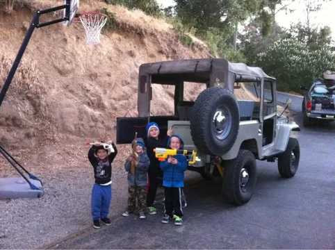

Just rolled up the windows and took the Munchkin Malitia for a ride.
Oh how I wish my top fit like yours...

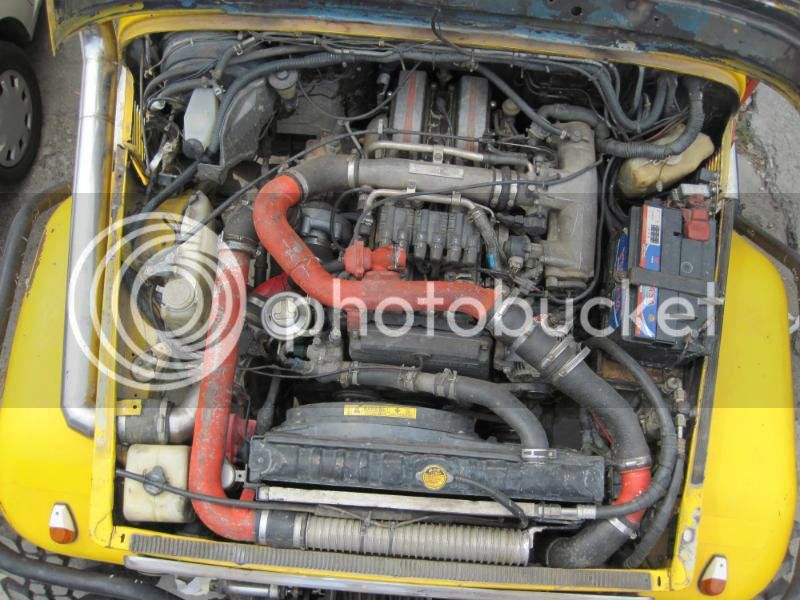

Delivered some more parts to my buddy and took the 40 back to the other workshop to have a little more welding done to the body mount location near the front left fender! Took a photo of the Supra engine while I was there.
Tell me more about the Supra engine swap?

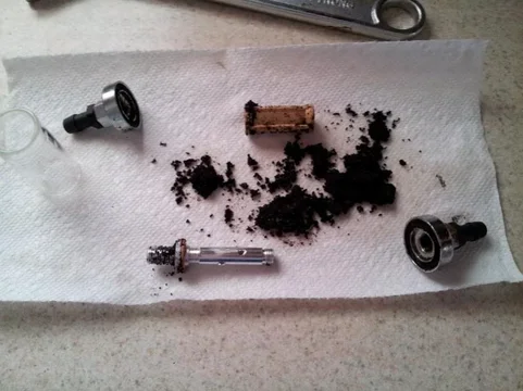

2. Figured out later that day that my gas tank was full of rust particles, which would completely clog my fuel filter in 15-20 miles. Top speed: 40 MPH, otherwise it would clog while driving and lose all power. FAWK!
3. Removed the tank, had it hot tanked at Blanco Radiator Service in San Antonio for $55. That included an inspection for holes and a repaint. Took them 24 hours and the tank looks great.
4. Installed the tank and made her maiden voyage on the highway to Austin. Minor overheating problem, but she could cruise at 60 (almost 70 with my rubber overdrive without a hiccup). FAWK YEAH!
