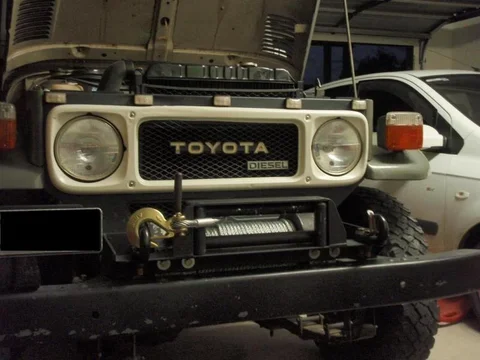

Front and rear bumper replacements
Replaced my front bumper with HFS and roller fairlead. Pretty easy install. PO had welded a crappy homemade bumper to the bumper etensions so I had to find replacements. Not as easy to find decent bumper extensions as I thought it would be!
Also replaced the crappy homemade welded bumper in the back with MAF 4+Plus bumper and fuel/cooler carrier basket. Really happy with the outcome.
Also added the factory taillights and fixed the PO hack job. Now they all work including the backup lights. Very pleased with the outcome.
Busy weekend but all worth it.

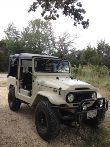

1. Passed inspection on Monday. HUGE COUP!
2. Figured out later that day that my gas tank was full of rust particles, which would completely clog my fuel filter in 15-20 miles. Top speed: 40 MPH, otherwise it would clog while driving and lose all power. FAWK!
3. Removed the tank, had it hot tanked at Blanco Radiator Service in San Antonio for $55. That included an inspection for holes and a repaint. Took them 24 hours and the tank looks great.
4. Installed the tank and made her maiden voyage on the highway to Austin. Minor overheating problem, but she could cruise at 60 (almost 70 with my rubber overdrive without a hiccup). FAWK YEAH!
5. Now getting the lift and Bilstein 5125s put on at Edwin's shop. FAWK YEAH x 2!
6. Edwin's is also draining away my radiator worries... :bounce: for getting the sludge out of there!

PS: What filter is that? It looks like a serviceable unit.
Is it suitable for FI use (high-pressure)?
Pablo, the fuel filter unit is completely serviceable. Very helpful when you are having problems like I did (the filter was full from inlet to outlet with waste in 20 miles of driving). The fuel filter units and additional filters are also sold separately, which is awesome if you don't feel like cleaning a filter on the road, just slide a new one on to the threaded and bored rod and slide on and tighten the glass casing.
And yes, it can handle FI.
Something like this: http://www.ooracing.com/store/index.php?act=viewProd&productId=907
But you can find them at O'Reilly's.
