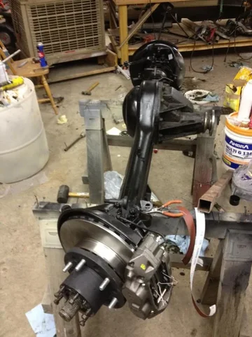

Picked up a rusty 78 axle in the Texas mud for $75 and spent the last 2 weeks tearing down with a rose bud and breaker bar, wire brushed it replaced all seals and put a 3.73 third in it.
Now I am ready to install under my 74 just a few loose ends to tighten up!

Good work!

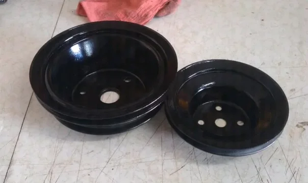

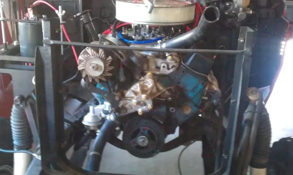

Tore the rebuilt ps pump back off because it was leaking, found the harmonic balancer was no longer aligned correctly. Orderd a new balancer from the damper doctor. Wire brushed and painted the crank and water pump pulley.
