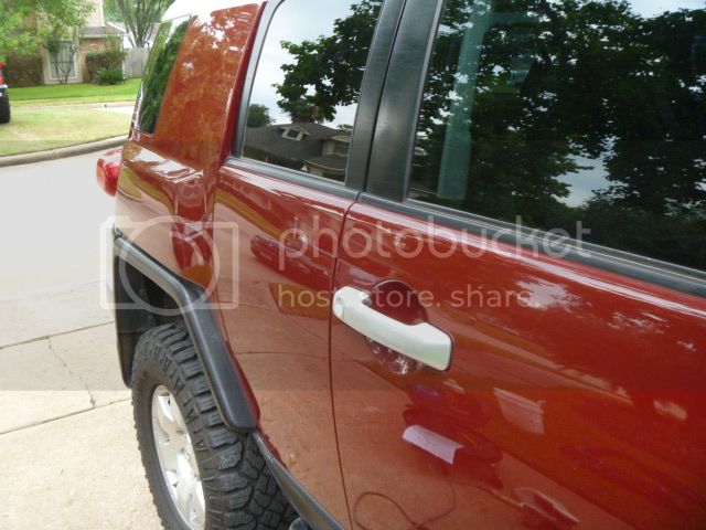

Here is one of the vehicles I did recently at my house to help a buddy out, 2007 FJ Cruiser with scratches that had scratches- took 6 hours but in the end came out great.
-OC
that is impressive.
