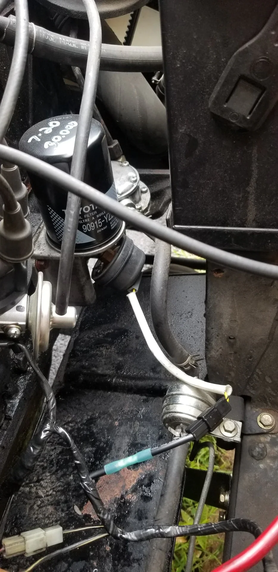

What gauge wire to use on a oil sending unit 2F
It's not a high-amperage circuit, almost anything would do. 14 AWG would be fine.
I looked on the wiring schematic and the wire should be yellow w/a black stripe, then looked Coolerman's website to see what he offers in that color combo, which is 16ga.
What gauge wire do use on a oil sending unit for 1975FJ 40

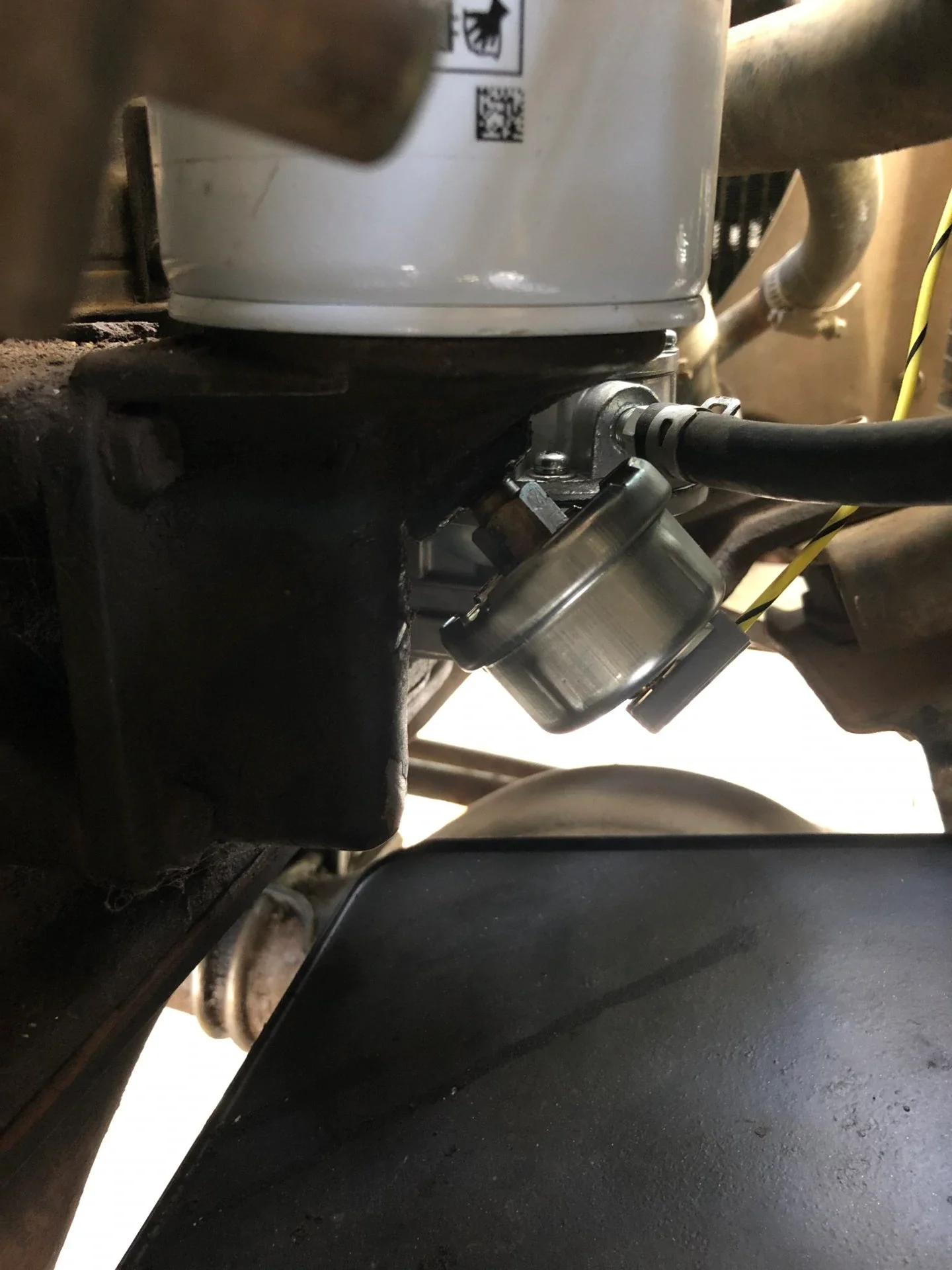

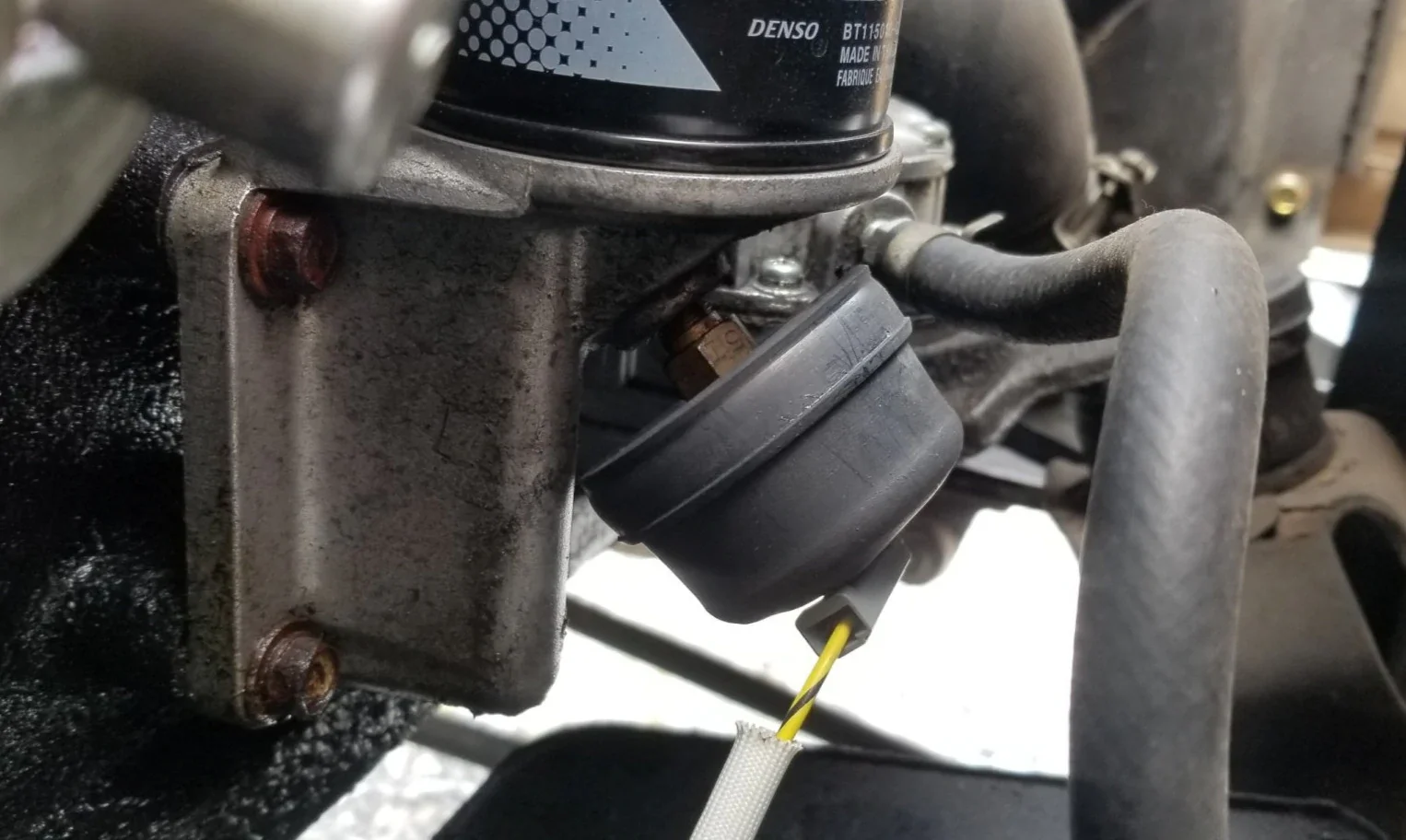

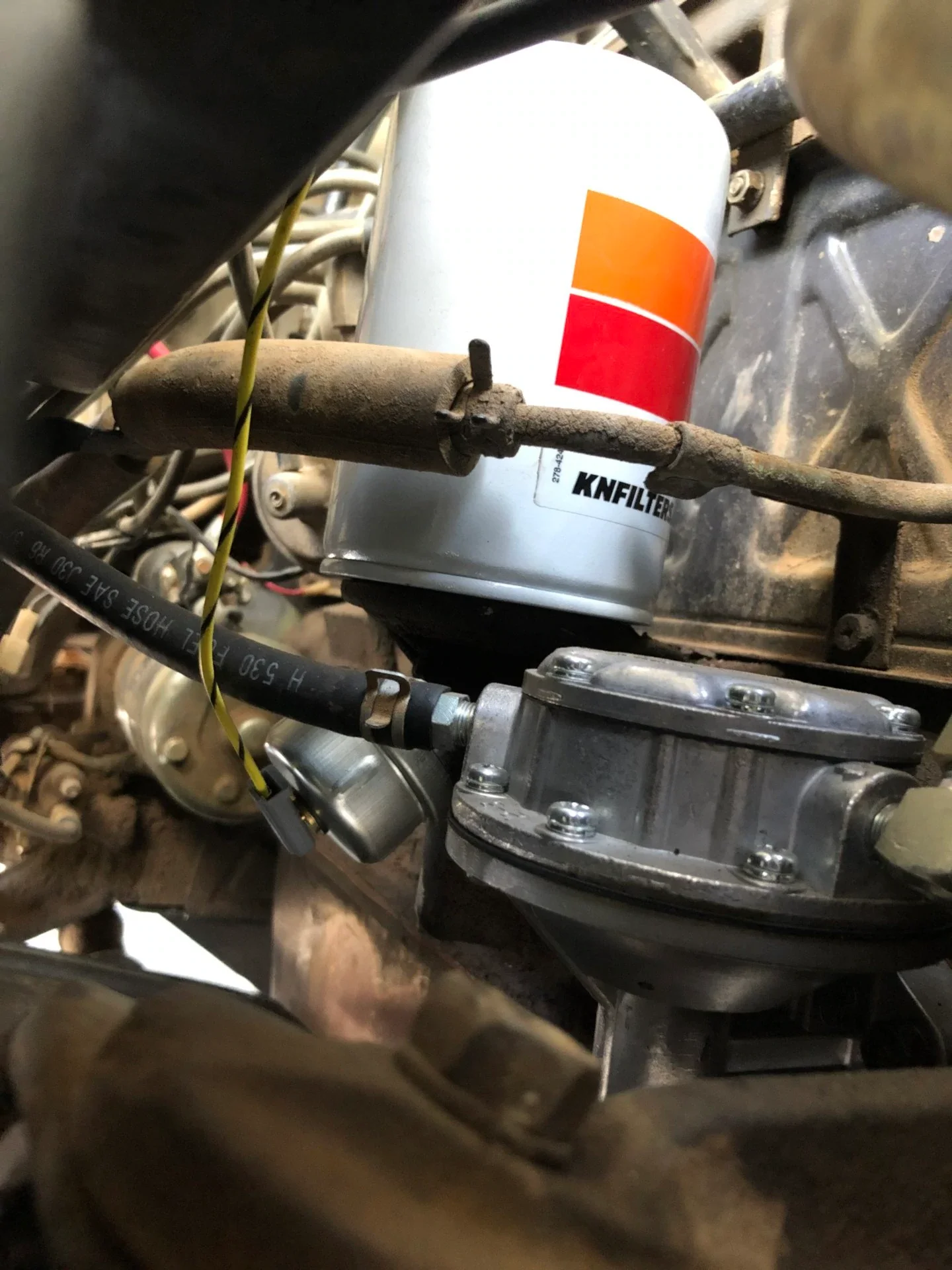

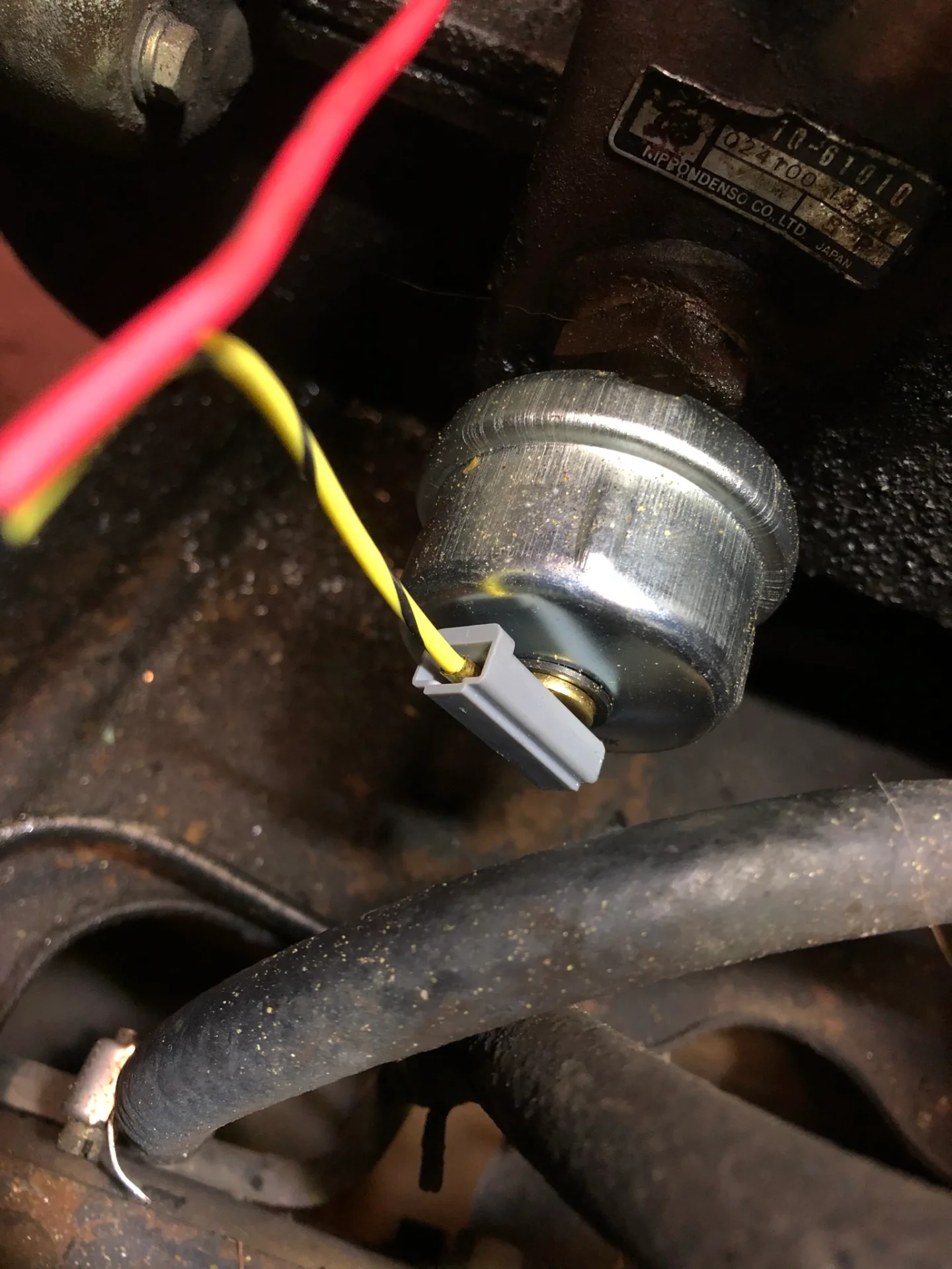

- Yellow e/ Black tracer stripe TOYOTA Vintage standard
- i use chemical and UV rated resistent 16ga oem was a puny 18ga and 20ga
- also , Super High Quality Reproduction
Engine Wire No. 4 Sender Boot Kits :
- a dual Tabs kit for the updated OEM Sender w/ a added ground TAB is available
