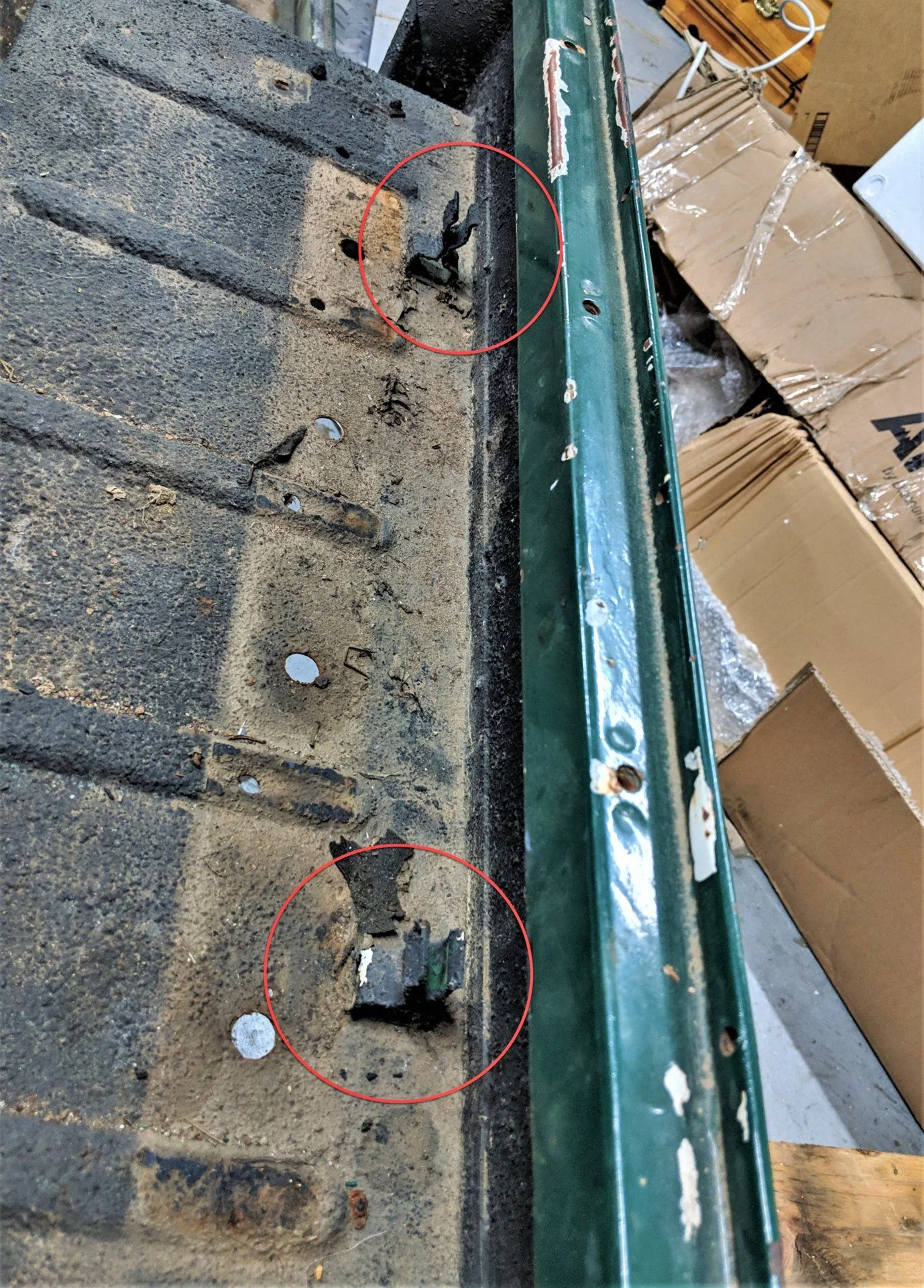

Not a ton accomplished today. I started pulling off the final bits from the tub. Tailgate is off and the bolts and brackets are bagged and tagged. Anyone know what this holder is for? It is on the passenger side wheel well.
full
I think those are soft top holders.
That's what I was wondering. I have never owned a 40 with a factory soft top though. I can't figure out why there would only be one set of these holders and what part of the tip they would secure. Very strange.
