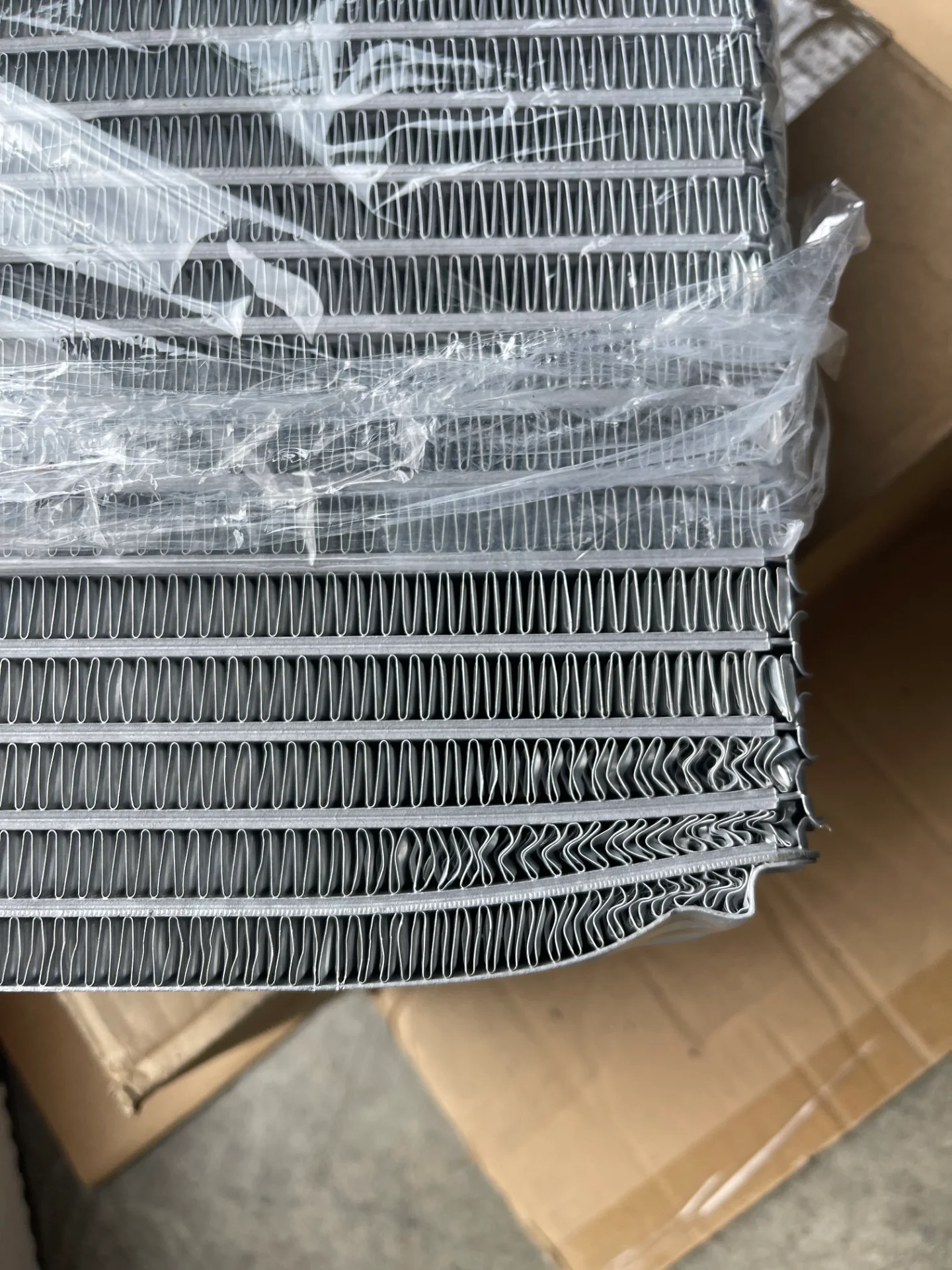

I’m replacing the evaporator and the expansion valve as well. Not too difficult to remove them. Unfortunately, rockauto sent me a damaged evaporator. Waiting for a new one. Being that it’s almost a 30 years old evaporator. Might as well replace with a new one.
I've ordered tons of Denso/Aisin stuff from Rock Auto. Delicate stuff like the evaporator always showed up damaged. They were always good about refunds, but I never understood why they didn't take the time to package things for shipping properly.

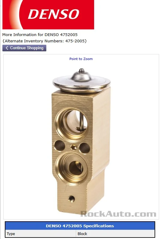

Mind sharing the part numbers?
Here you go: NISSENS 92107 Evaporator (Danish Brand). Few other brands but I chose the Nissens. DENSO 4752005, expansion valve. ACDELCO 1510044 Drier. 5 percent off, expires Oct 2nd. May work for you. Code: 350551265306332241. Thanks to @alia176.

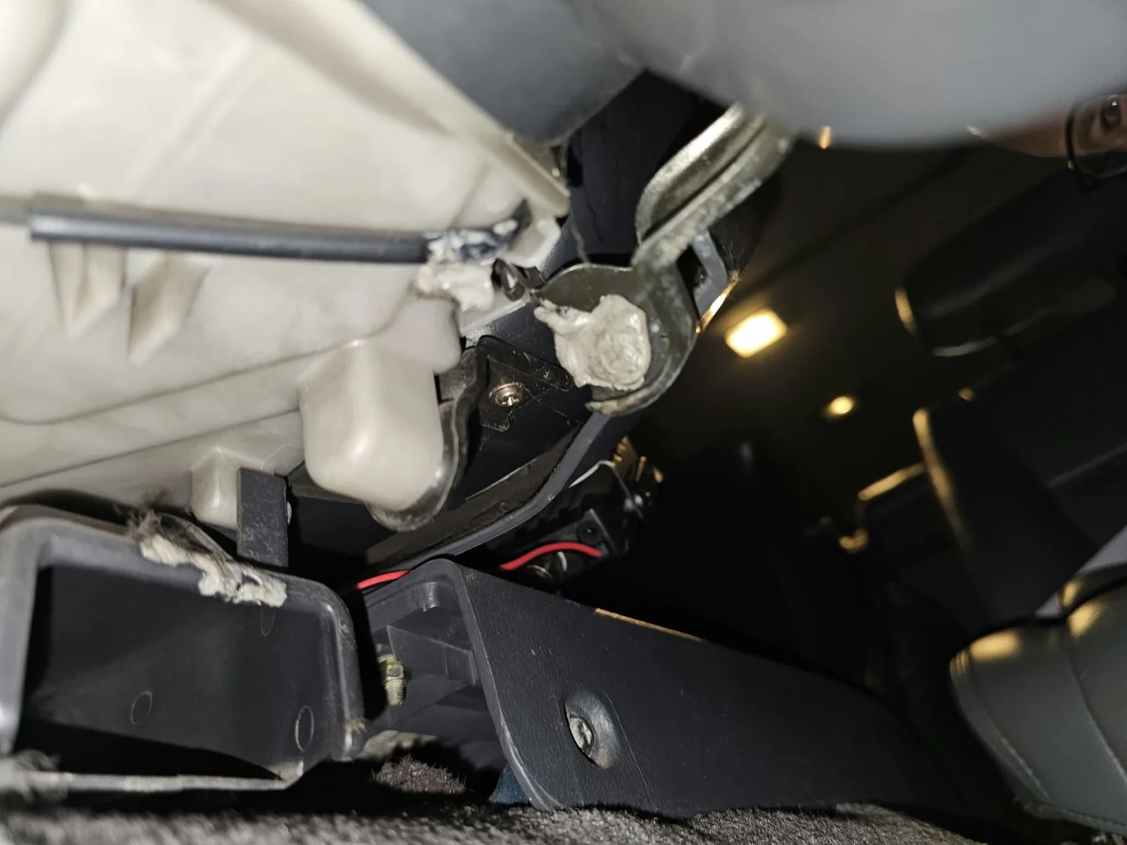

First and foremost, some cretinous reprobate toe-rag sat in the passenger seat long ago and stuck their USED CHEWING GUM under the dash, I found this as they had a great affection to sticking it INSIDE THE HEADS OF THE BOLTS I WAS TRYING TO ACCESS
Anyway I removed that with my teeth and carried on.
Removing the evaporator housing was honestly pretty straight forward, I did nearly have a cry when I just couldn't pop open the big wiring connector but a set of repurposed circlip pliers later and my eyes soon dried up.

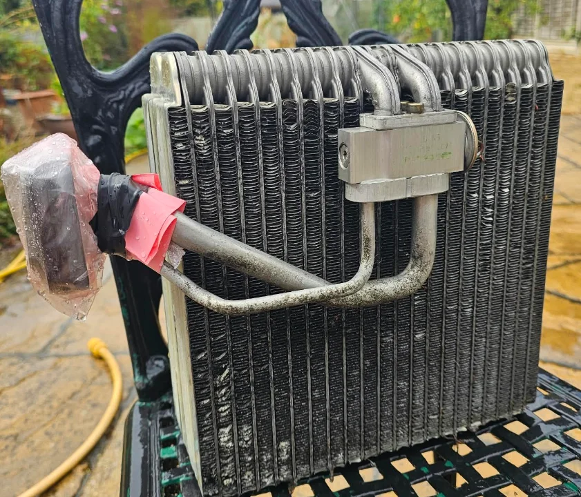

The evaporator, the valve, and the schmoo
It looks as though the system has never been removed, and honestly, that's not bad for some 32 years of schmoo collection!
View attachment 4205199View attachment 4205200
Given that the evaporator is in pretty good condition and a new evaporator is around £150 but a pressure washin' is free... I decided to just jet wash the 3 decades of filth out and carry on.
The water initially came out black, and it had a... smell, but after a few minutes of washing at (initially pressures high enough to bend the fins, which i later had to angrily yet delicately bend back) reasonable pressures the water ran clear and I could see clearly though the coil.
