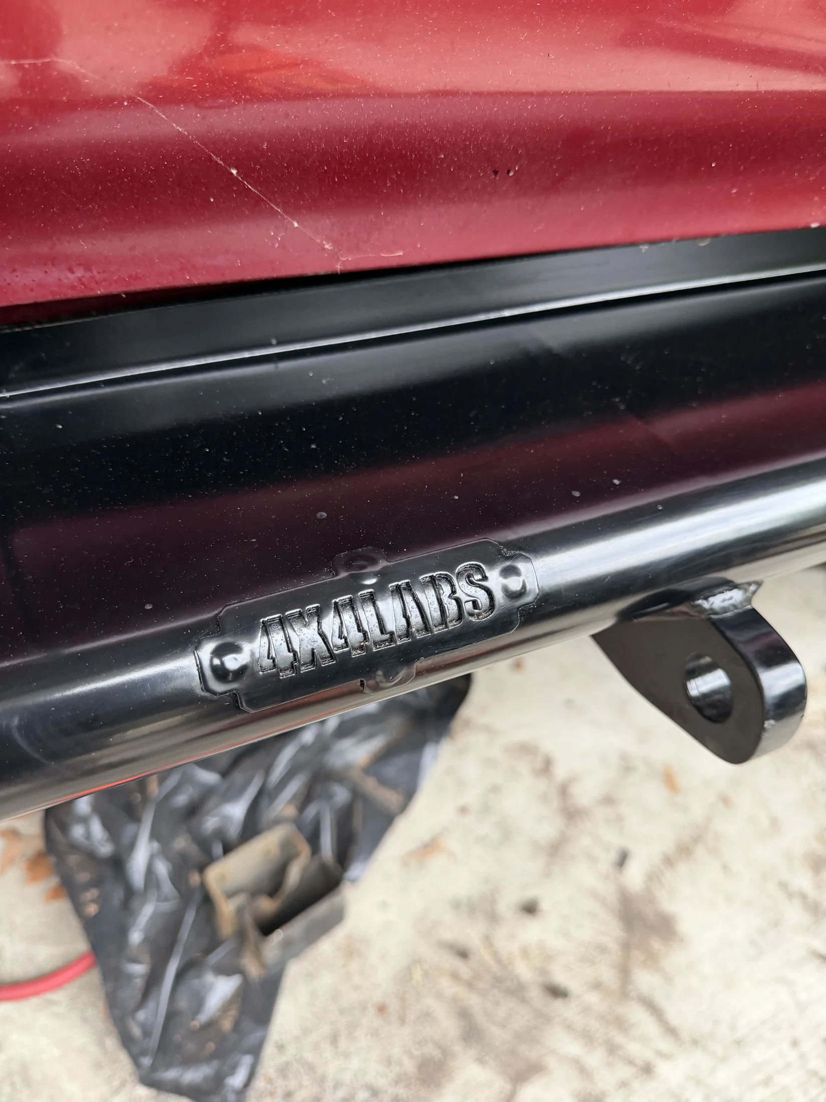

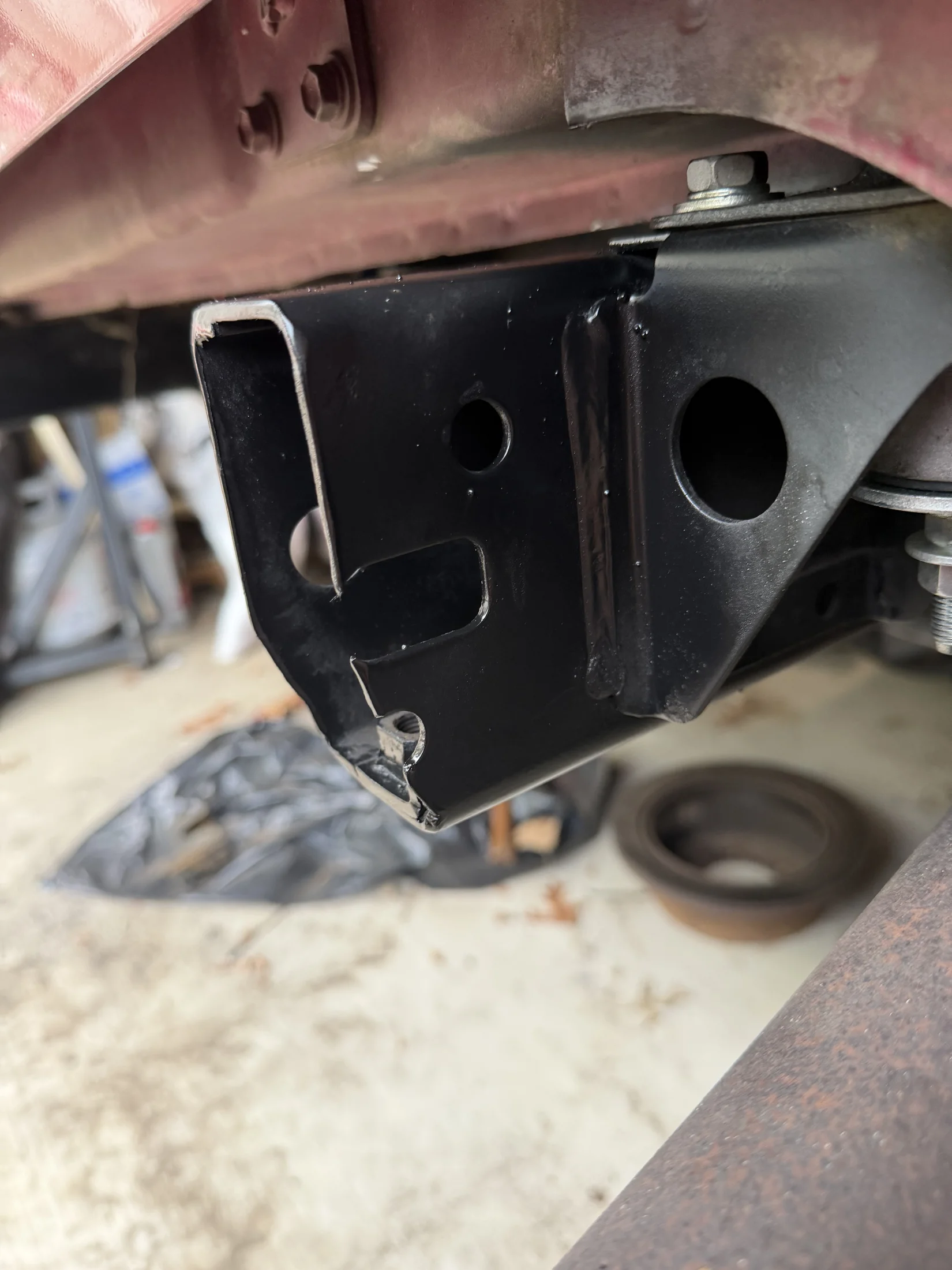

Got the “factory” rear bumper off along with the rear tire carrier that was apparently barely hanging on removed. Also, got the rear frame modified and the 4x4 Labs rear bumper installed.

I have both 4x4labs and Avid offroad. Both very similar in design but Avid has the better latching mechanisms.

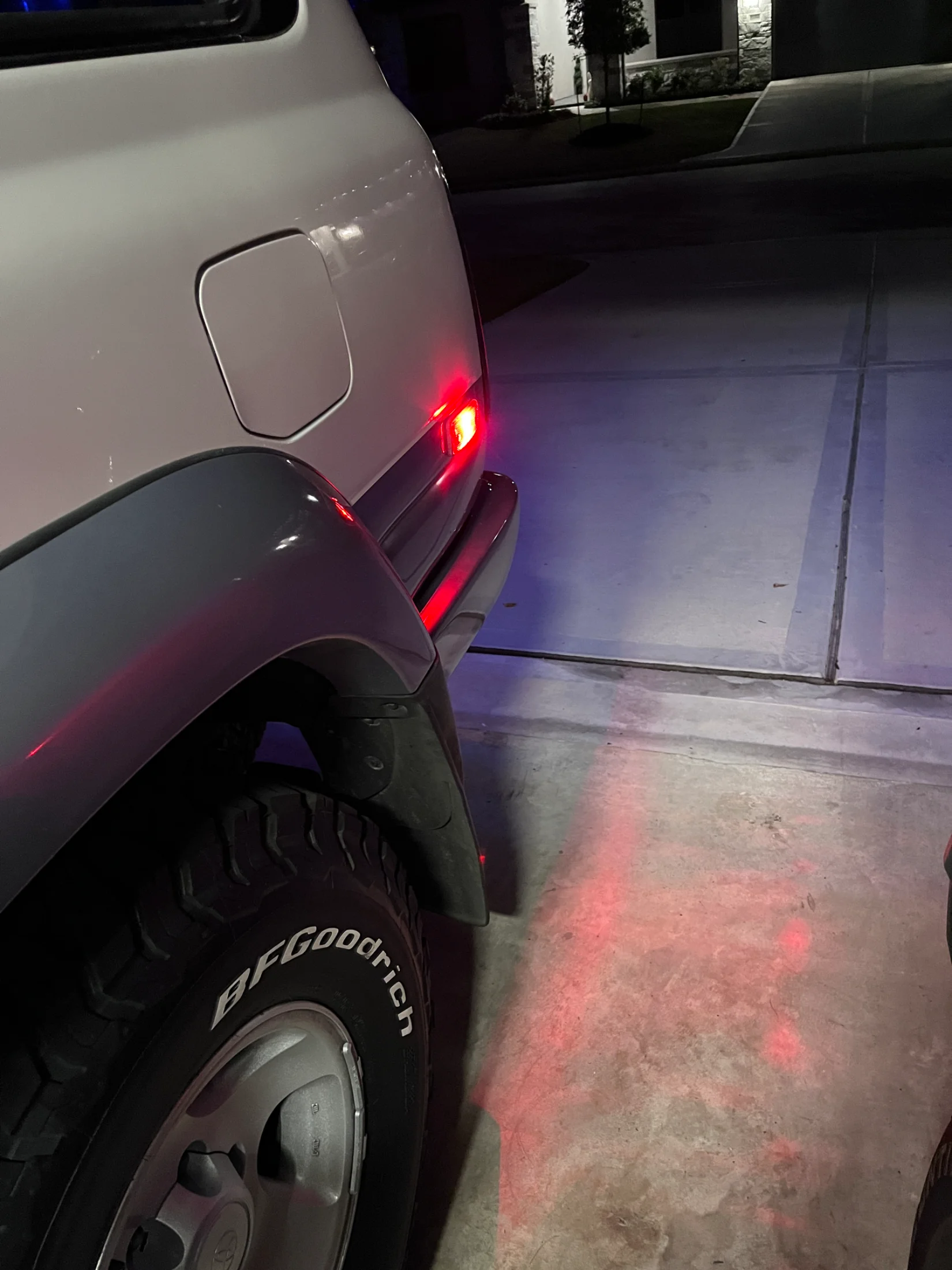

I did the same but used a $10 LED strip that I cut in two pieces and a waterproof switch.Agreed! I need to weld mine up that's in the garage now! @TRDdrew is patiently waiting for my Kaymar! @hisandhers80s you are a machine getting all of this work done...you've kept me inspired to keep up at less than half of your pace!
I've been doing tons on mine getting ready for my trip out to Cruise Moab in a few weeks...it should be about a 5k mile round trip. Finished platform/drawers, rewired dash for sub woofer & new locker switches, all fluids, and so much more....
Topping off my project list was the TEQ Offroad under hood light strip kit...nice harness and quality led strip, installation was a breeze. I wired up to my secondary battery and just did the switch (omitted the plunger). This is in my pitch black garage, only light is the strip...impressive!
