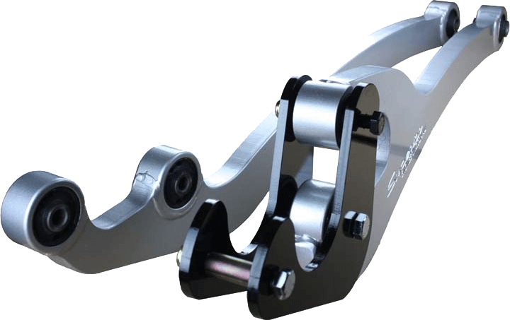

Superior arms work differently than stock or Delta, relocating one of the axle mounting points to work in a different plane. There is a pin that can be removed for off-roading that disconnects one of the mounting points, unlocking lots of articulation of the front axle. :D
The hyperflex arm setup I run is 2 of the arms you posted above, on the right, that have brackets which relocate where the arms attach to the axle to the rear- instead of underneath. This massively reduces radius arm bind when articulating, and no sketchy pin to pull.
