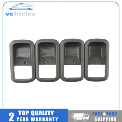

looking for right vent louver or both and interior gray door handle frames (just the rectangular part) if you have any of these for sale.
got mine at eBay - 30 bucks for 4 of them door handle things
What color are these? Tough to tell in my phone.
