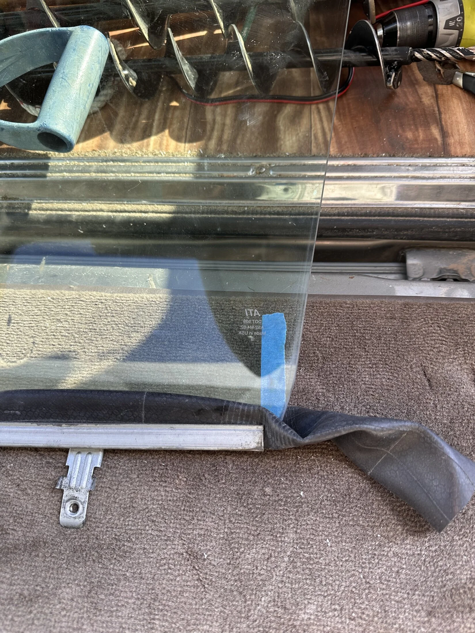

View attachment 3835267View attachment 3835268Trail fix. My passenger door just opened when I lowered the window, lol. I used the switch to lower the PS front window and “clunk” the door opened.
Turns out the window came out of the channel keeper at the bottom. The PO appears to have used black window mastic to glue it in rather than get the replacement filler.
I was able to pull most of that mastic out.
To get back on the road, I cut up a spare MTB inner tube and hammered it back on the glass. I tried to mark the prior location of the channel with tape. Hopefully I’m close, don’t have the FSM handy for measurements. Seems very secure actually…Gonna trim the inner tube and get the glass back in.
Will be replacing both channel and the rubber filler. Hopefully this gets me home. Good times.
The scariest thing I've ever done working on an 80 was pounding the rear door glass into the that channel with a hammer...the first time. That's really strong piece of glass.
Ha ha. I just wailed on it with a rubber hammer…thought that I should have spritzed it with some soapy water about 10 whacks in but was committed at that point. In retrospect, it did feel sketchy.

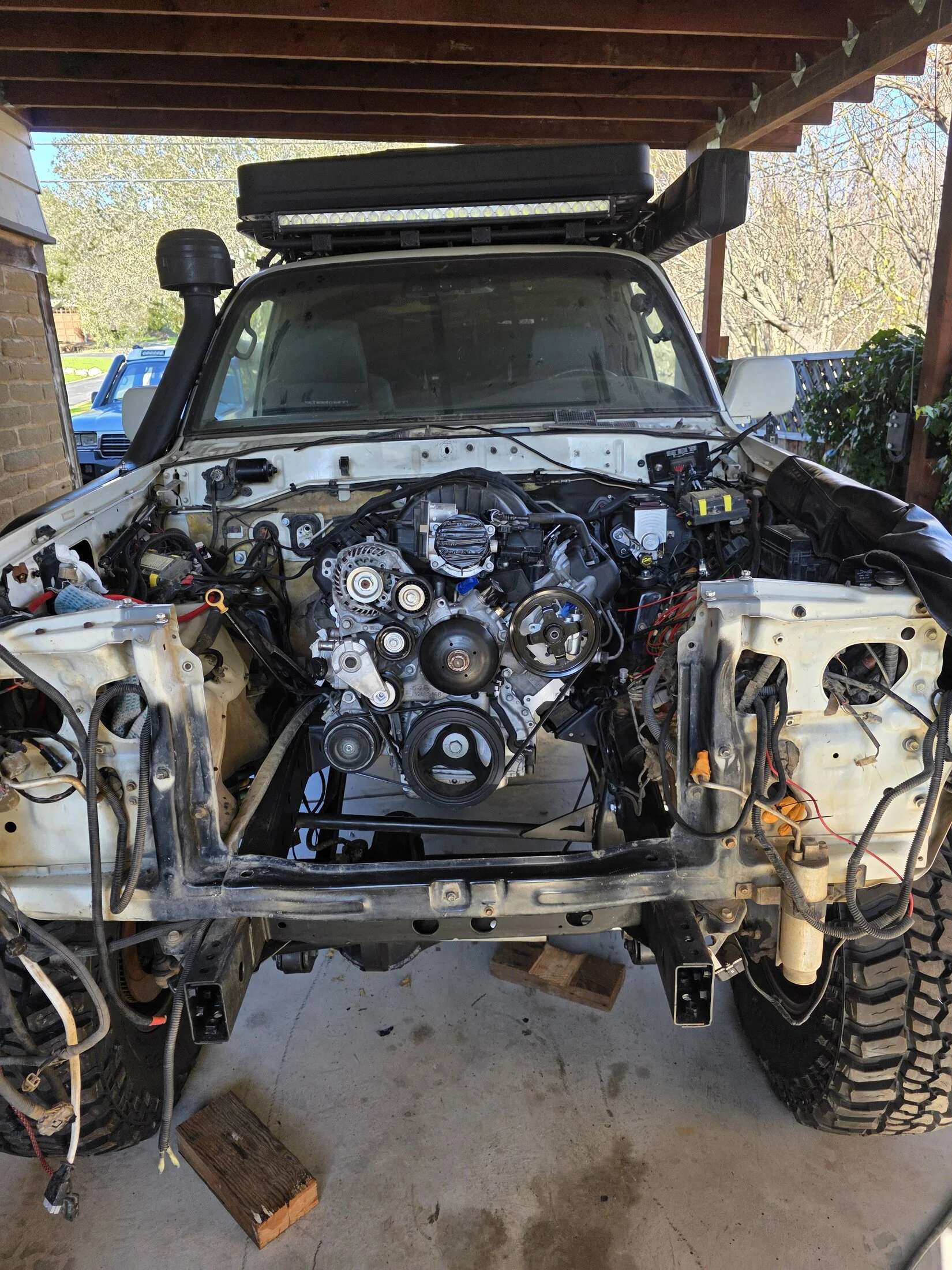

Helped Joe put in a a monster LS 6.2 in

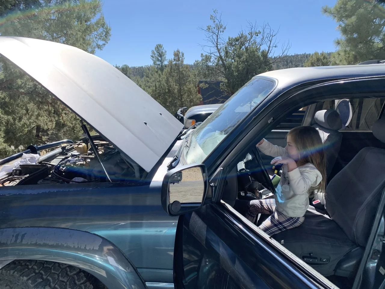

Had a lot of whining on cold mornings…. from my power steering. Not just from my kids 😂. Flushed the power steering fluid with the help of my 4yo daughter and my 7yo son. Jacked up the front and rested the axle on jack stands. Disconnected the return line from the PS reservoir, poked a clear hose down into the return hose, put an empty ATF bottle under the metal nipple of the reservoir and got to turning the wheel.
After cycling the wheel back and forth for a while, I started adding fresh fluid to the reservoir. The return like started spitting out pink/red fluid into my catch can. Topped the system off and started the engine. Added some more fluid until the whine went away. It’s good to go.
