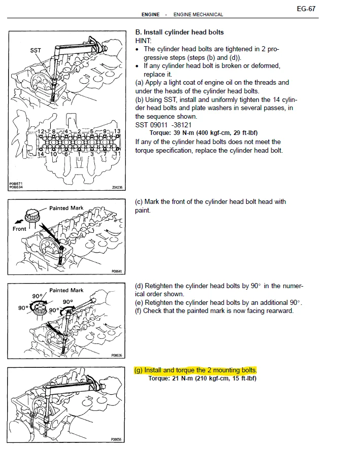

reassembling the engine. Can't seem to find the 2 mounting bolts for the front of the head. I have all new head bolts, but the two in the front I must have misplaced. Does anyone know what size they are, or where I can get a replacement? View attachment 3834480
@Corky1936 call the dealership Monday; they should be able to have two for you next day.

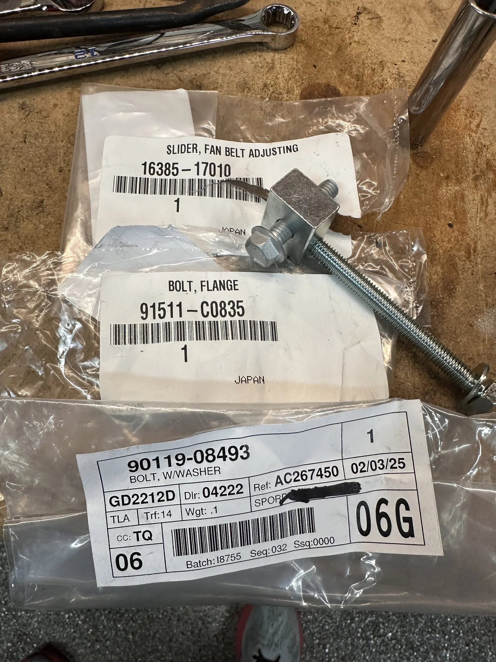

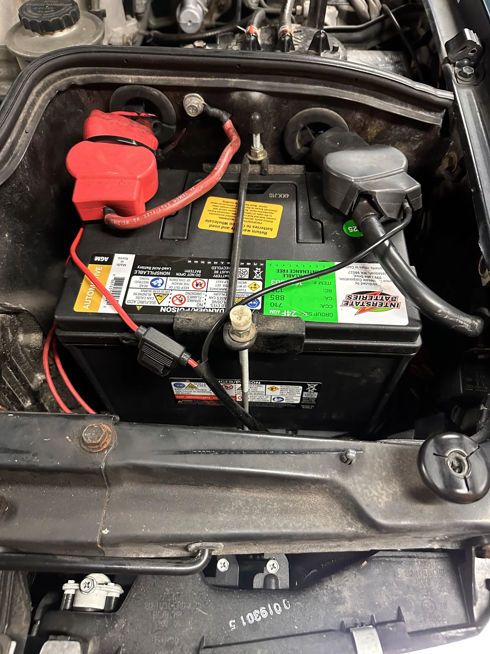

New alternator and adj hardware as mine was not charging anymore. I’ve never touched this one and the label said Toyota Denso built 04. Don’t know if that is the year made? I bought the truck in 2012. Also chucked in a new battery at the same time (removing battery and tray made alternator swap easier) as I noticed it was 5 years old. I swear I just bought it. Funny how that happens. Didn’t do belts because I did them a year ago. When with AGM 24f Interstate from Costco. $179
Anyway in an effort give back to the forum here are some charts and part numbers for the next person.

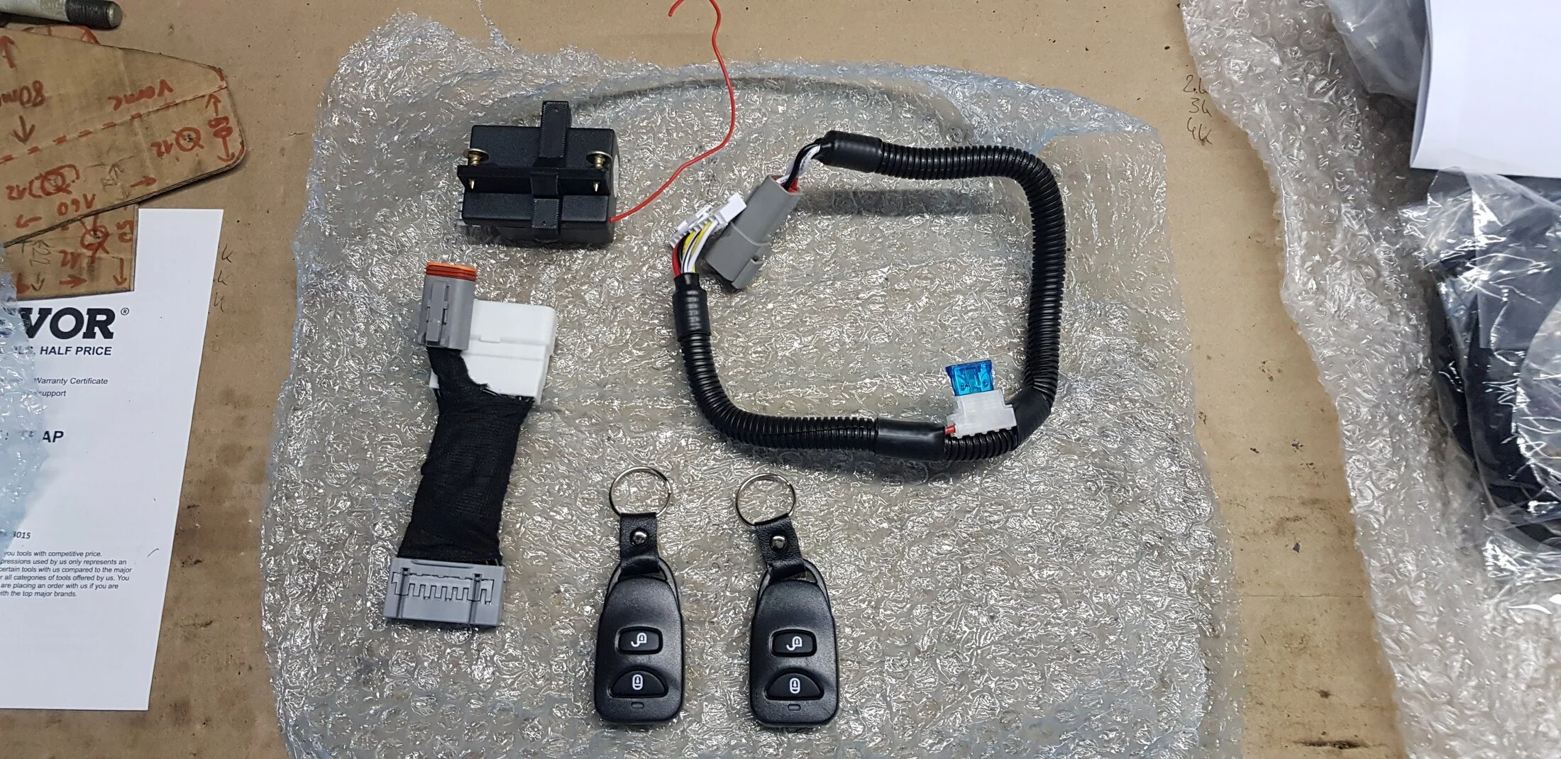

Our Trail Teq plug and play remote entry system should be showing up on Monday. Excited to get it plugged in, it will be a real nice quality of life upgrade. Thinking of getting a new LC model steering wheel and trying their steering wheel control wiring down the road some time.
Hi,
installed the Trailteq kit as well this weekend, super easy to do and completely plug and play.
Anyway in an effort give back to the forum here are some charts and part numbers for the next person. View attachment 3835047View attachment 3835048View attachment 3835049View attachment 3835050

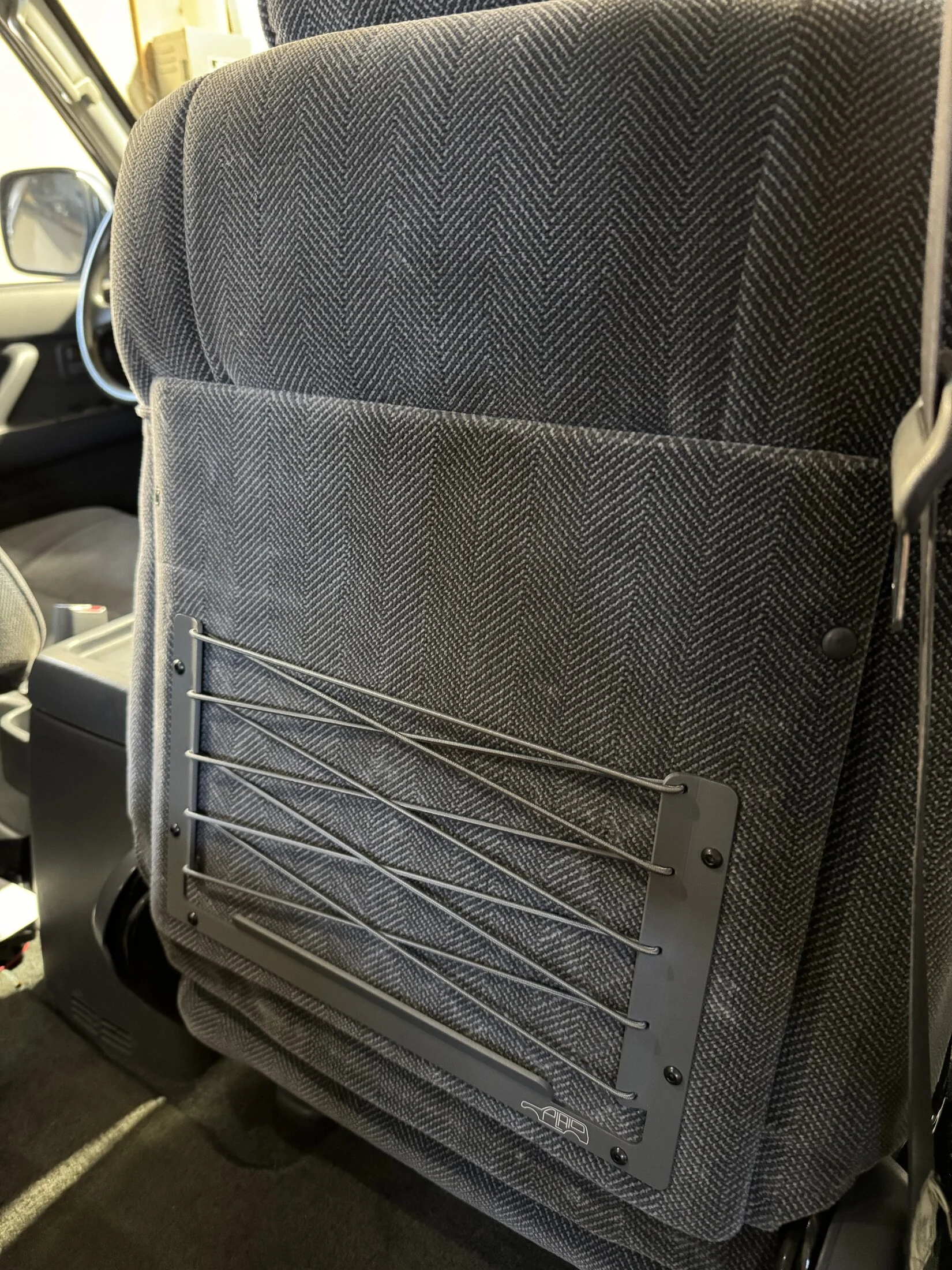

Replaced the dying seatback nets with these from @plaidwagon . Waterjet aluminum and press braked with some replaceable parachord.
I looked into OEM but for $100 + shipping I figured I might as well look into and upgrade and came across these. The quality, simplicity and longevity are a great addition.
