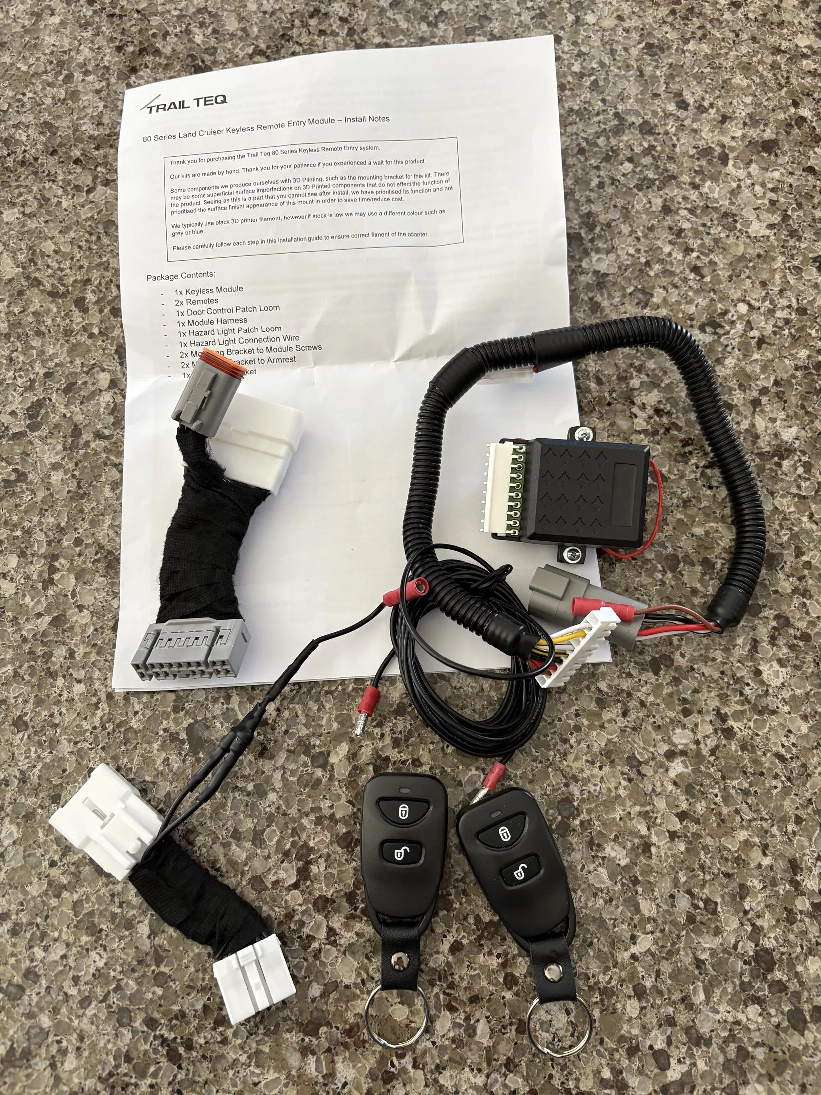

Thanks to @ore
I hope its as easy as you say!! My weekend project…
I'm not particularly handy and it took me about 10 minutes. Most of the time was actually spent putting the crappy door card back on. Mine is in pretty bad shape and is missing many of the plastic clips.

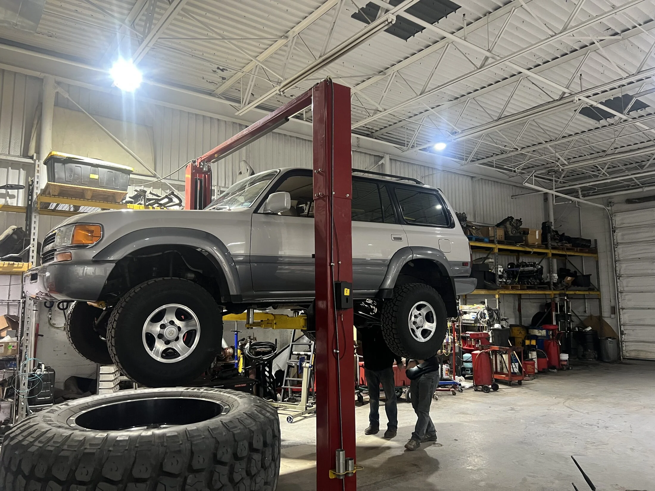

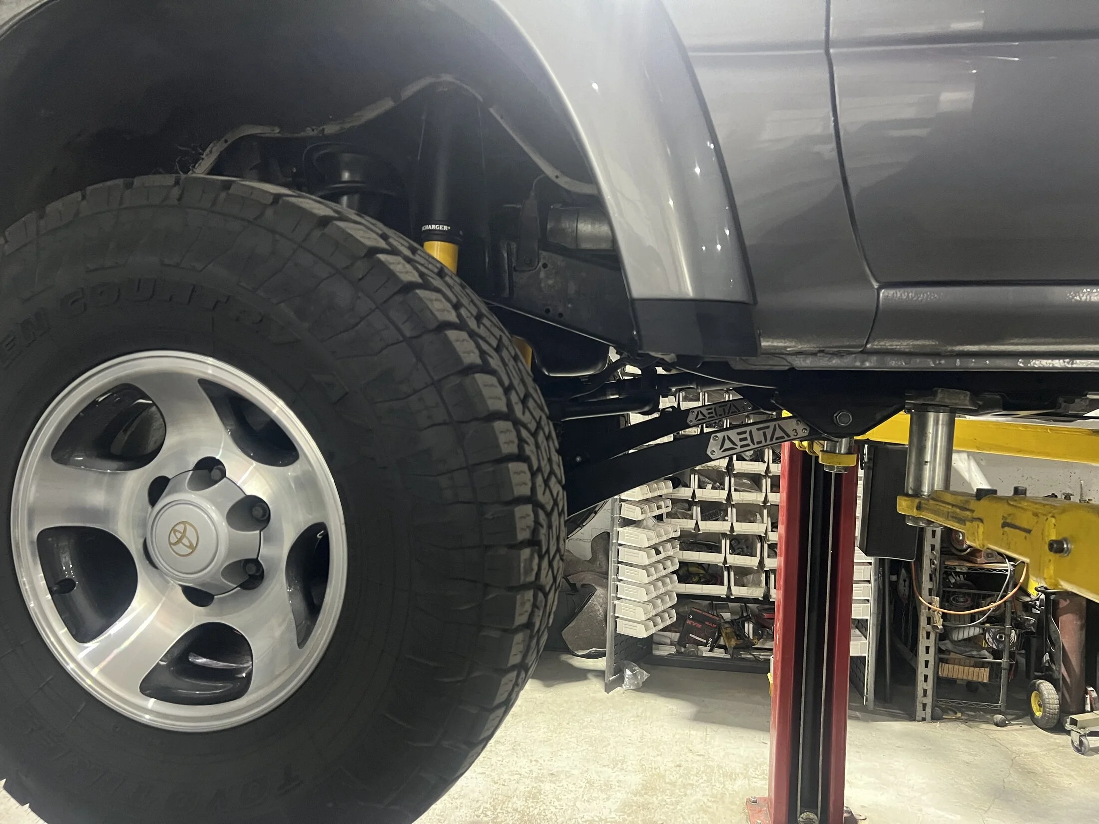

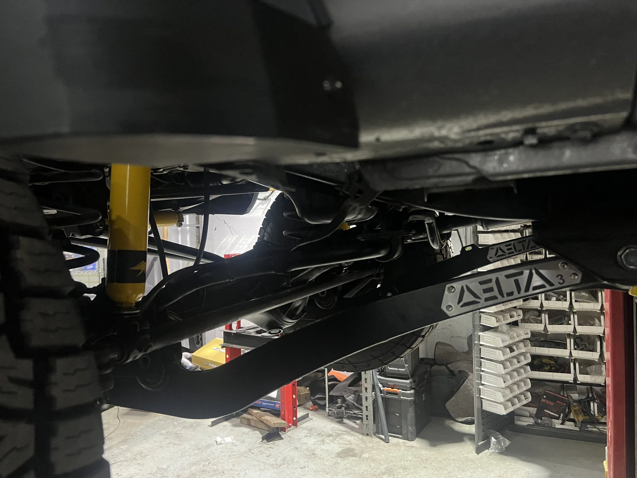

you will like the delta radius arms (although they are pricey)
I’ve only had them on the truck for the drive home, but I will say this…once I get to 65–70, the vehicle just stays put…no more darting around like a young dog on a leash in a park full of squirrels! It’s amazing…i feels like I’m driving a factory suspension.

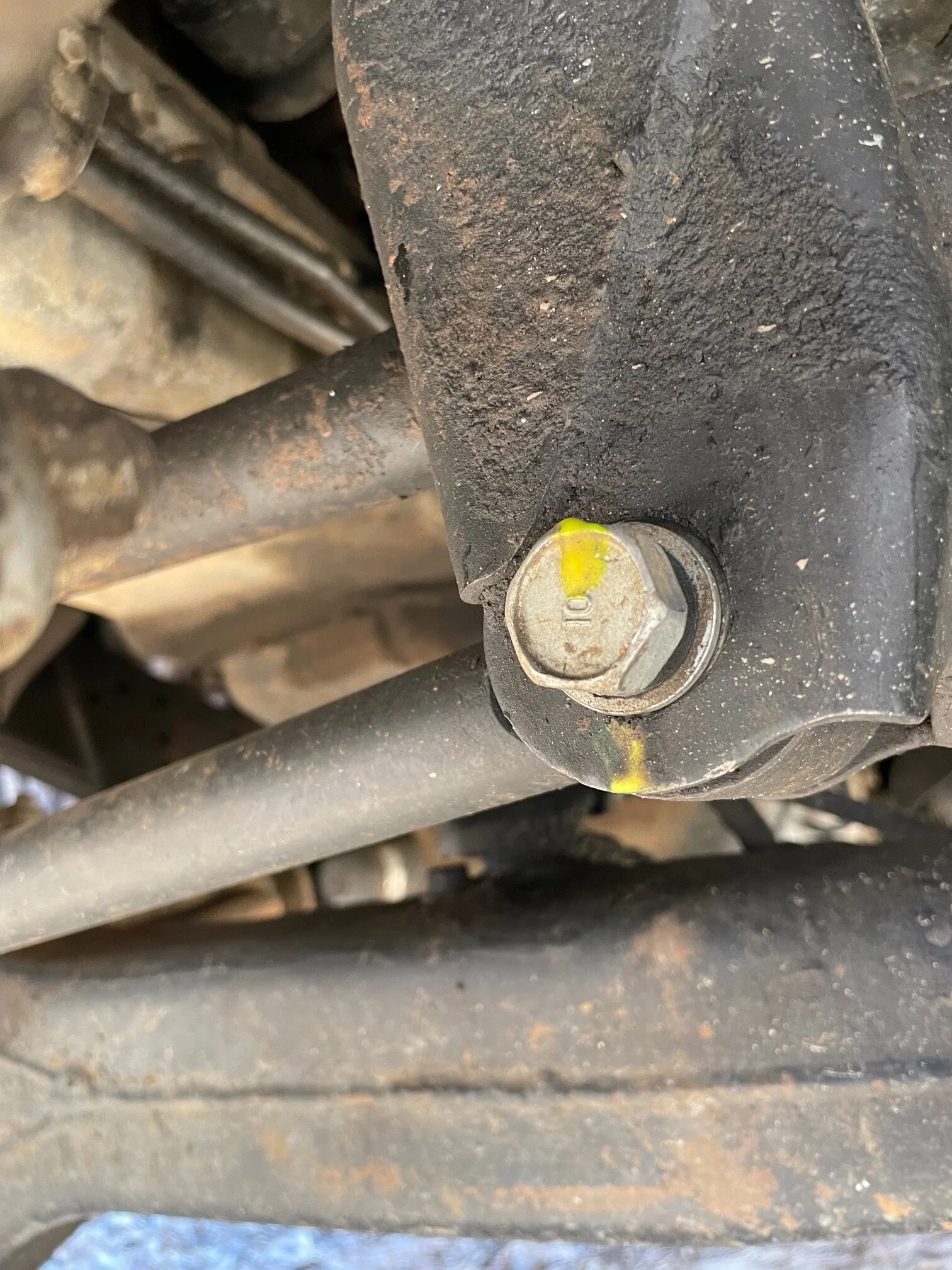

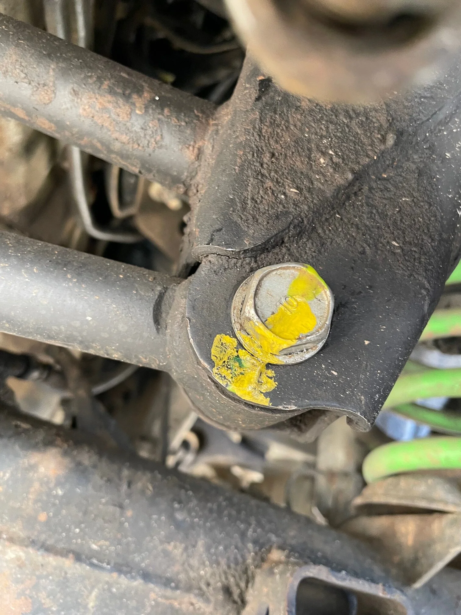

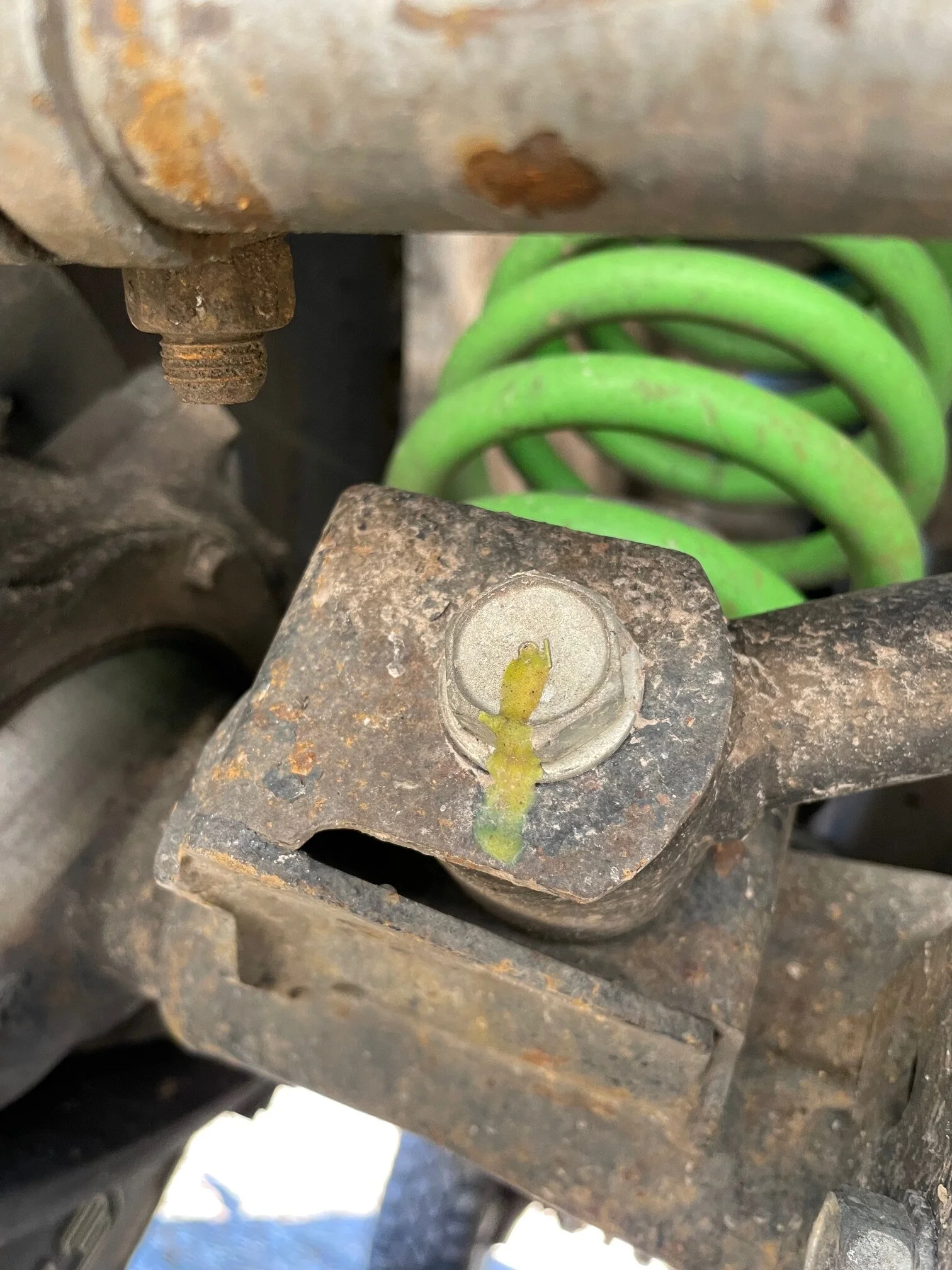

Driving the 80 yesterday there was a very light fluttery sensation in the steering, but only at a certain point in steering right to left, or left to right. I checked wheel bearings this morning, both fine, but while under the Cruiser noticed that the upper panhard bolt had backed out. The nut was loose. I replaced all suspension bushings last year and marked heads with torque check. The loose bolt head was obvious. I had torqued this bolt to the correct setting, I think. Went back in and hit it with the impact this time and remarked it with paint. Passenger side bolt was still tight.
