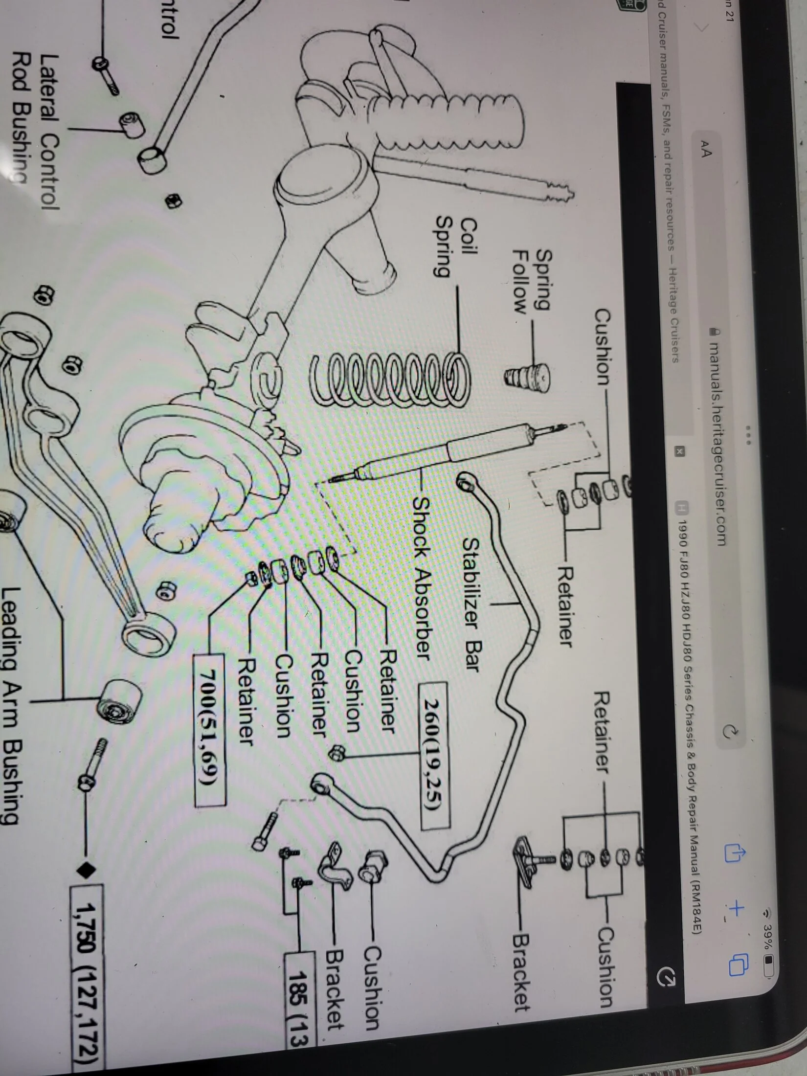

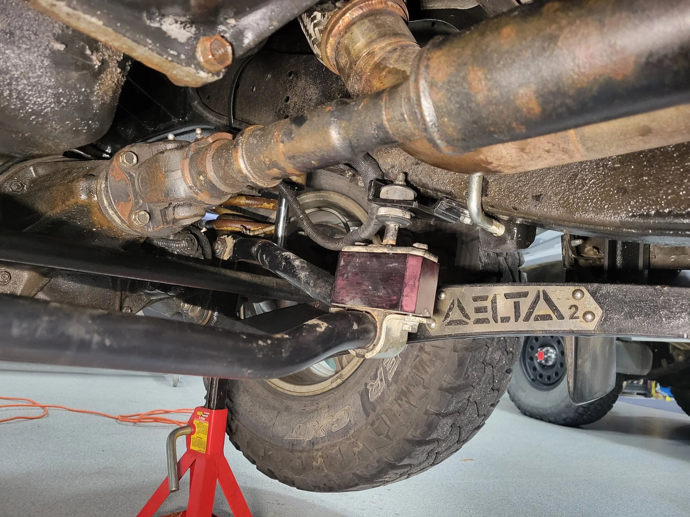

Looking for some help. Had some new front swaybar brackets made and I am currently installing the swaybar. This is on a RHD 1990 hdj81. The way I have it on is the way it came off but brackets were broken and it was half hanging so one wonders if this was on correctly. The other picture is from the FSM and it looks opposite. Truck is new to me so I don't even know if this is the factory swaybar, it does have the slee bracket extensions. Can anyone confirm which way is correct?
Looking for some help. Had some new front swaybar brackets made and I am currently installing the swaybar. This is on a RHD 1990 hdj81. The way I have it on is the way it came off but brackets were broken and it was half hanging so one wonders if this was on correctly. The other picture is from the FSM and it looks opposite. Truck is new to me so I don't even know if this is the factory swaybar, it does have the slee bracket extensions. Can anyone confirm which way is correct?View attachment 3821302View attachment 3821304View attachment 3821305
IMO that's not the correct sway bar.
Appears to be aftermarket, but I agree, that orientation seems to be correct.
I agree the profile looks different altogether than FSM. I think the way it is currently installed makes the most sense to clear the driveshaft though.
Again IMO the front sawyer bar is not as important as the rear as the front control arms act as sway bar. Many my self included run without the front.
You might try removing it and see how you like it.
Thank you and Heckraiser for helping. My truck is pretty heavy and although it feels great on road without the swaybar, I think these slinkies and icons are too light for good onroad performance. It sways a lot when turning onroad.
The bent driver side mount and the swaybar not being parallel to the tie rod is alarm to me. I would try to find a OEM one or one that fits correctly.
Looks like a correctly-installed Whiteline heavy duty to me.
Did more research and I think you are exactly correct. Interestingly reading past posts it sounds like a lot of users have issues getting it to be centered, often being closer to one radius arm or the other. Mine is a bit better that way after some road testing. Now I'm worried about failure of the front axle sway bar tabs and considering purchasing these land tank heavy duty ones.

I had the Whiteline, and I broke the tab on the DS. I installed Land Tank tabs and downgraded back to a factory bar, plus the LT disconnect kit. I assume my supercharged gas engine doesn't weigh as much as your diesel, but I'm very pleased with the setup. I wrote a review thread on the tabs and detailed the install, if you're interested.

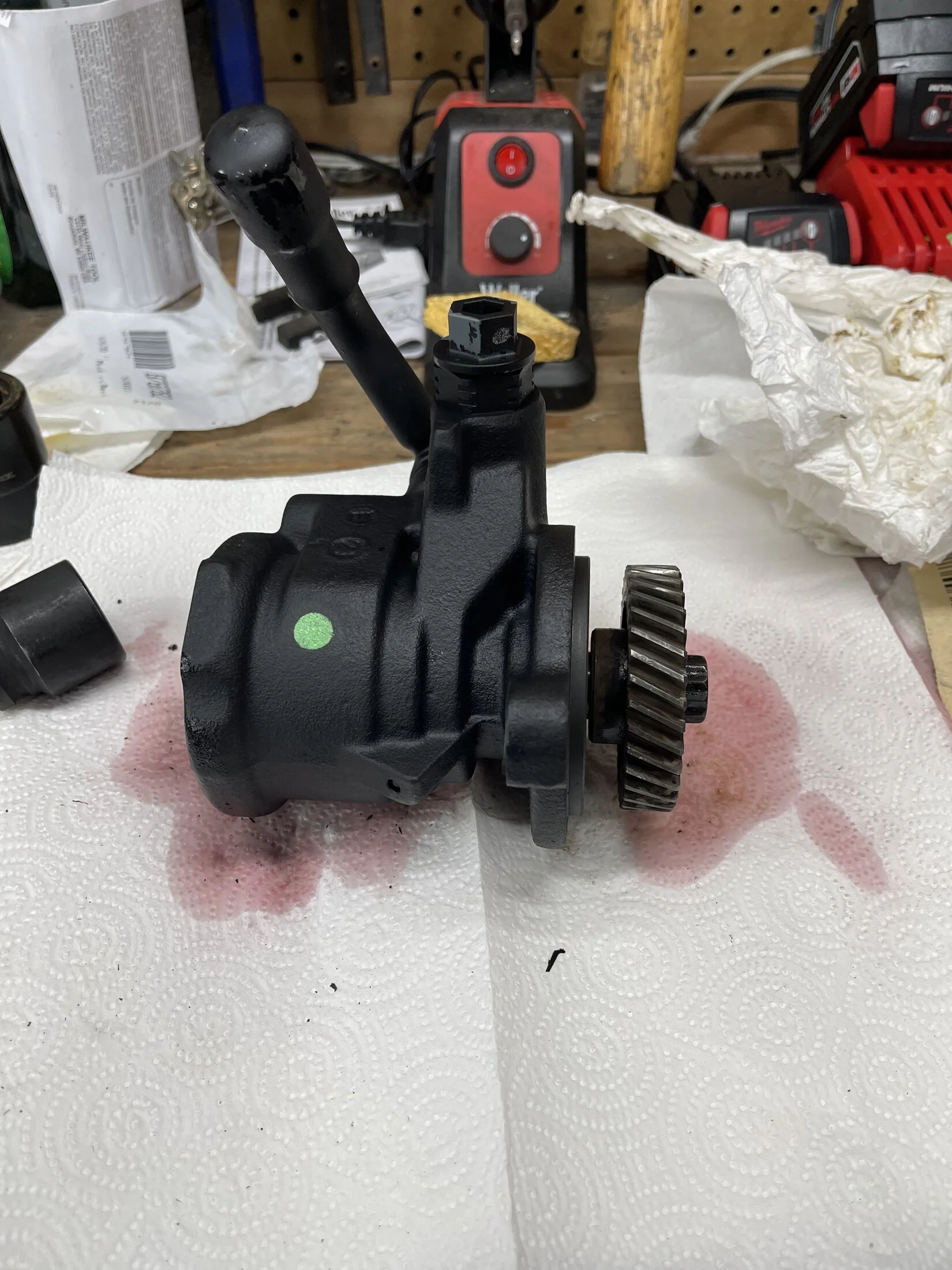

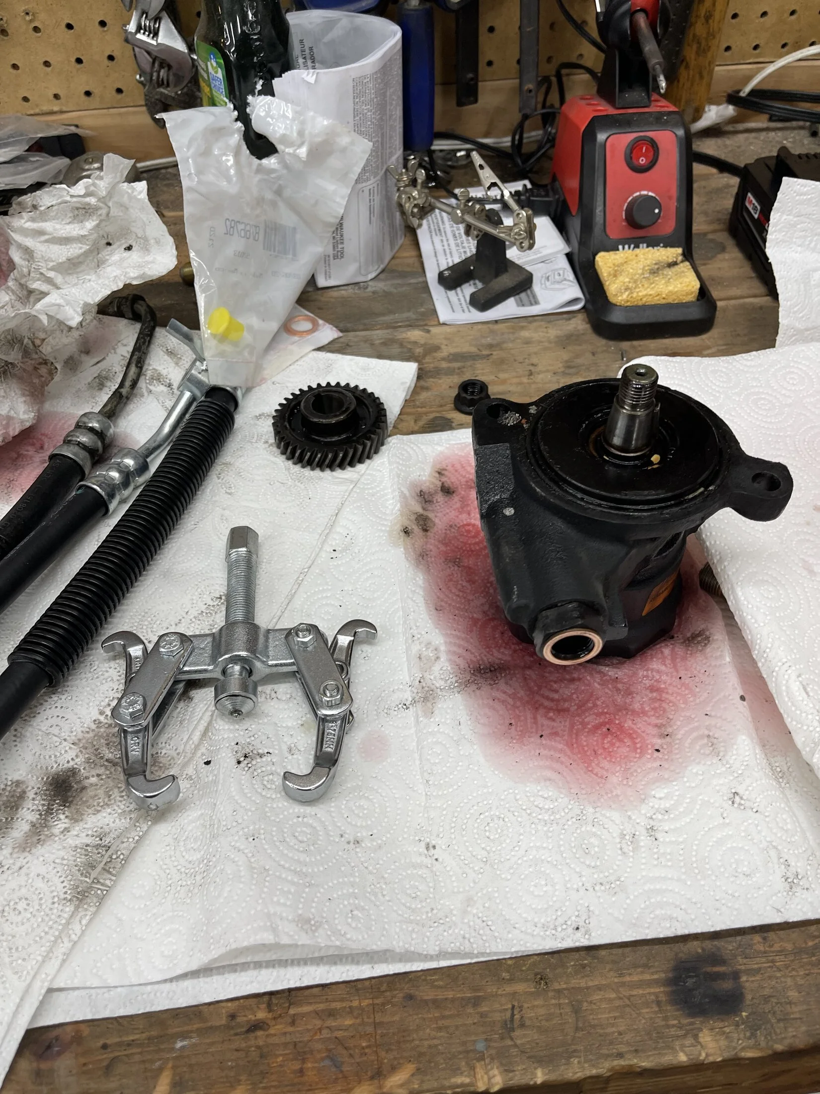

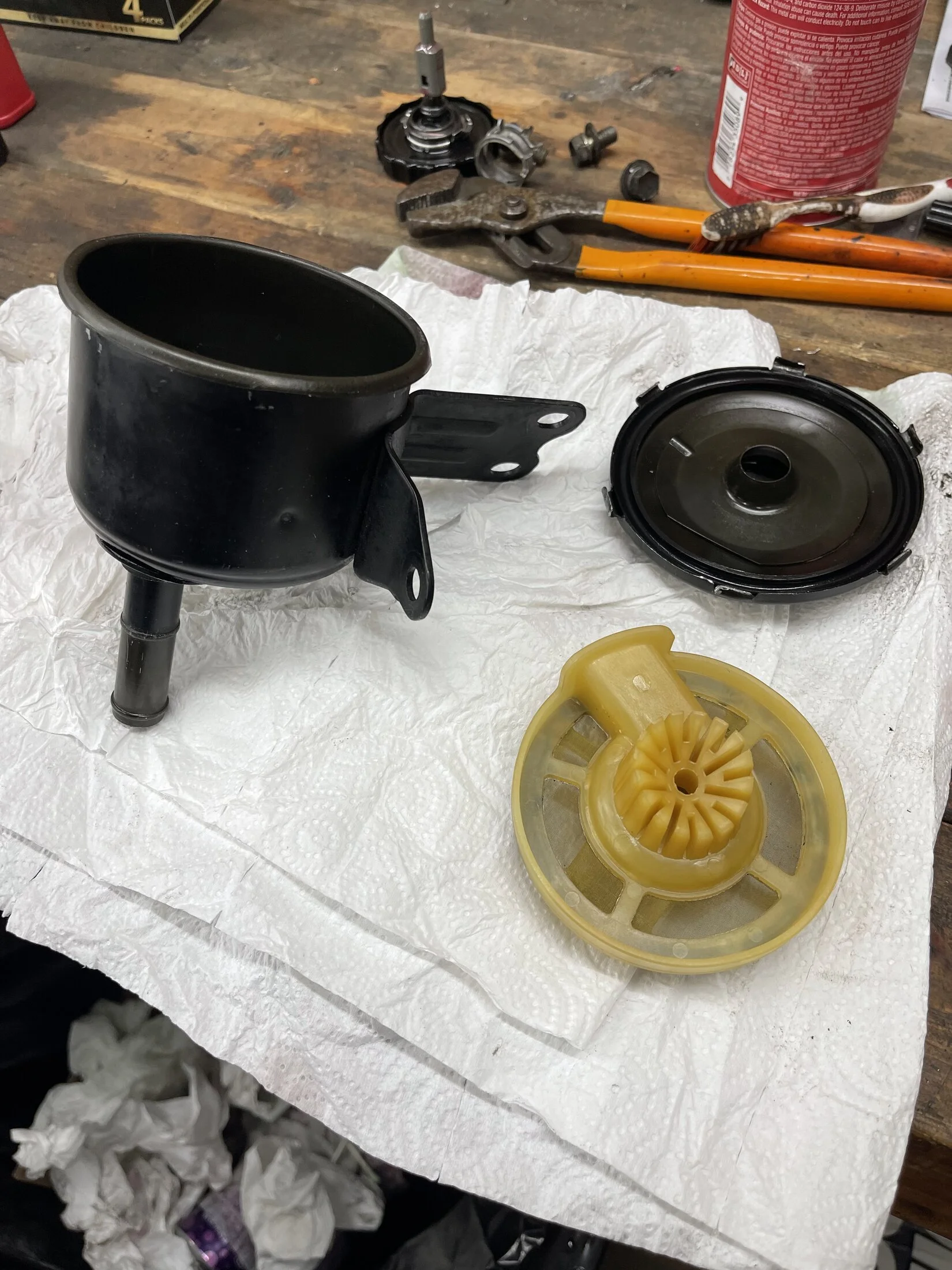

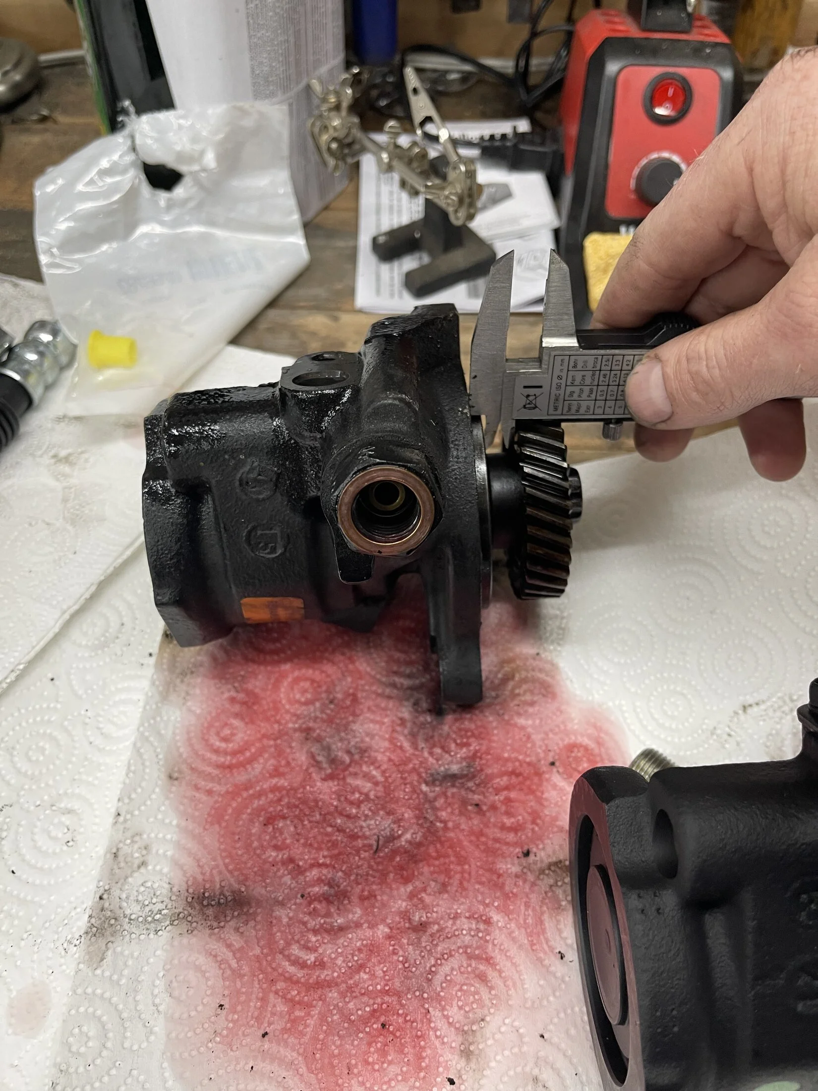

Starting my power steering system overhaul. I got the PS gear moved to my new pump and reattached it to the block. Took a measurement and got the gear within about .02mm of the old. It actually went on most of the way without any more tapping down. Waiting on low pressure hoses and I'll button it up. Reservoir screen was pretty gunky which may have been causing my whine but I like the idea of an OEM pump on it vs the reman unit it came with.
