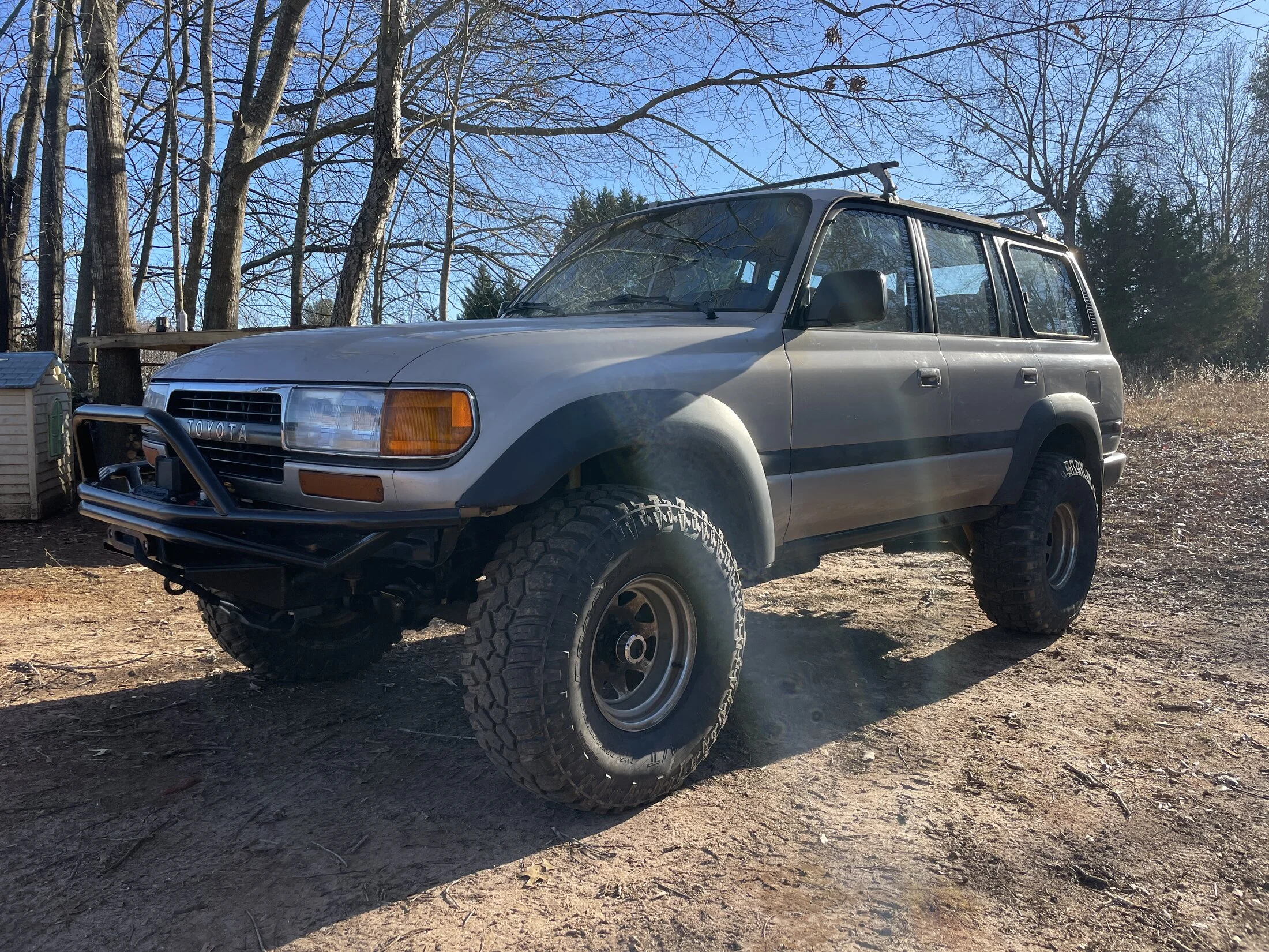

Took it out to stretch her legs since relocating to NC from WTX.

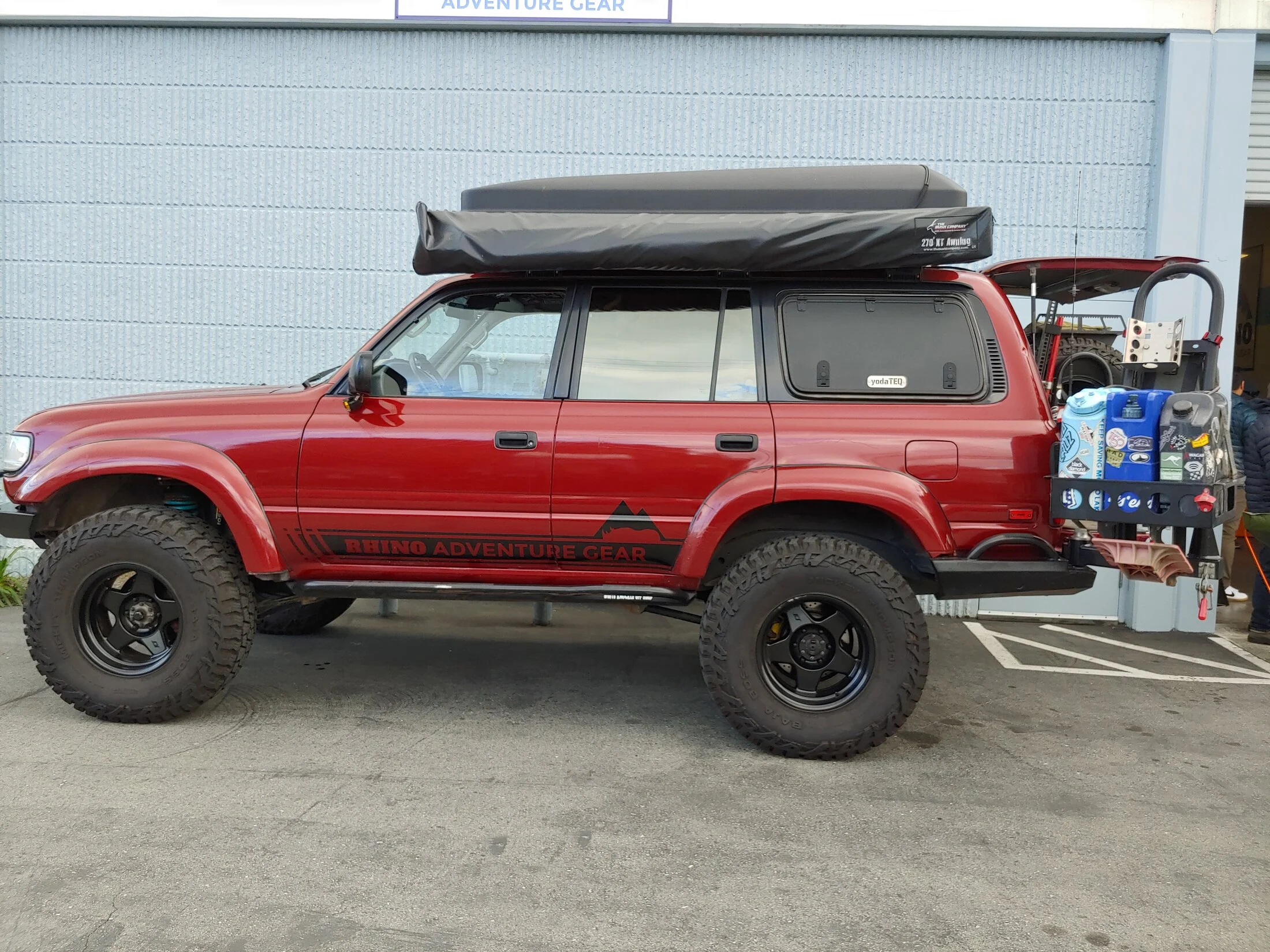

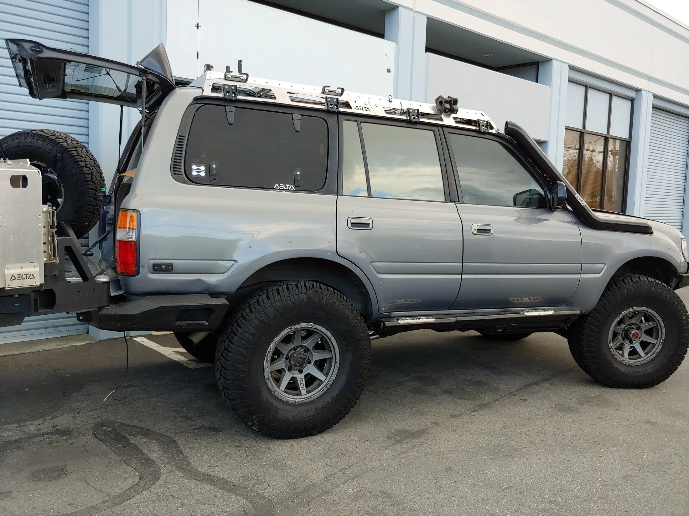

I had a GFC platform for my Tacoma and when we sold it I picked up a Superlight for the 80. Was gonna go with the normal tent but I wanted a rack for when it’s removed.
I like GFC a lot but their pricing has gotten really high.
We paid $6000 and they sell for like $10k plus now.
We had an old fashioned soft eezi awn that we used extensively. But it was kind of annoying to put away if you drive every day on a trip. So we upgraded to the GFC 4 years ago. Being able to set up and take down in a minute or two is really nice. We've definitely gotten our money out of it.
I like the tent but GFC as a company is just okay. They benefit a lot from their social media cachet. And they proporitary t-track is a blatant money grab.

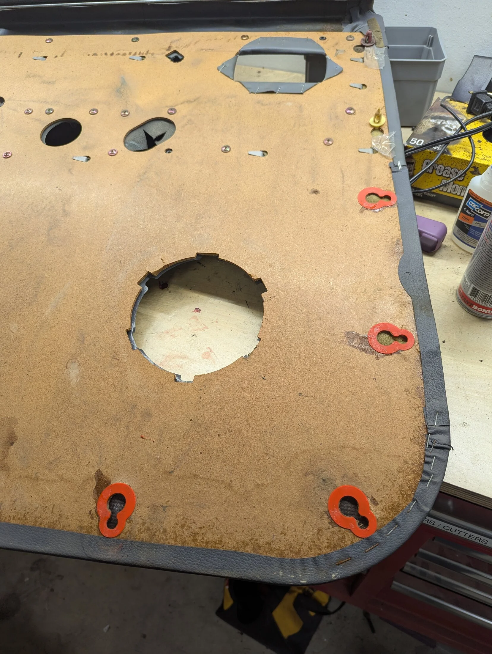

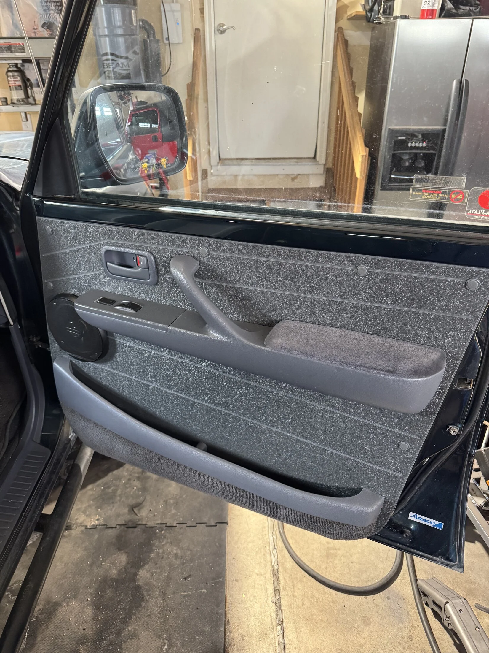

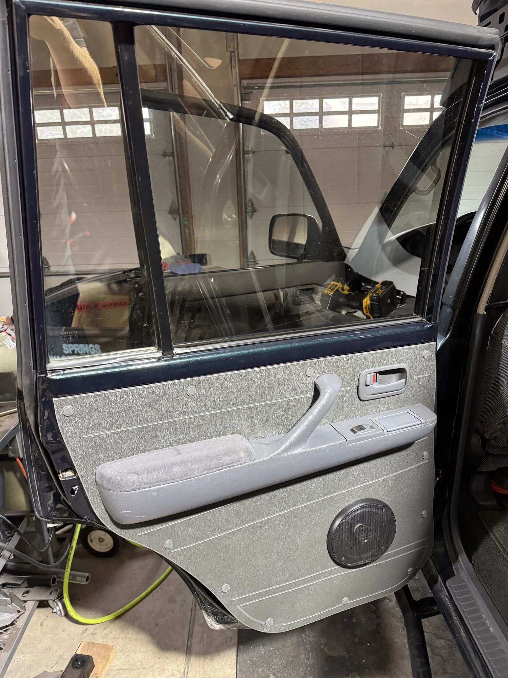

Some door cards. Will make a thread on this later.
Nice! I have the same. In the process of painting them all to match the oak interior and getting them in. Interested to hear what you did for the window seal. The description of the ones for sale on eBay weren’t confidence inspiring (ie, marking them as a gift with a low declared value to circumvent customs).

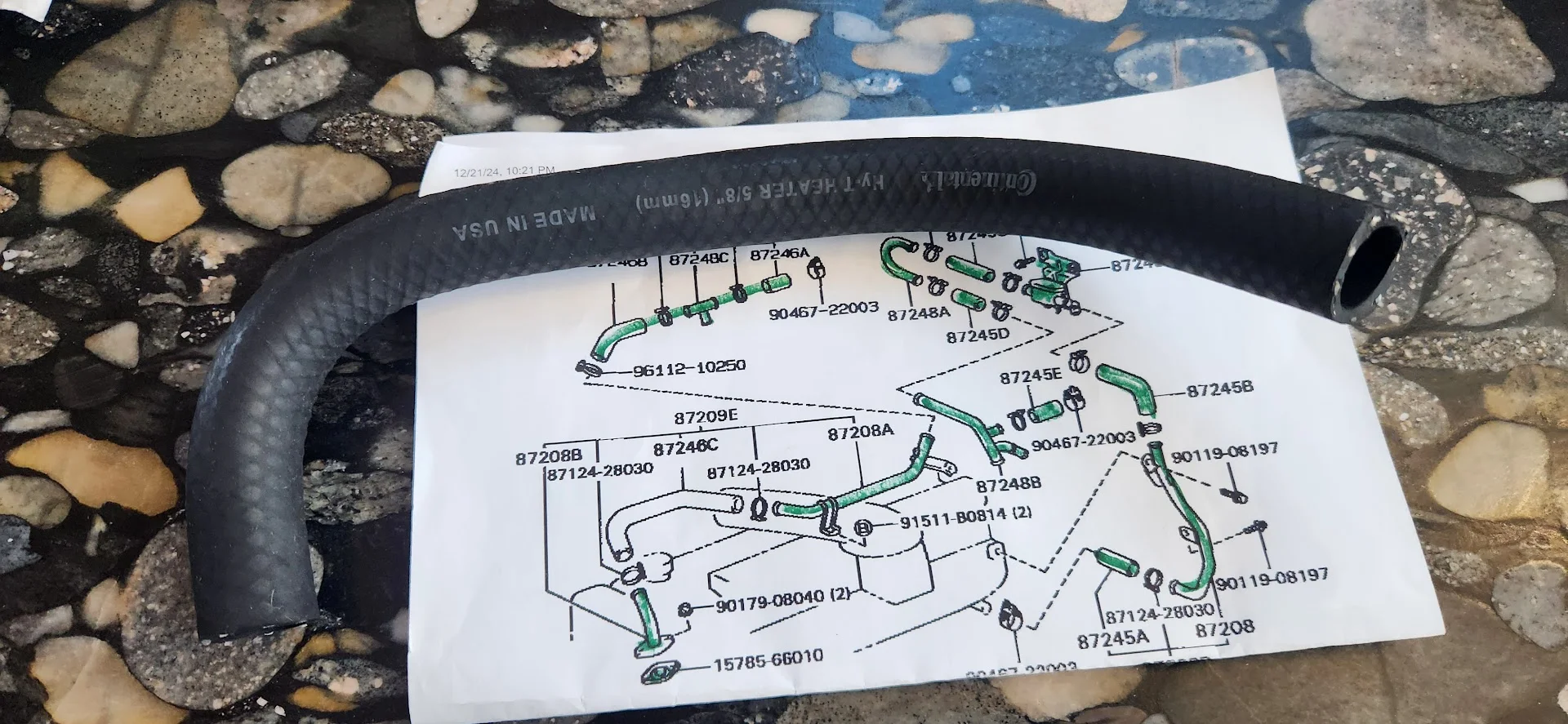

Where can I find more info on this hose forming method? You did a great job!
I watched a lot of videos, this guy did better than most:
There are three methods I see people use in videos, heat gun, hot water, and steam. I tried the hot water (not boiling) and didn't get great results. I was afraid the heat gun would burn, but it didn't.
You put a spring through the hose to avoid kinking, and a heavy spring holds heat and helps with the melt. This one worked great for the 5/8" heater hose: https://www.amazon.com/dp/B0BPP2ZLVK?tag=ihco-20
I've done this with a few hoses and got the best results, by far, from the Goodyear/Continental HYT-Black. It's a commercial grade hose, chosen by ChatGPT as I prioritized durability and formability.
Test on small pieces to get the feel of it. I used the high setting on my heat gun, 3-5 minutes from all sides, as I held or clamped the hose into an exaggerated bend of what I wanted. The hose and spring get very hot and you can feel the hose start to yield. After a short wait I used gloved hands to hold the piece in the exaggerated bend and dunked the hose and spring in water. The hose will spring back slightly, but mostly holds the position where it cools.
