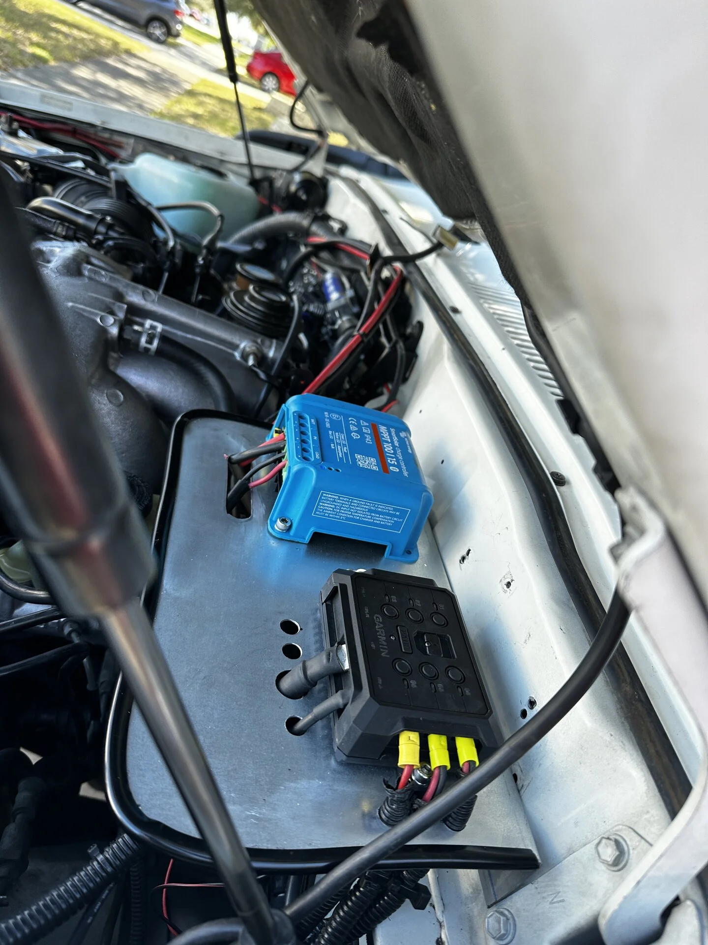

Are you confident in that due to the pack you have or because you think it'll stay cool enough? I work with/on HV/LV battery systems of different chemistries and I would generally agree putting one in the engine bay is a no-go.
Not trying to say you're wrong - legitimately curious.
lifepo4 is a 'safe' chemistry versus li-ion. It will not 'catch fire'. The battery also has a BMS to protect from charging when the battery is too cold or too hot. The battery is operationally safe to 55C. I've never seen 60C in the front/battery area of an 80 - 60C is OUCH temperature to your fingers (within a few seconds). Plenty of airflow when moving, no way it'll get silly hot. Heat soak is feasible, though again, any time I've popped the hood to air up etc, I've never felt any of the fender area etc being uncomfortably hot. The battery area is sufficiently 'insulated' from direct engine temperatures. Exhaust manifold is plenty far away and shielded. If you can touch the inside fender area and metal in those locations, it isn't "that" hot.
The DC DC charger is rated to 80C operating temperature. If the battery/fender area got anywhere near that I'd say climate change has killed us off already.
Anyhow, I'm plenty comfortable with the setup I'm putting in place. If I ever am really worried, I'll just put a thermocouple in the battery tray area and run a cable to a meter or use my FLIR to check it out :)
SLA and AGM batteries mostly state max temps in the 50 to 60C range. So lifepo4 is similar and being 'fire safe' means it's certainly compatible with the location that it will live in. I don't want to install it in the rear since that just means creating a place for it, running cables etc etc. I just need power for lighting and other simple camping gear - the microwave stays at home...

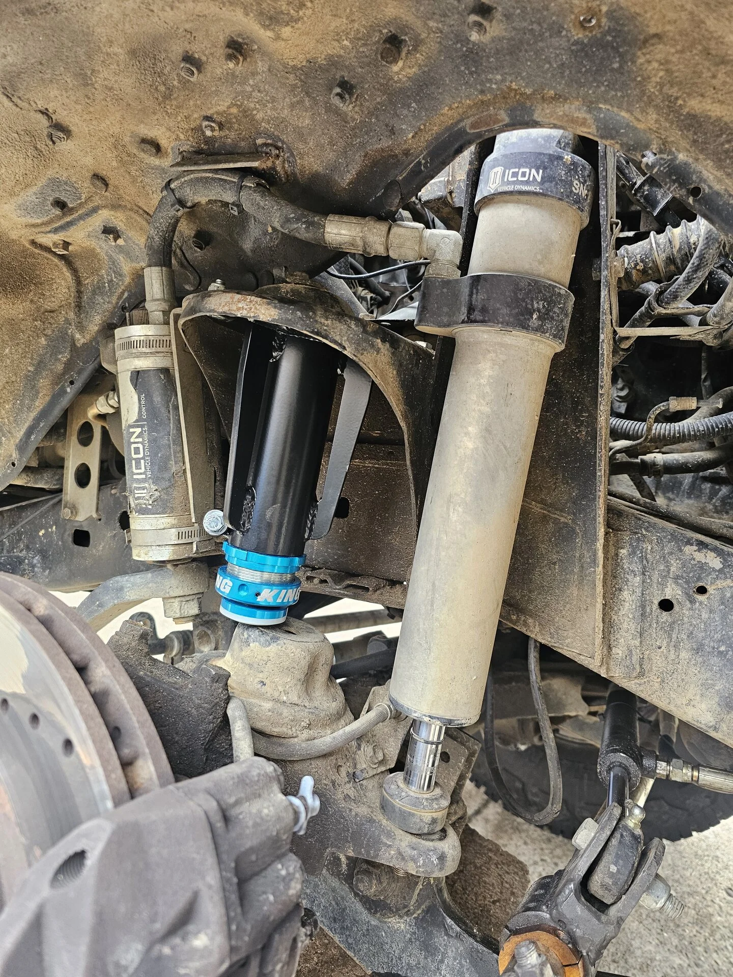

Then installed the @Delta VS front hydro bumps. For a little 1/8" maybe lift and cush whoop action.
