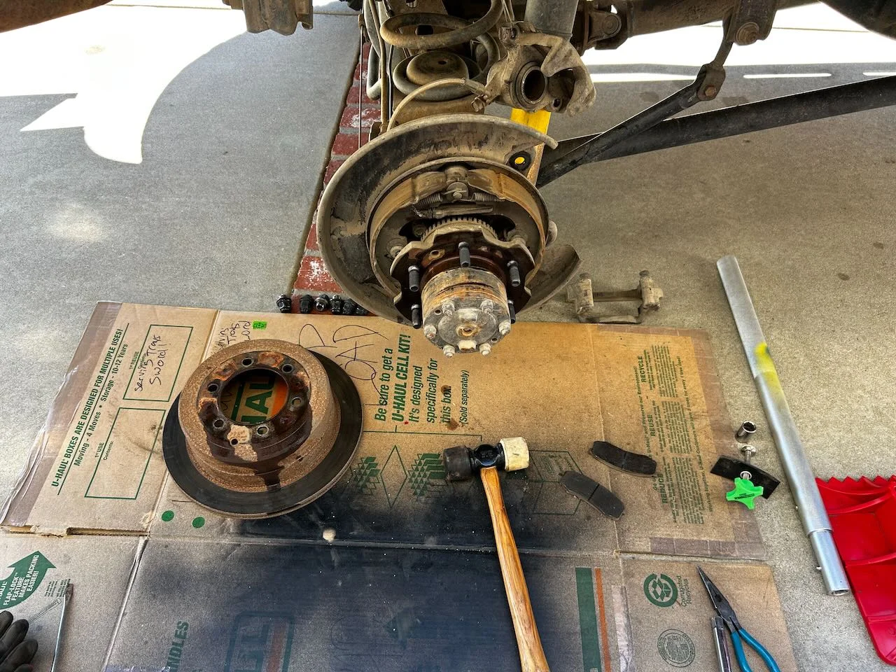

I just replaced all of the suspension bushings as well. Front was first, then rear. If I ever have to do it again, one control arm at a time and use heat on the control arm to help move the bushing out/in. Looks like you have all new hardware (bolts, nuts, washers) which is what the FSM requires. 👍 have fun.
@OGBeno

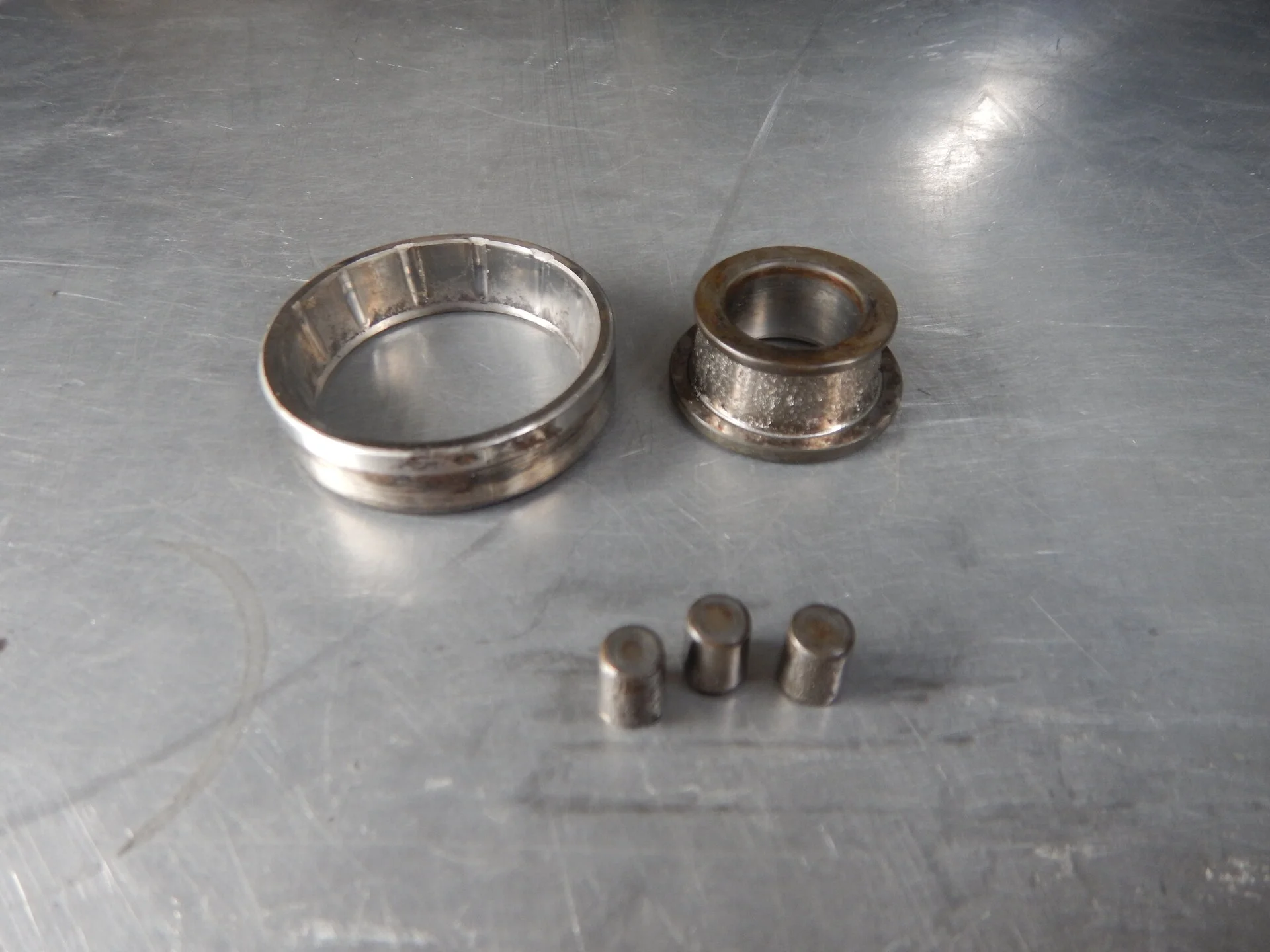

New TRAIL TAILOR case hardened press tools. Pushed a few bushings this morning. No sticking and slide right out.
Jason
TT

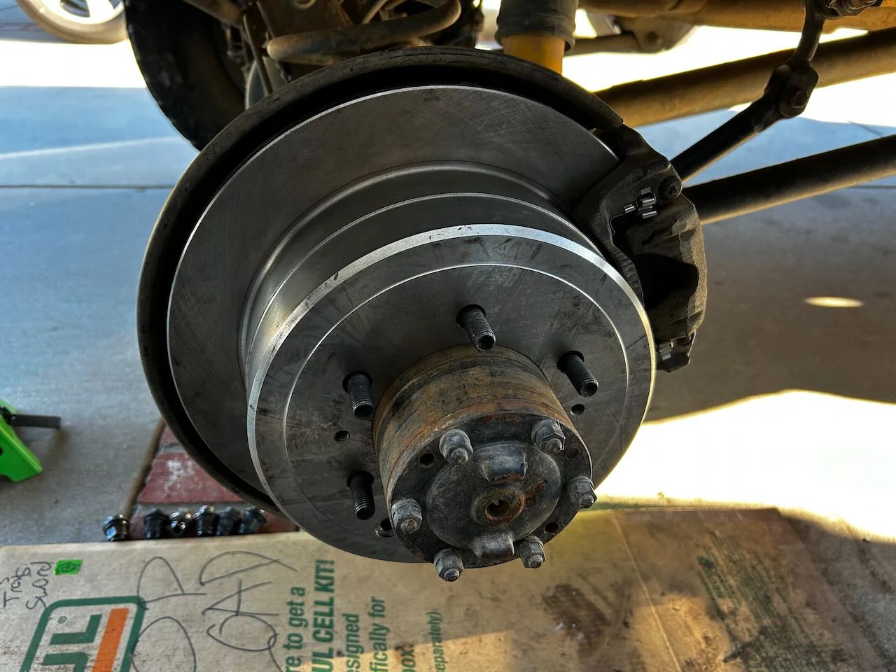

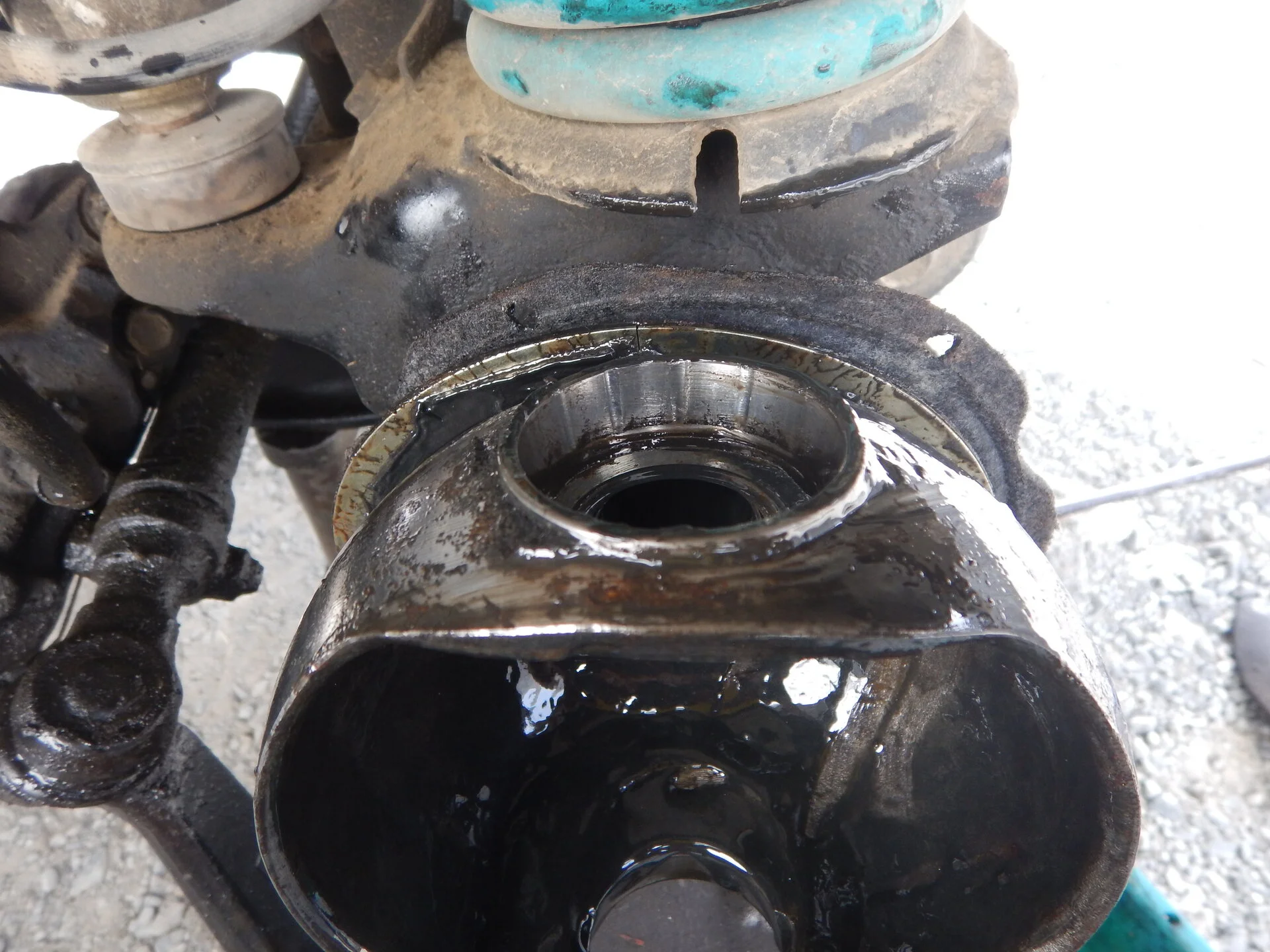

2 for 1 today. Wanted to do a little shooting but I had to twist some hubs to get back home 🤣
7,000 ft mid February in utah with 50 degree temps = IH8MUD!!!!!!

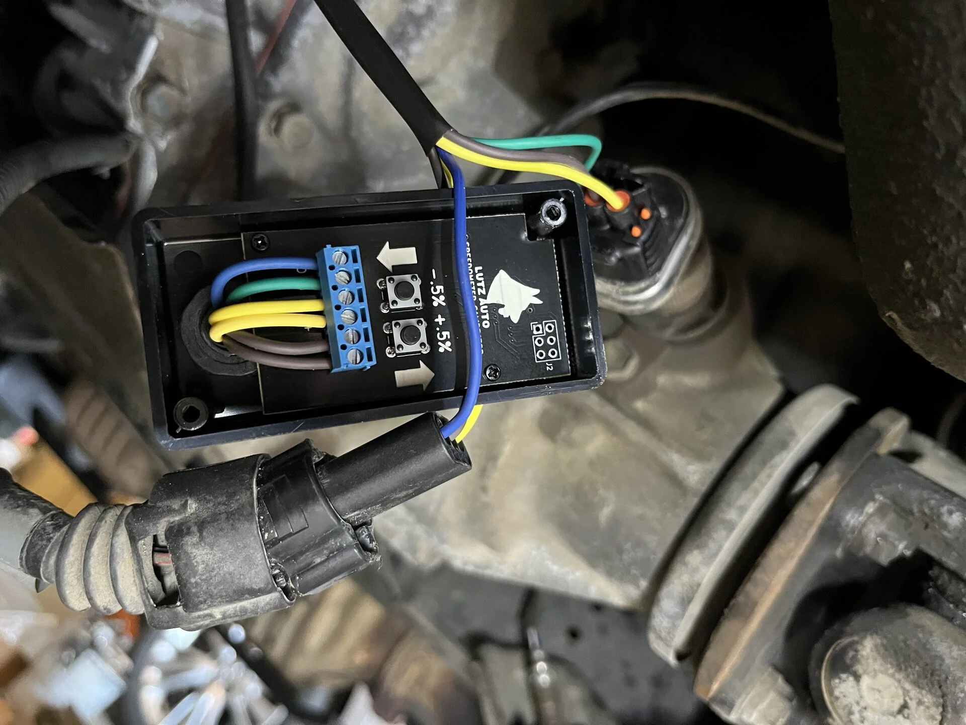

Finally installed the Lutz speed-o-meter calibration unit. Took about 15min do it including the test drive and 5 min trying to find my tube of RTV sealant.
17 “up” clicks and now she’s dead on accurate. 👍👍
