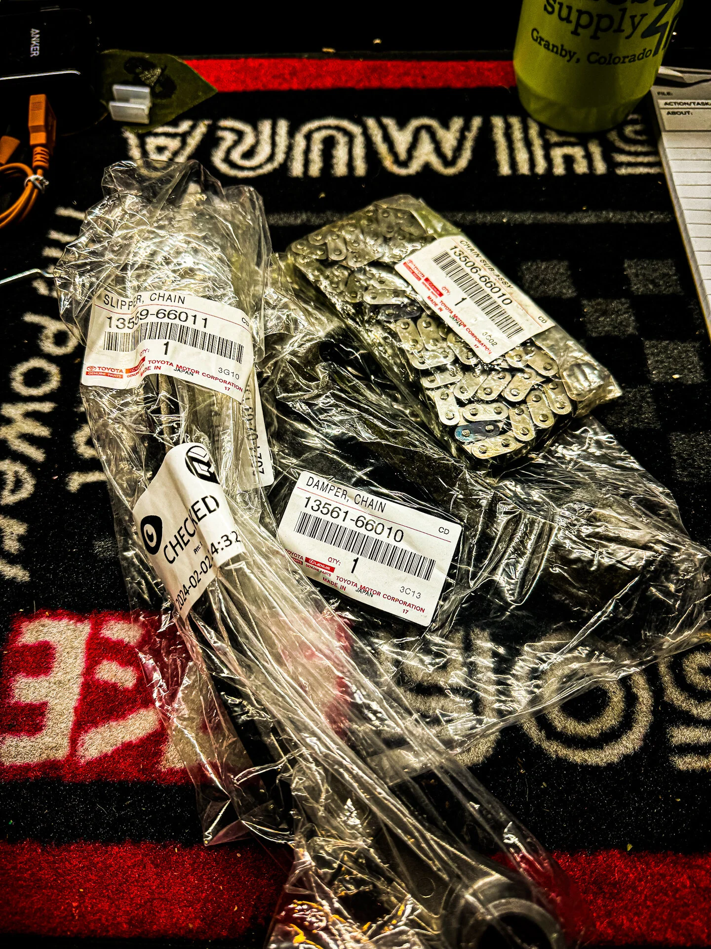

I finally pulled this damned thing off, so I can replace the cam chain, tensioners, and dampener, and start buttoning this freaking project up.
Mucho thanks to @OTRAMM for the tool, and my son for the muscle to break that dang bolt loose.

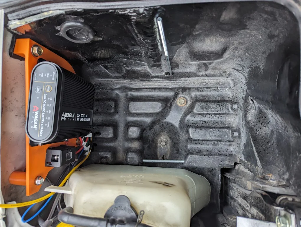

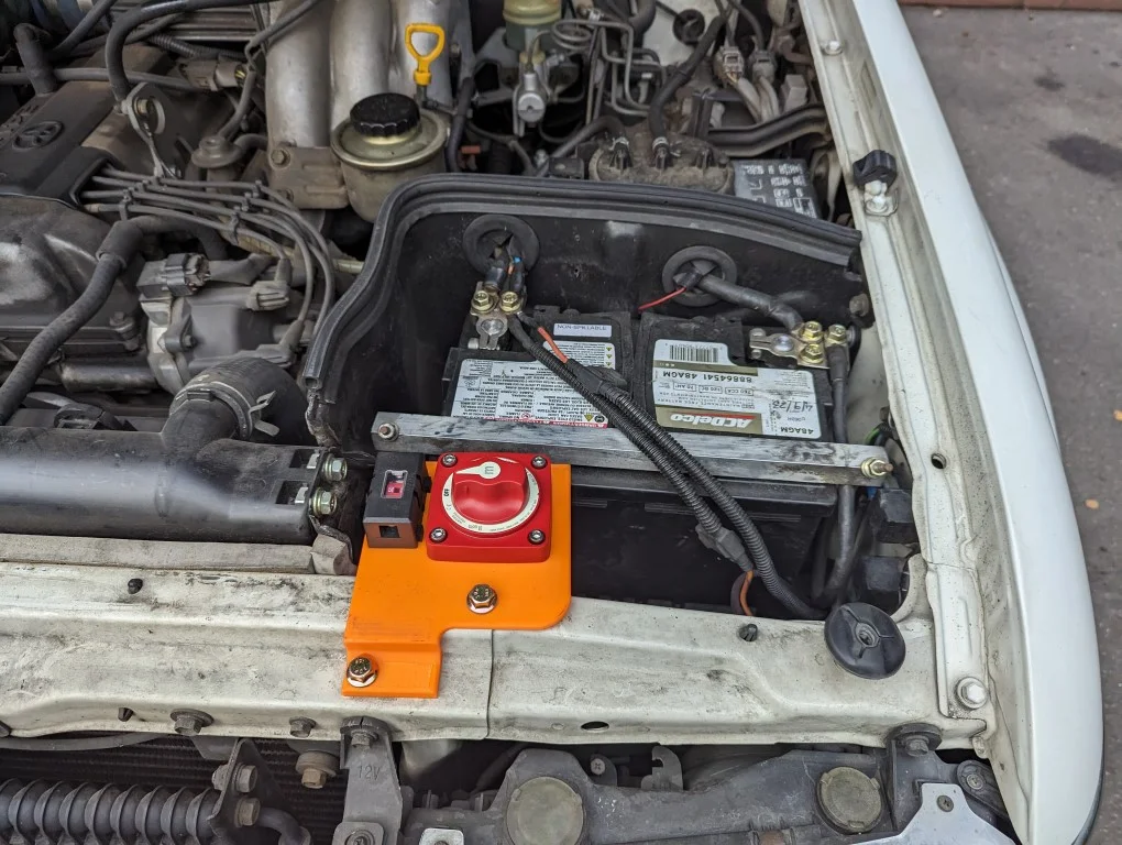

Well, a bunch of weekends and planning. Re-doing my dual battery setup to use a lifepo4 as the aux and that has entailed a bunch of planning and rethinking my existing solenoid based system (that has/had been working for the past 20+ years). The move to lifepo4 was to better utilize the aux battery location to utilize a much better battery tech for my use - camping aux power.
First job was to come up with a new battery switch for the winch and a MIDI fuse that will take power from the main battery to the DC DC charge controller in the aux battery location.
Designed and then 3D printed a bracket in PETG to mount in my chosen location. Worked out nicely. Still need to modify the existing winch cables and crimp new lugs onto them.

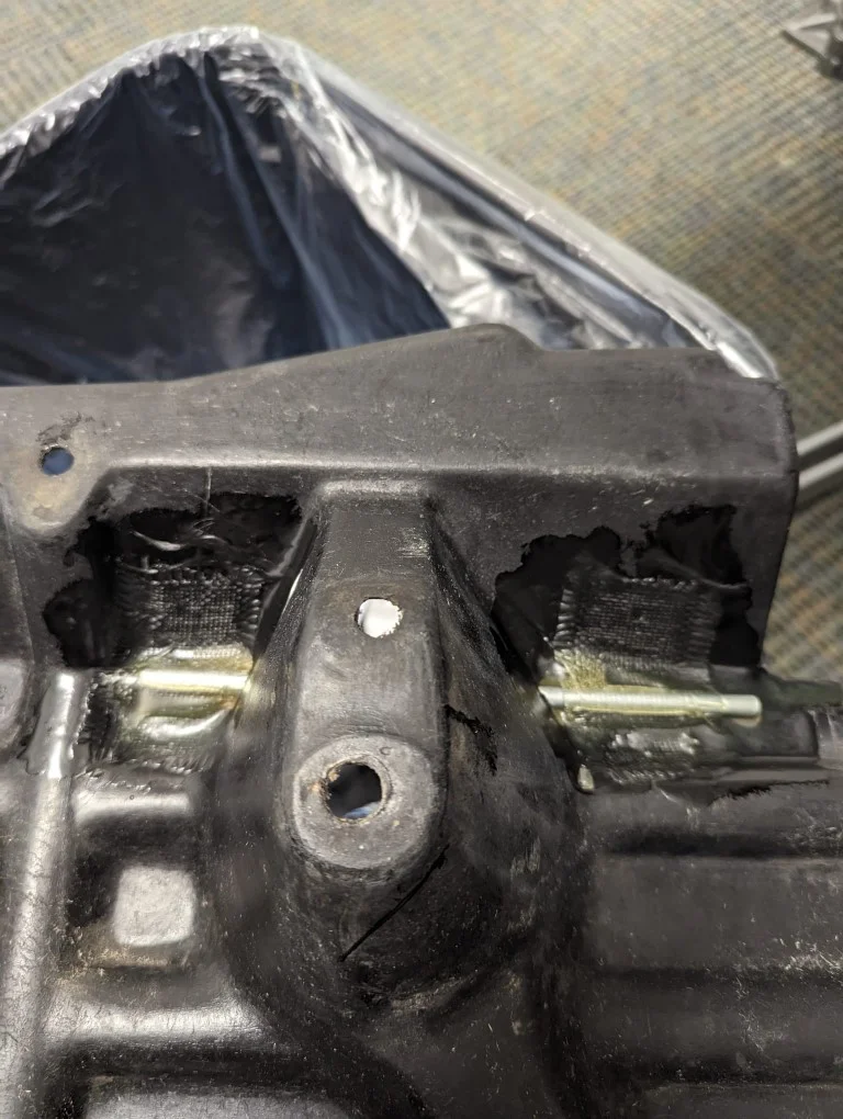

The moved on to the aux battery. JOB #1 was to modify the dumb toyota battery clamp system - it really is pathetic how one side relies on a slot in the holder's case to hold the battery and also that it is a diagonal hold down (force wise). Nuts for a vehicle that deals with off pavement stuff.
Picture of bottom of PS battery holder. Drilled a couple of holes and inserted a steel rod. Same concept on the 'back' mount. Used resin/hardener to fix in place and also repaired the battery box that had breaks and cracks from years of use.

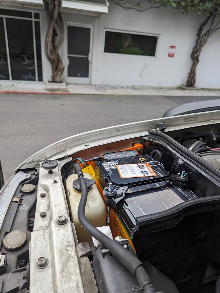

This is the box re-installed with the new battery hold down rods in place. New hole in the repaired case with a through grommet. The DC DC charger mounted on yet another 3D printed PETG bracket I design. Another MIDI fuse for the charger to battery path.

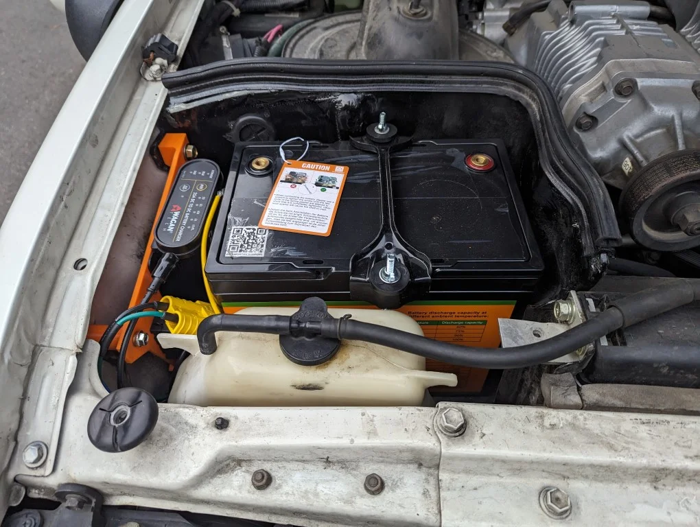

The installed battery. Need to finalize the wiring connections from the charger to the battery. Then on to making the same hold down modification to the main battery.
I like this DC DC charger (25A model) since it has chemistry selection including lifepo4 AND has a Solar input (built in mppt) and can auto switch from solar to the main battery as the source.

Re-doing my dual battery setup to use a lifepo4 as the aux...
1. Lifepo4 batteries should not be installed in the engine compartment. They are very sensitive to heat and might fail and even catch fire. I would recommend you to install both the lifepo4 battery and the DC2DC charger in the rear, getting power from the main battery using a 25mm² cable (like a car jumper cable).
2. Instead of PETG, I would recommend you to use ASA. It is more resistant to the temperature and vibrations in the car.
Thanks for your concern, but the lifepo4 will be just fine in the battery case in the front area of the engine bay and so will the charger PETG is fine for this application.
Cheers,
George.
Cheers,
George.
Are you confident in that due to the pack you have or because you think it'll stay cool enough? I work with/on HV/LV battery systems of different chemistries and I would generally agree putting one in the engine bay is a no-go.
Not trying to say you're wrong - legitimately curious.
