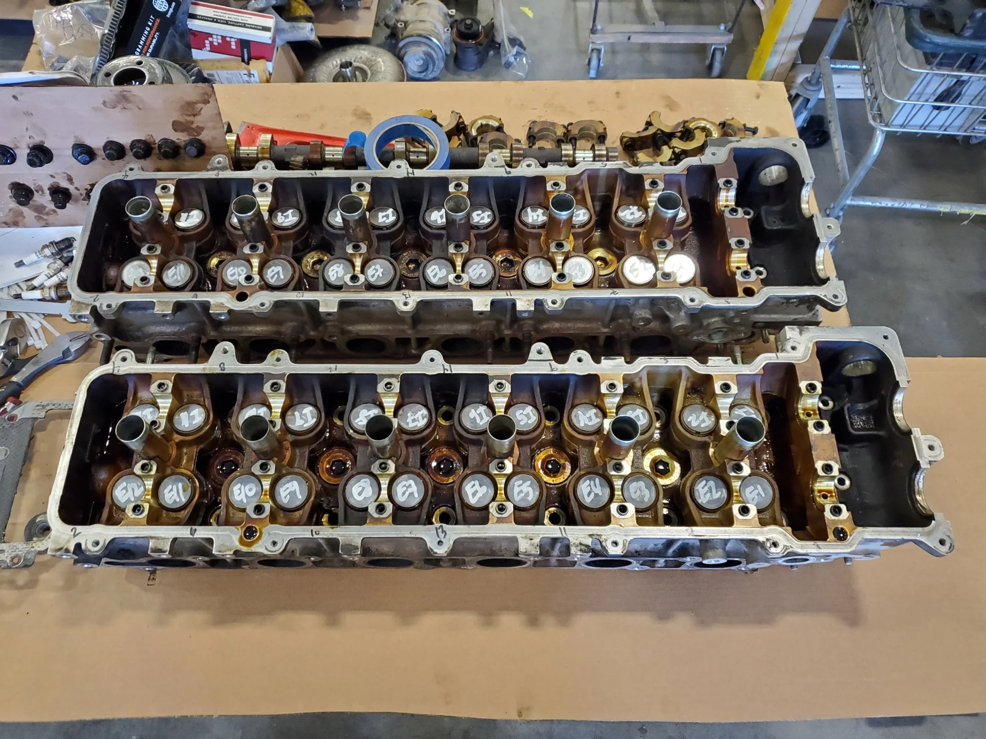

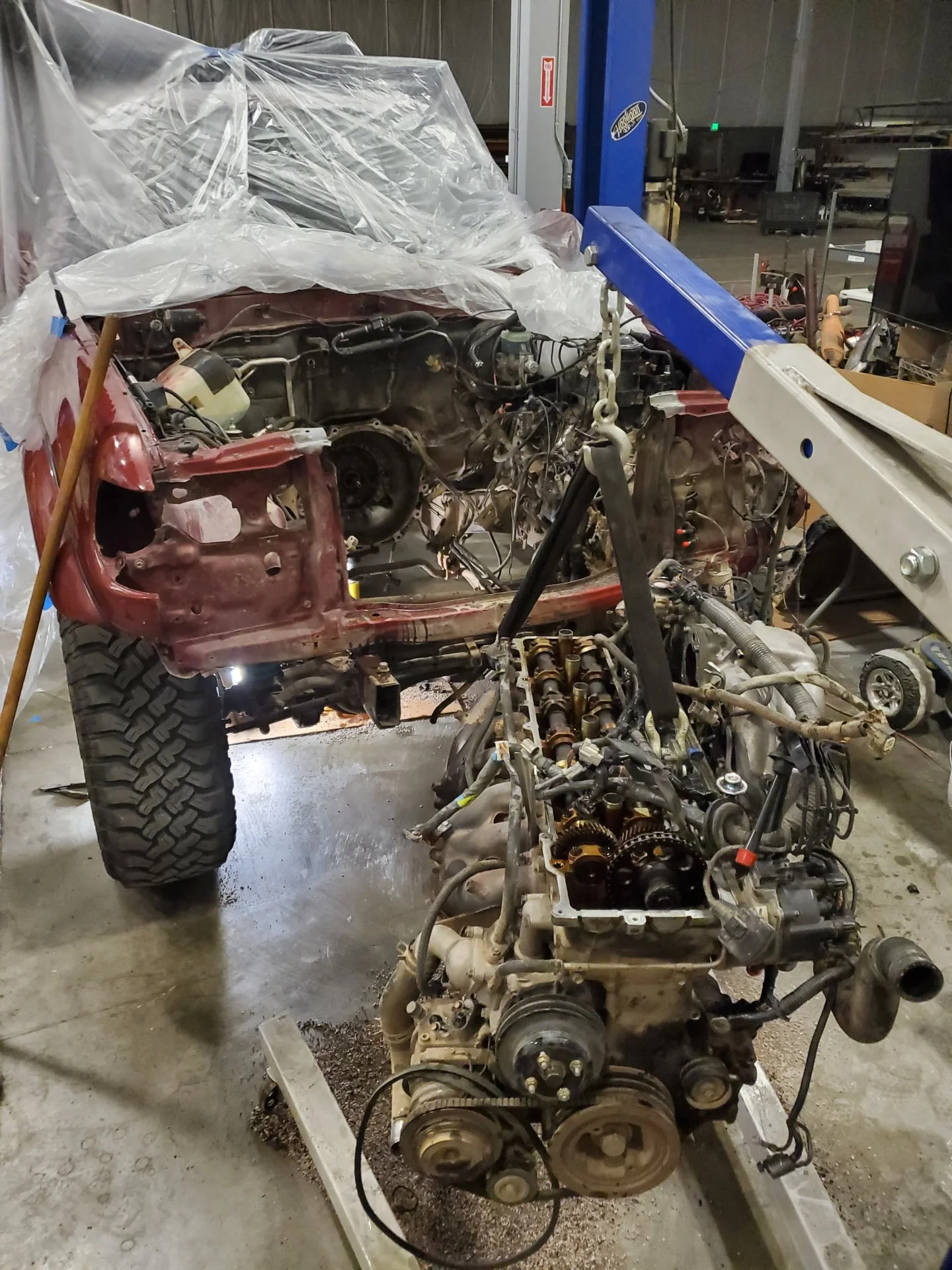

Decided to fully dive into this turbo install and jumped off a cliff at the "while you're in there" step. 😅
I'll be bringing the head and block to a local machine shop at the end of the week and will continue to gather parts in the meantime.

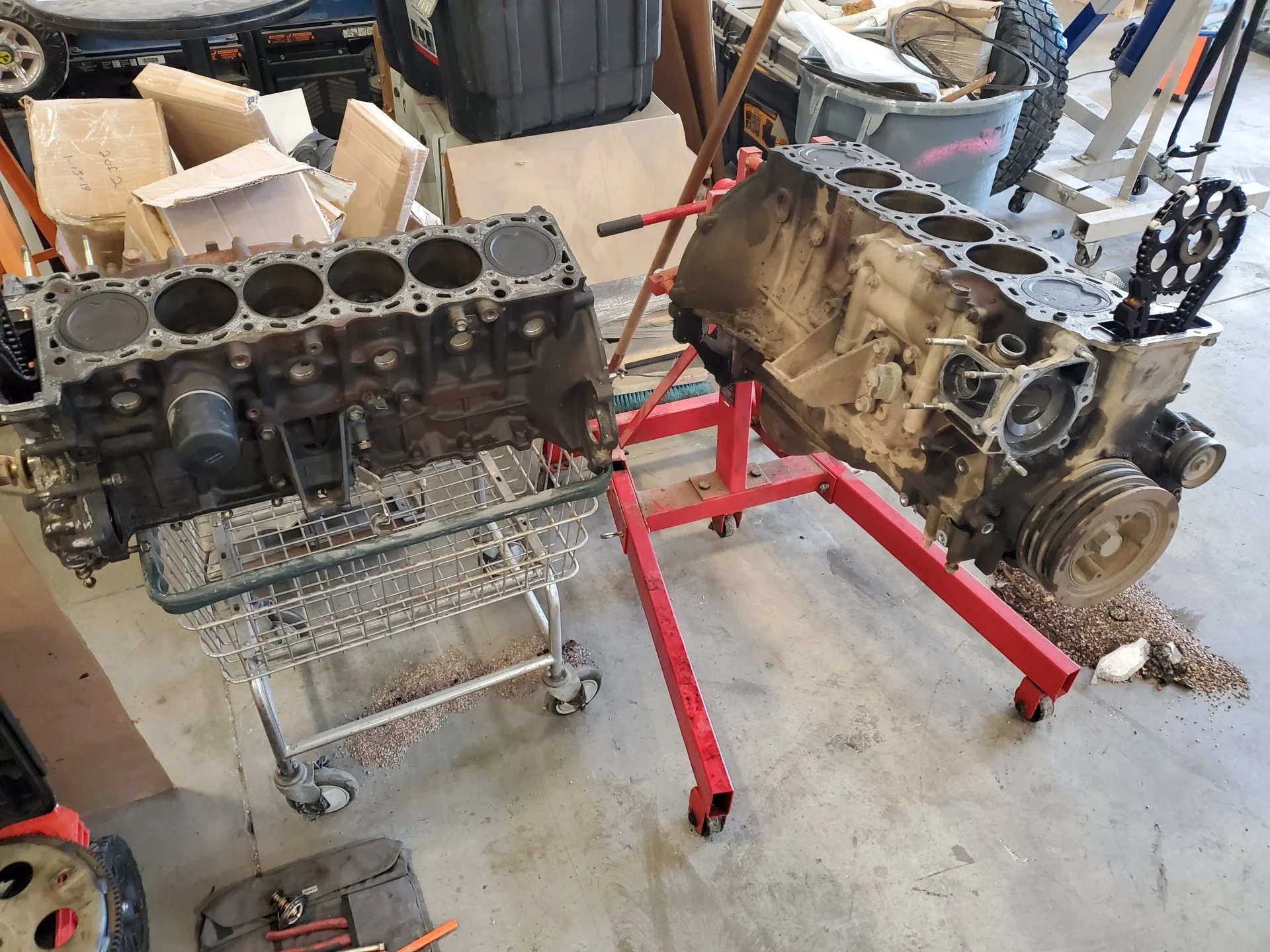

I originally bought a donor engine to mock everything up and then discovered that it was needing a rebuild as well. I figured I would blow them both apart for fun. 😂

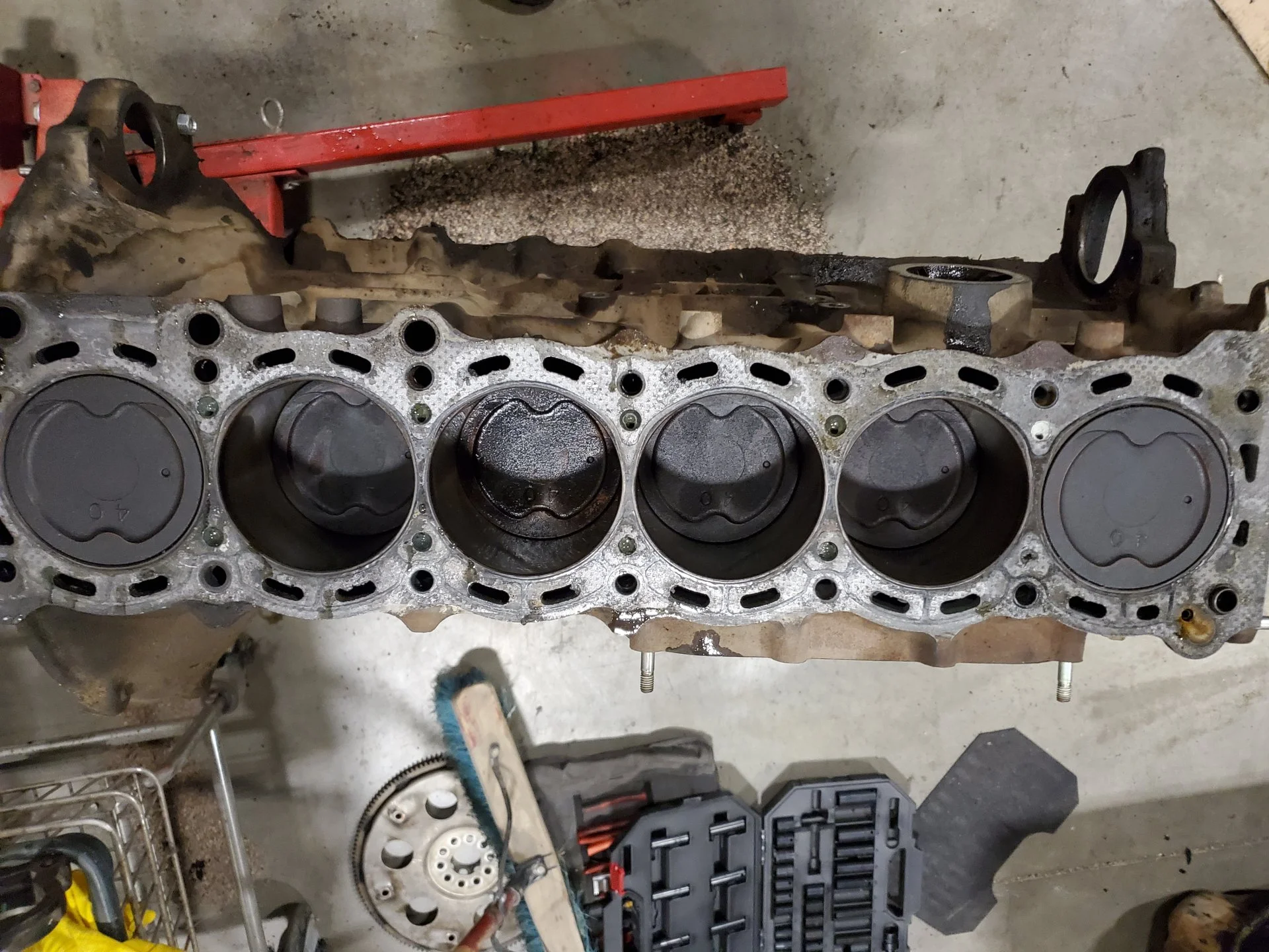

I've gotta ask... why not just do a swap? seems like a similar level of work at this point :popcorn:
What type of swap are you talking? LS? Cummins?
I was originally going to swap the donor engine into my rig (I had a stuck intake valve on #4 - I eventually found out what it was after tearing the motor down) but decided to do a full refresh of the stock 4.5L and slap a turbo on it.
