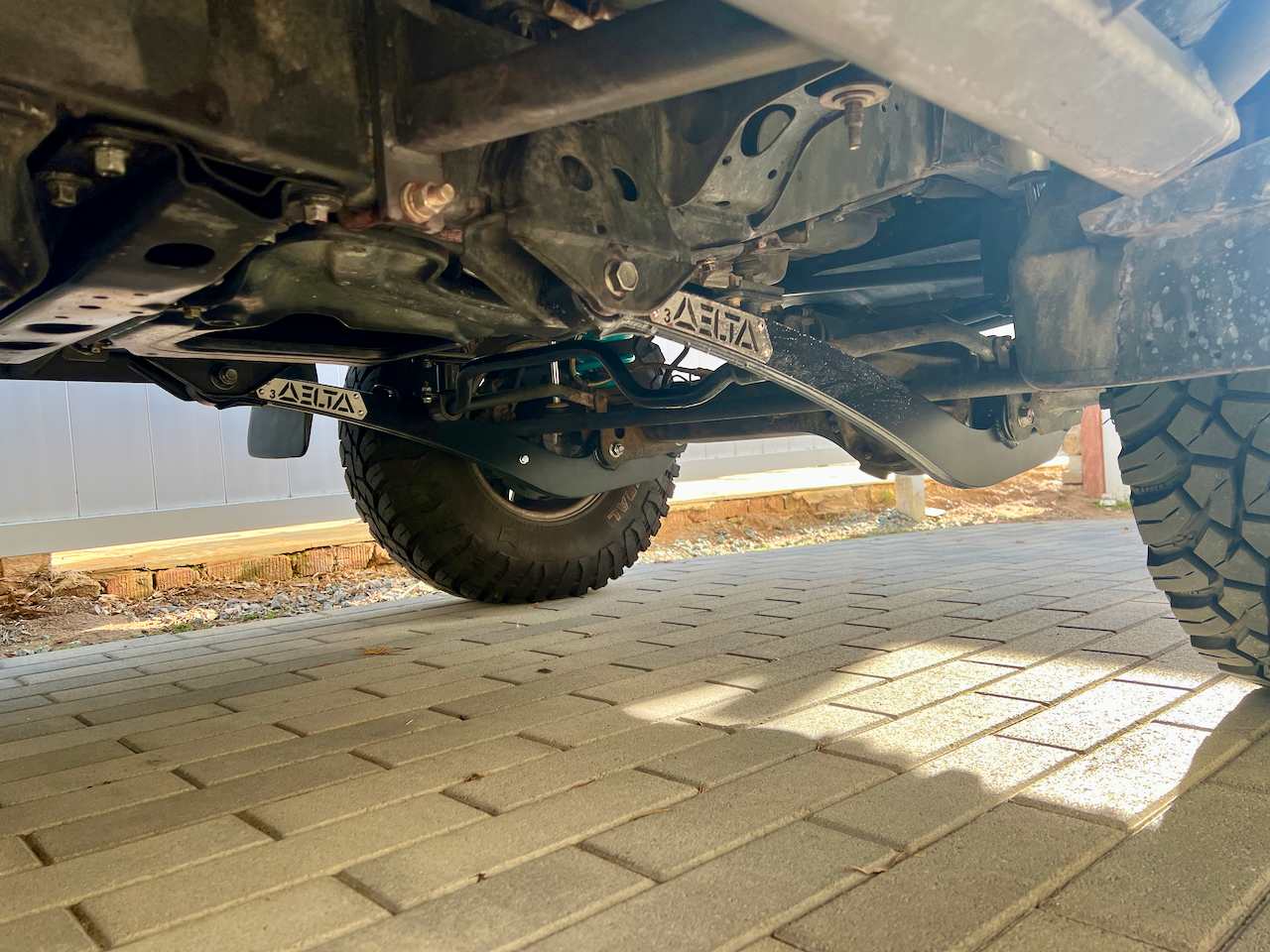

Haven't driven more than a hundred miles with new Delta VS radius arms on Ochenta, my 1990 HDJ81, but they feel pretty good so far. Next step...head to an alignment shop to get updated caster readings. After adding Dobinsons springs and a bit more lift, steering was light so some additional caster correction was in order.
The goods
Not sure if I am new to the club but has anyone noticed the "3", is that something @Delta VS is doing for each set of arms depending on lift?
Ya, since there are many different versions, and we make them in huge batches, we need a way to keep track of what is what. Labeling them is the easiest way. 2” badge won’t fit 3” arms, etc., and may as well make it look decent since it needs to be on there.
Nice, love the attention to detail as well. Can wait till I have the coin to get some, gofundme???? LOL!!!

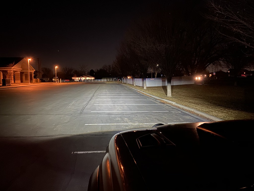

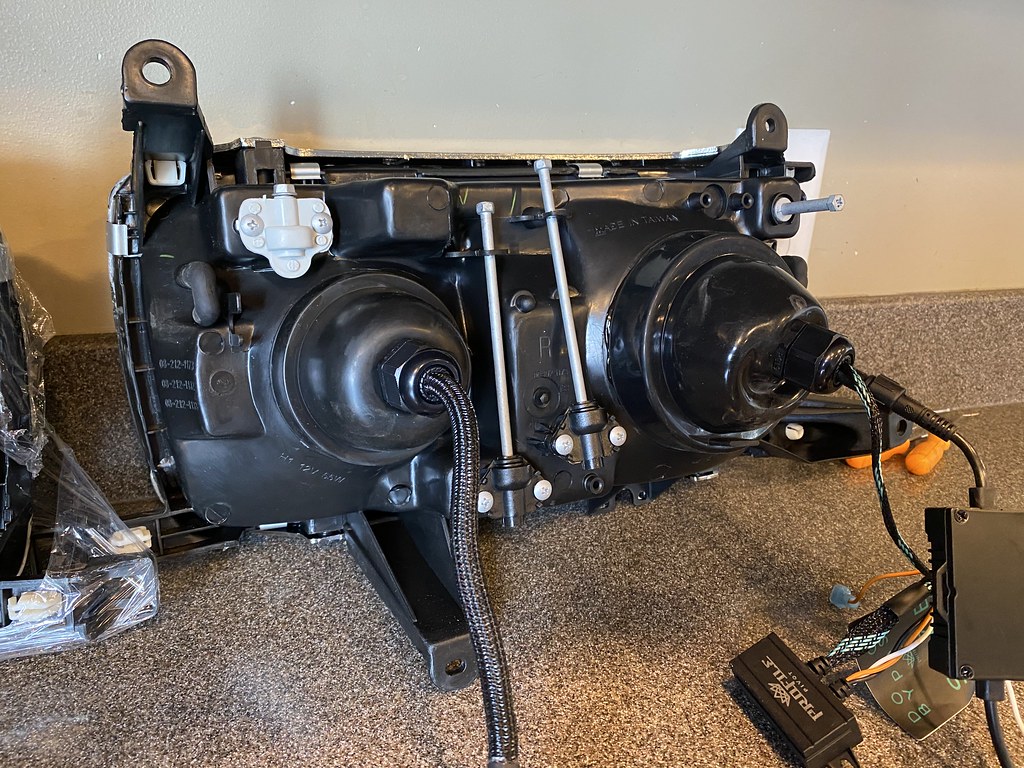

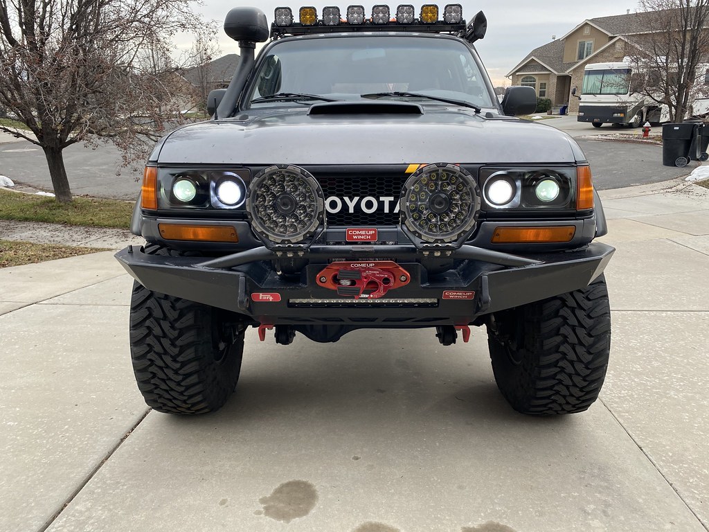

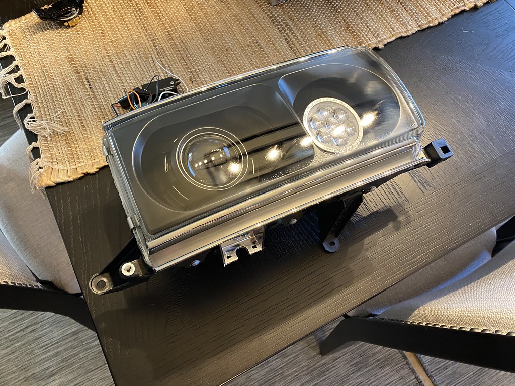

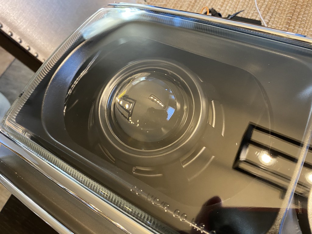

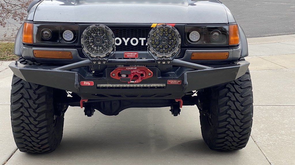

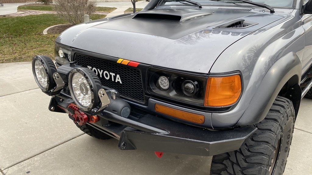

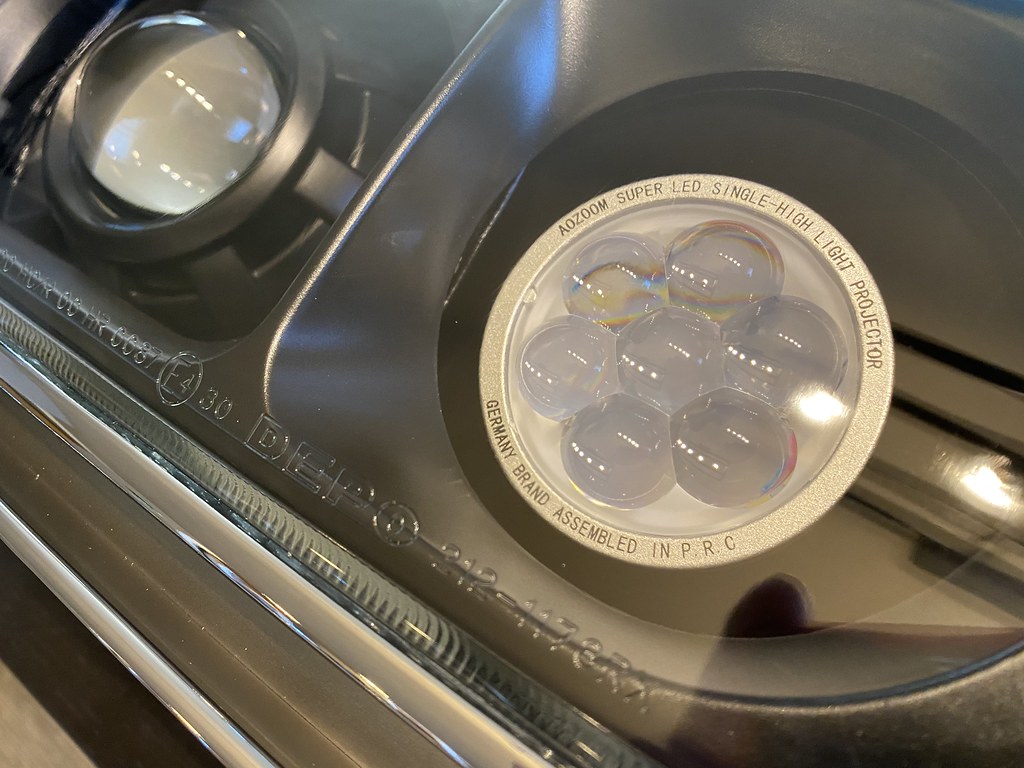

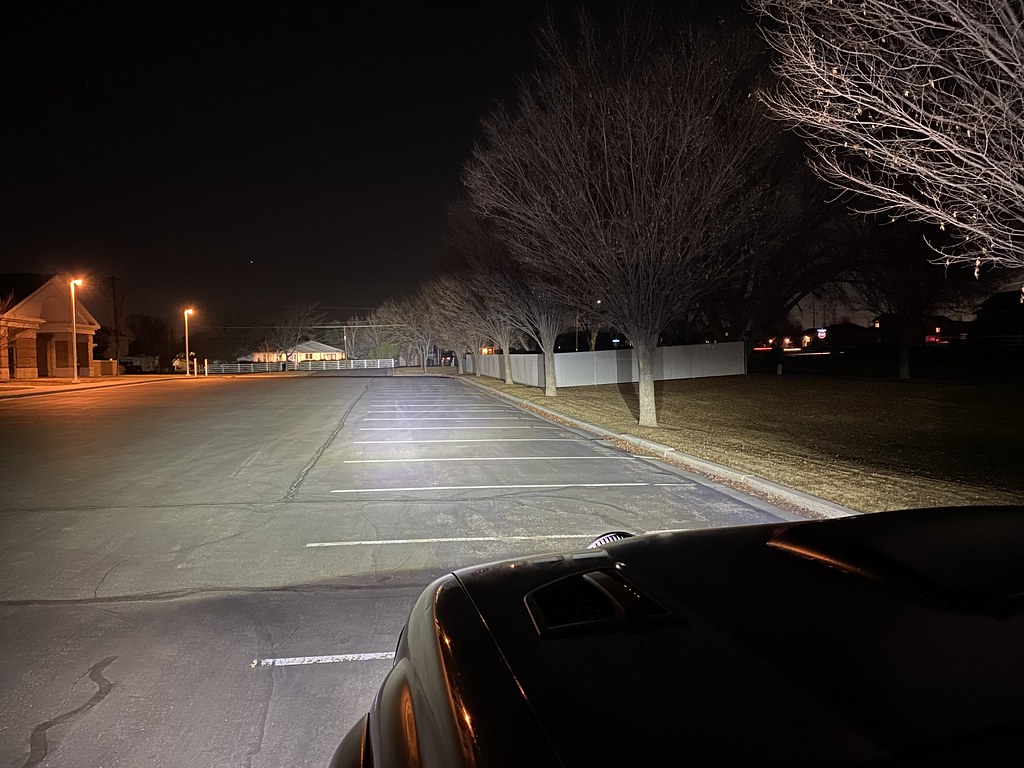

Got my new headlights from Freedom Retrofits! Specs are glass lens DEPO housings (painted black). X3 Bi-LED projector for the primary headlight. Apollo 2.0 shrouds with Switchback halo. Multispot LED Spot high beams. Switchback halos are tied into running lights and blinkers, white backlighting with running lights and switch to amber blinkers with the turn signals. Really stoked about these! They've been on my list for a long time but good quality retrofits aren't exactly cheap so it took me a bit to put a little mod money aside for these. I haven't aimed them yet so the cutoff line will even out once I get them aimed properly.
Output is way better than the factory lights and also better than the LED bulbs I had been running in the stock housings for the past few years.

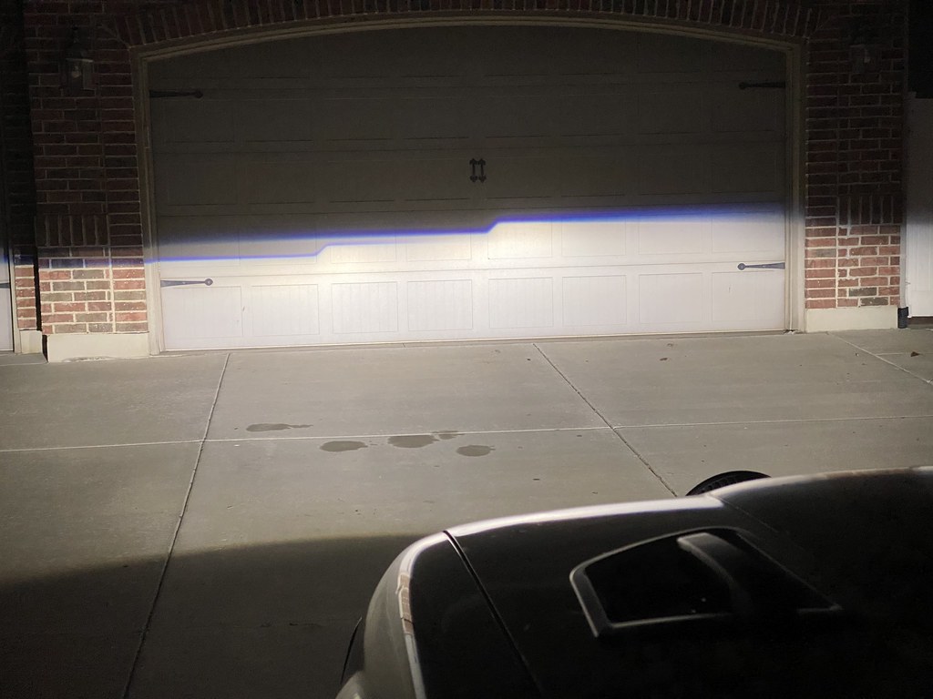

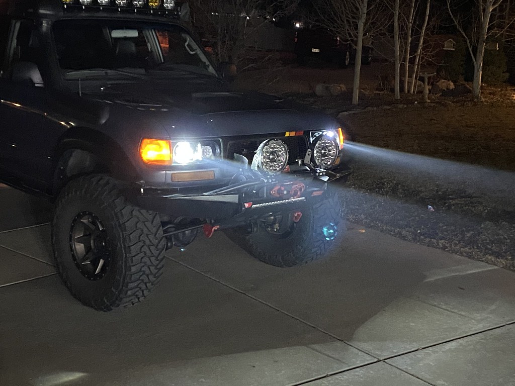

Still haven't aimed the lights properly in this photo. This was immediately after the install. Good cutoff, just need to be aimed.
Headlights by Adam Tolman, on Flickr
This is the primary projector headlight output.
With high beam spots ON.

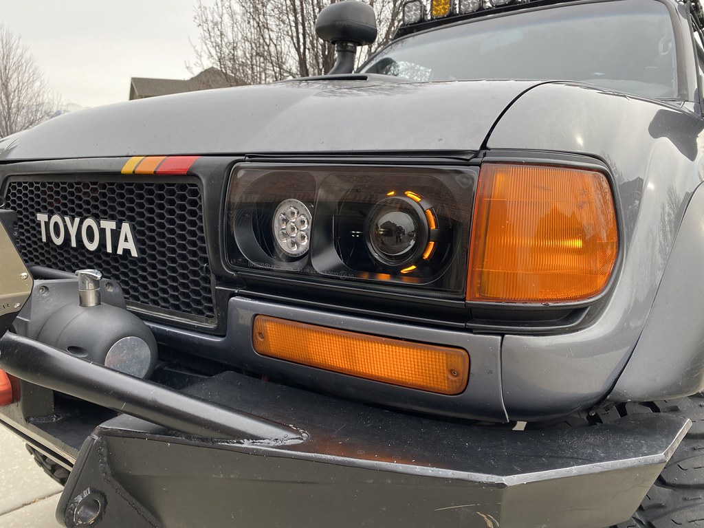

Halo backlight blinks amber with the turn signal.

nice! looks like they put out some decent light!

that is a sharp looking rig and wheels and tire combo !
