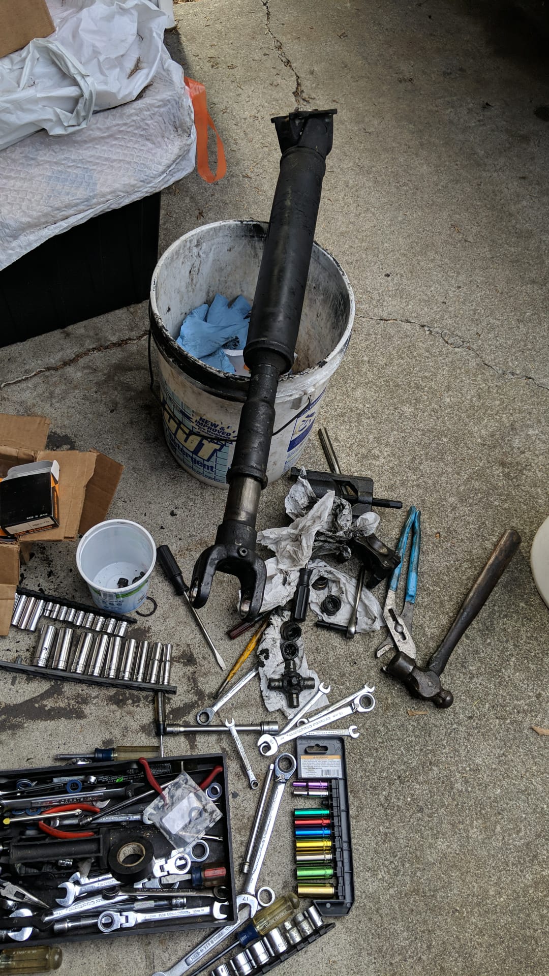

New unijoints on the front prop shaft. Will do the rear maybe the coming w/end. I use a Lisle 42890 tool to disassemble the old uj (so easy to do, it's fun) and big old vise to press the new caps in on the new (also smooth and easy). Purchased the uj from cruiser outfitters.
1/2 way through the job:
And no, the majority of the tools in the pic were NOT needed :)
The old uj were in damn good condition - with only 180k miles on them. Figured it was a job to do and be good to go for my lifetime at least. Quite a giggle comparing the front uj (that are quite a bit smaller than the rear) to the rear on the jeep xj that I had apart when replacing the clutch/pressure plate. The Jeep's look like they belong on a bicycle and are held in place with tiny little bent metal u brackets with the most ridiculously small screws.
