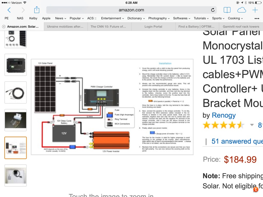

Installed Renogy 100w solar panel kit

That's nice! Do you have an install writeup? How many amps does it put out? How much does the panel weigh?
thanks!
thanks!
I dont have the install writeup but it is very simple. The kit came with two 20' wires. I only had to buy two 30A in-line fuses because it came with the 30A charge controller. The charge controller doesnt have the output display, just led lights. Controller with output display is in the near future. Weight is less than 20lb.
1. I thrilled 2 holes and ran the wires thru the roof down to the ps D pillar using Heyco fittings.
2. I ran the wires along the ps to just below the glove box where I mounted the charge controller. I chose this location because I can easily take a peek from the driver seat.
3. I soldered the + wire to 1 of the in-line fuses and hooked it up to the charge controller. Connected the - wire as well.
4. I ran 12awg + wire soldered to the in-line fuse and 12awg - wire from the charge controller to my aux acid battery. If you dont have 12awg laying around, I think you can cut up the kit wires and use it. I have 1 agm and 1 acid batteries installed and this charge controller can only charge 1 type. I will eventually wire it to the main battery when I get the same type. That way when my main is full it will charge the aux.
