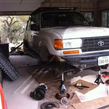

Holy Crap devildog! How did that thing even roll to get it into the shop? Lockouts and PT TCase?
What were you doing to blow it up like that? The last one I saw like that had a 400 SB Chevy and a 5000 RPM neutral drop. (Not me BTW...)
Holy **** devildog! How did that thing even roll to get it into the shop? Lockouts and PT TCase?
Well. it happened on the trail about 100 miles from home. I pulled the drive shaft as well as the drive flanges and locked the center diff so i could limp home. Not actually sure how the damage happened, I was in quite the predicament and I think it it when I was reversing up hill with wheels at full lock. Not a good idea.
