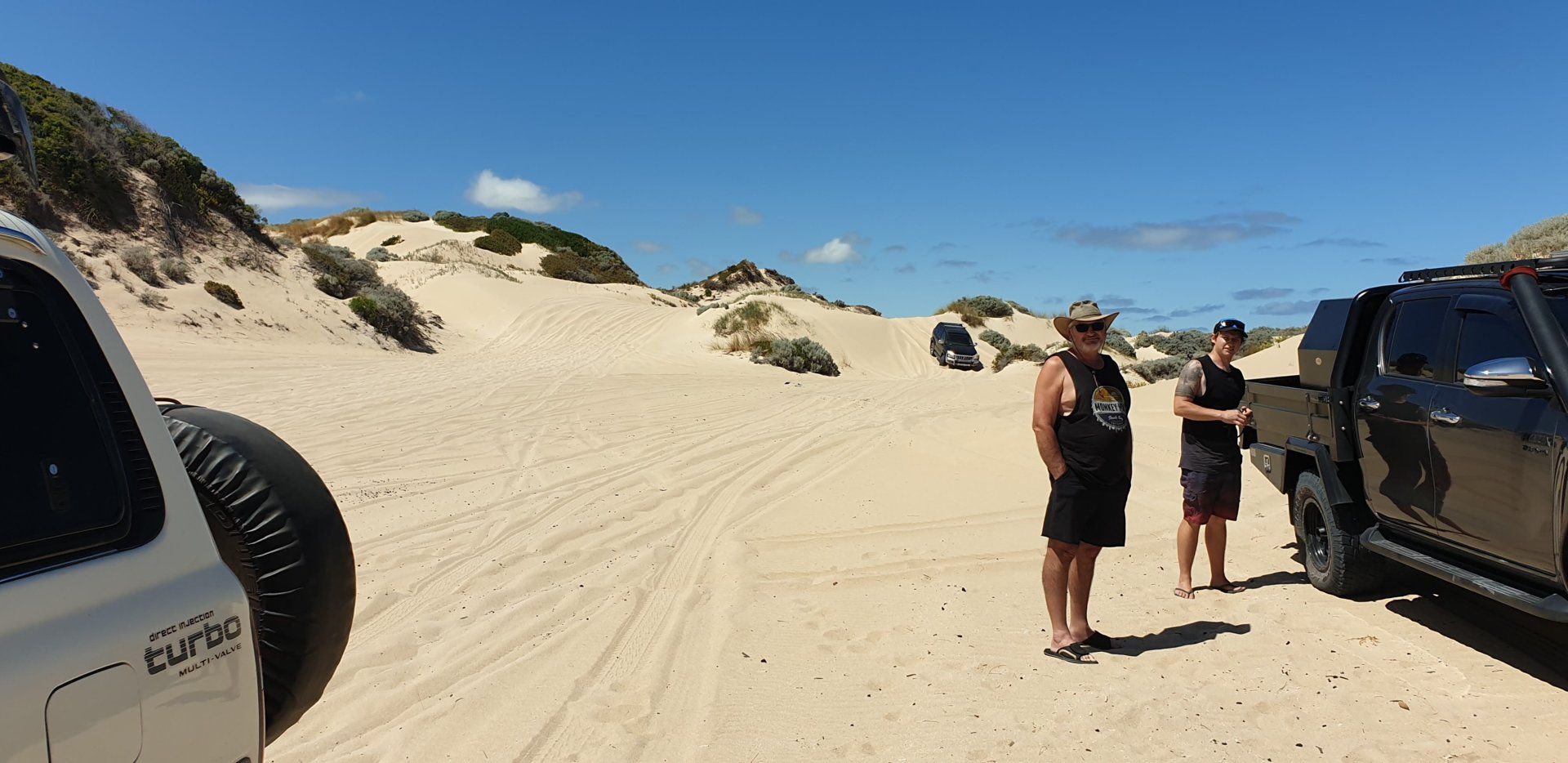

went for a drive to the beach with a local 4x4 club, the 80 faired better than most in the dunes

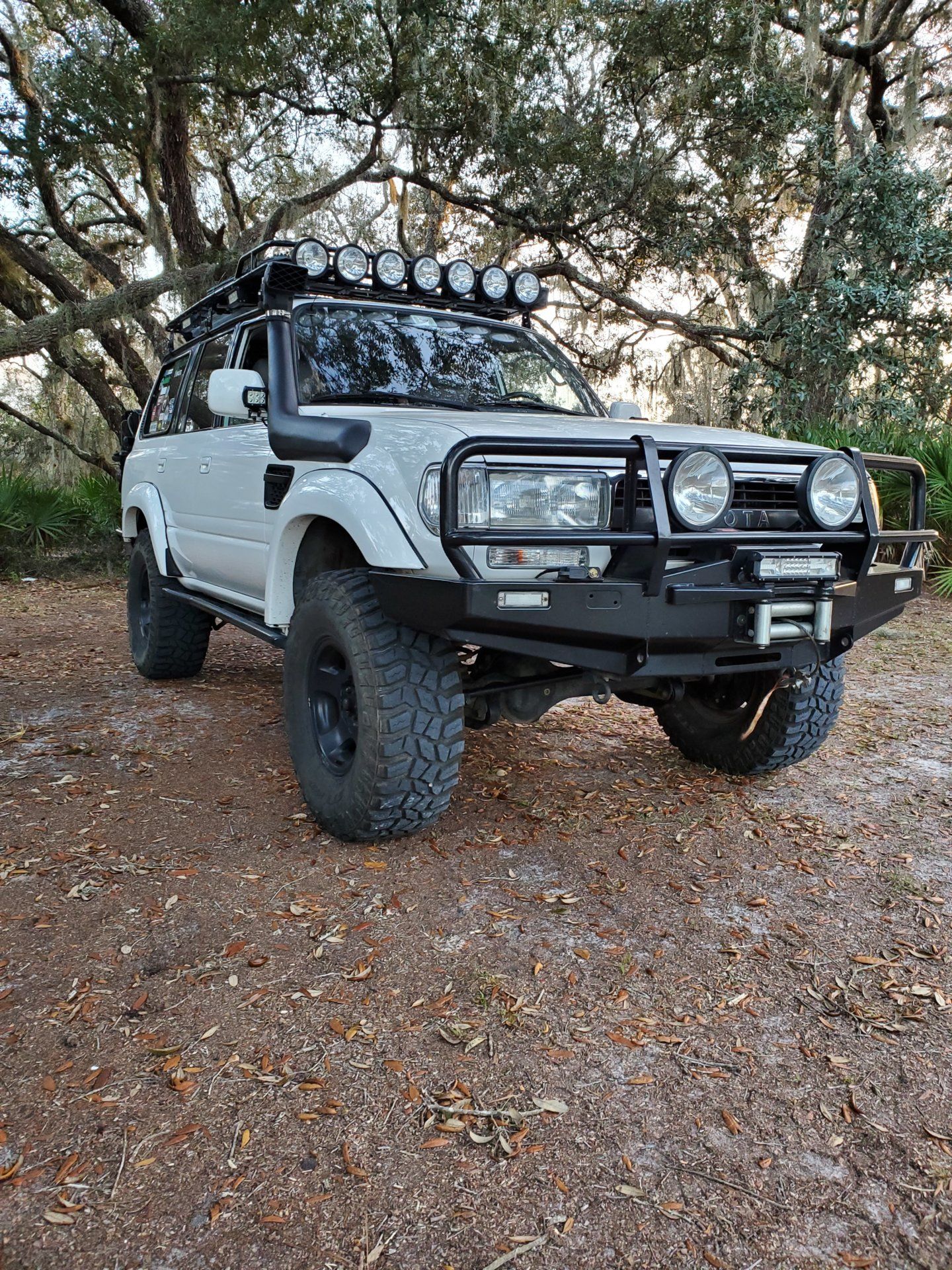

Dobinsons 45mm lift with 33" tires. I gained about an inch over the OME stock height springs but I expect that will settle back down once front and rear bumpers are added.

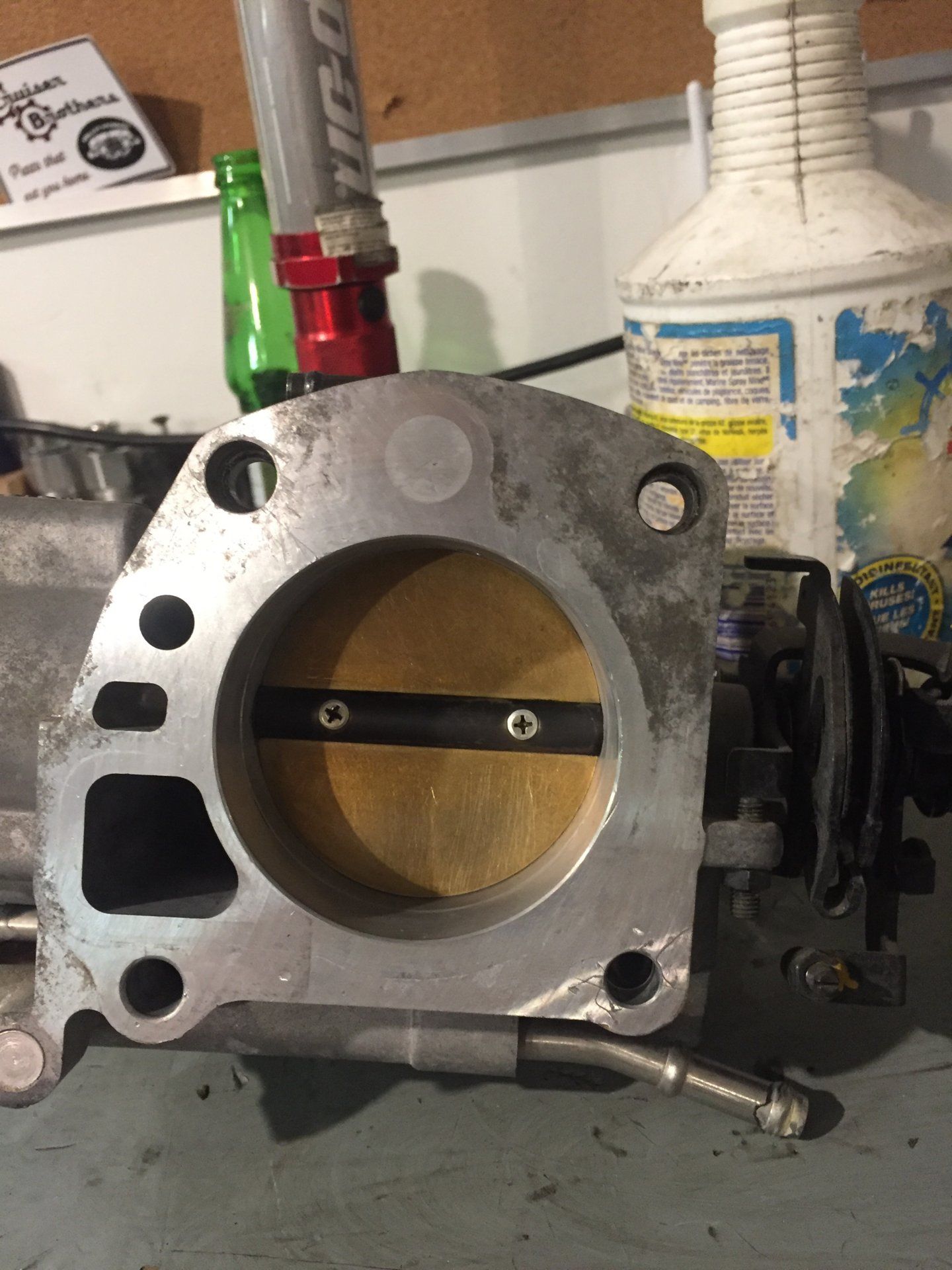

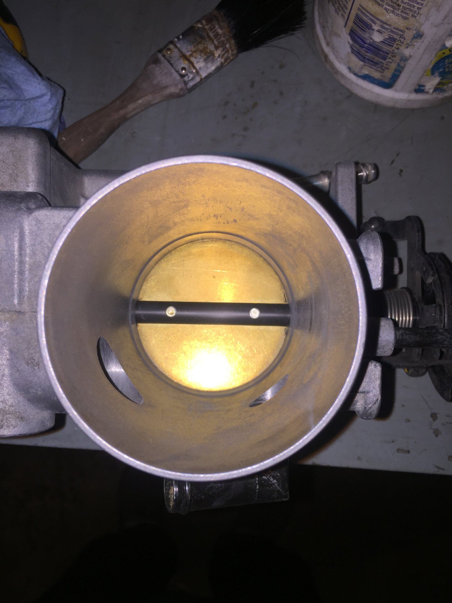

Cleaned throttle body, before the throttle would close with a thud, now it closes with a snappy click. The amount of carbon build up on the plate edge was crazy. Sparkly clean now, well as sparkly as I am willing to go anyways :clap:
