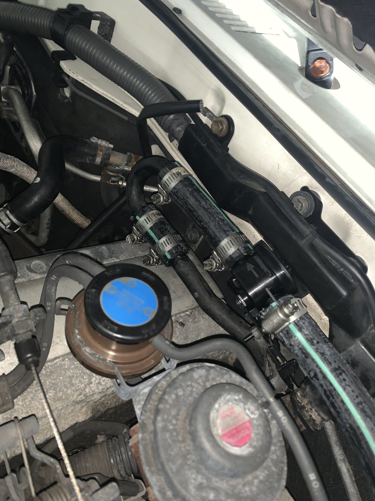

Well, we were packed and ready to go on a one day camping trip and saw that there was coolant leaking.... Guess which hose it was?! Luckily I had bought all the parts to do the PHH a week ago and that I caught the leak before leaving (couldn't find the right clamps, how bad are these really?) So we did the PHH and I replaced the upper and lower radiator hoses along with the heater valve. Having the wife's little hands was a game changer for this tedious job. Then we took off on the trip to crossbar ranch in Oklahoma. No issues and the rig did amazing. This was our first off-road trip and I couldn't have been more impressed. Hoping to get a Slee rear bumper and the torros off-road skylux soon. We also installed the ARB bumper, smittybilt 10k winch and the dobinsons 3 inch lift kit last week.
gotta love that Gates Green stripe. Did you route the PHH from the block nipple to the steel firewall pipe or route around the brake booster.

I ditched the metal pipe and just went all the way up to the water valve. Figured I'd much rather be stuck replacing one hose (carrying 4ft of green stripe with me at all times) than going through that nightmare again with the metal pipe.

yup, I did something similar. I went around the brake booster. I figured if it fails again, I have plenty of slack to pull, cut (damage off) and replace onto nipple. The original design doesnt make any sense to me. the short hose is sandwiched between a rigid nipple and steel tube. Not much hose to expand prior to failure.

That definitely would have been better if I did that 🤦🏼‍♂️ but checking it after this trip all is good with no melting. When I replace it again I'll be doing that.
