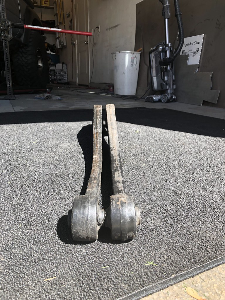

Replaced a bent radius arm, redid the brakes, and modified the front swaybar disconnect brackets as part of the prep for SW-Adventure 2019 and Cruise Moab. Still have a long list to get done this week.

Set of straight arms

Probably was good to replace the arms anyway since the rear bushings were pretty shot. Looks like the eyes/bushings had started to stretch as well.
